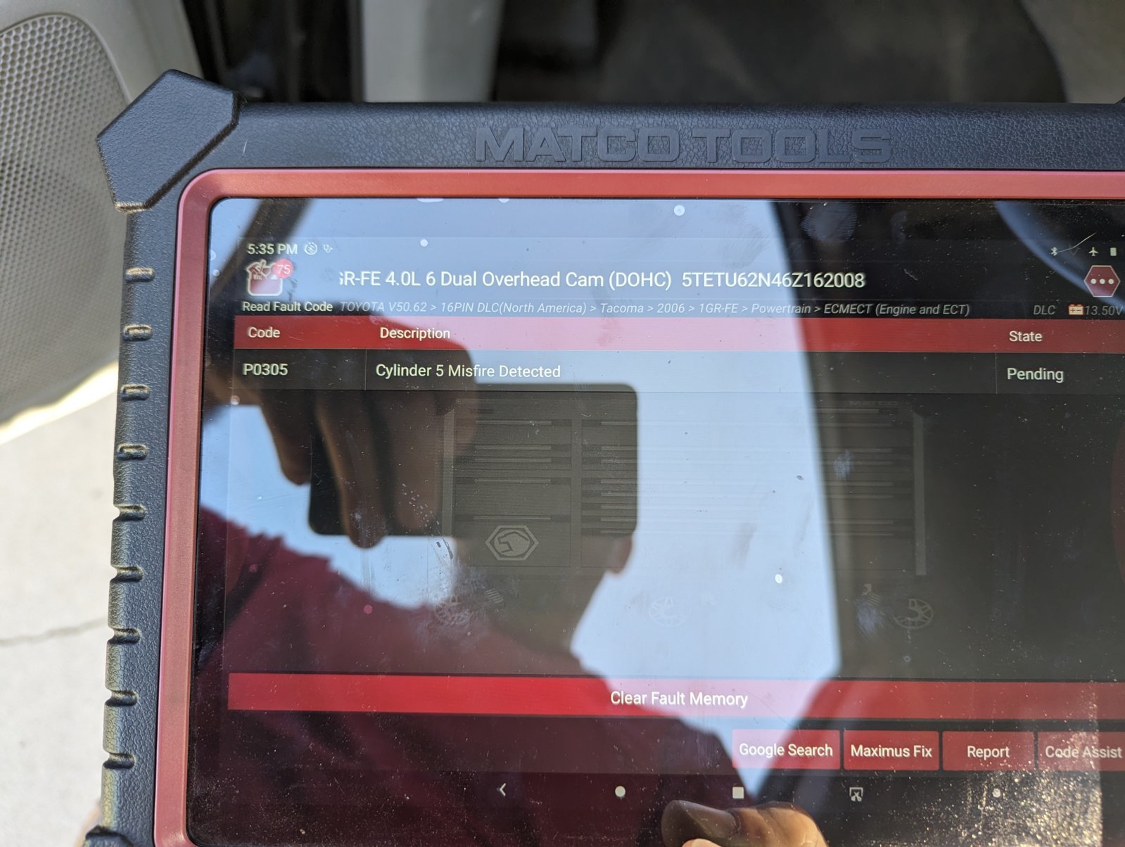

    91 pump from chevron, arco, or shell. It has mostly been arco do to them only charging me 35 cents total to use my card, instead of $2 to fill my tank anywhere else. No additives or octane boosters. I have come across info that the winter fuels will cause the red hue.

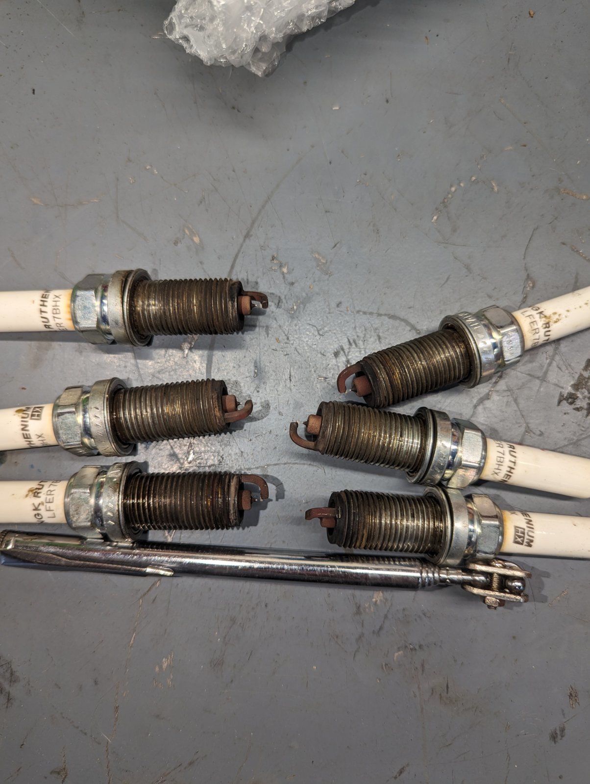

    It's funny, your plugs really don't look bad at all. I thought the Ruthenium were supposed to last longer. This reminds me of a similar problem I had at the beginning of the season, iridium plugs, about ten thousand miles on them. Number 1 would just stop working after it got hot. Pulled the plug and it looked fine, nice and tan and with no visible issues. I replaced it with another iridium and everything was back to normal.

    I’ve had my ruthenium’s in for about 16k miles without issue.

    I mostly replaced them since I was there. But, I had come across info about spark plugs being bad without looking it. I was told check the resistance of the plug. I check one plug and oil got O.L. witch I don't think I should have received tha measurement, but the misfire followed the coil for my issue.

    When I pulled my ruthenium's they looked amazing in terms of wear. I replaced them with the spec'd iridiums because NGK doesn't make rutheniums designed for this setup in proper heat range. While the ones myself and others have used seem to "work" I suspect they are harsher on the coil packs with no evidence to back that up, but I did call NGK and inquire about using them and they seemed a bit mortified that I was using those in the truck lol.

    I've been running Ruthenium's for what seems like years at this point. At least 3-4 swap outs already and all has been good. No problems with coils, poor contact or misfires.
