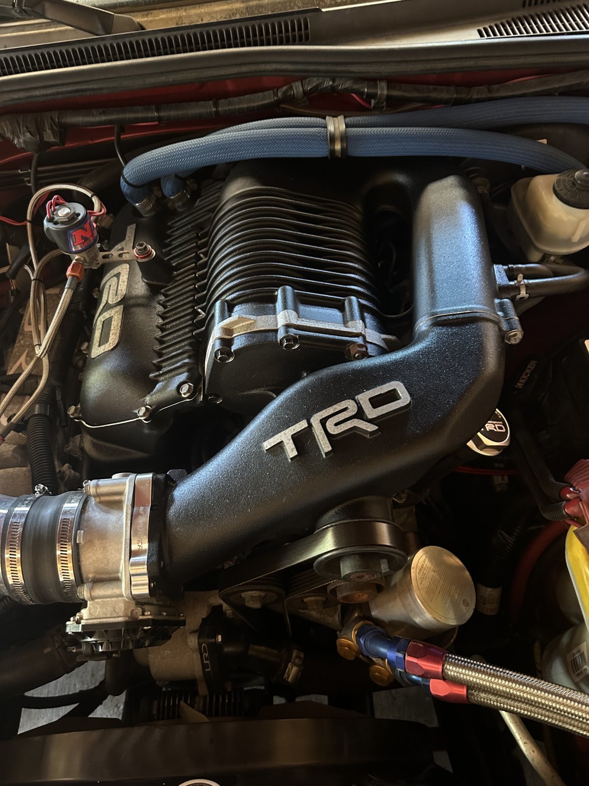

    Selling my trd supercharger if you guys know somebody that wants the “TRD” logo for $5k. It’s still on my truck cause I’m planning to go a different route if it’s sells but if not I guess I’ll just keep it as is.

    FYI - one of us likely won’t buy it for that price unless it’s rebuilt with receipt.

    Also no fit kit no sale. That kit alone is $3500 or so for all the parts. If you have most it will help sale but used S/C need for fit kit don’t sell high. @Murphinator was selling his full TRD kit with new parts for $3500 I think

    Yea I’m really happy with my setup but I sourced out shops to put a tvs1900 supercharger on our motors but I won’t do it unless I can sell my set up since it’ll require some custom parts to make it work.
