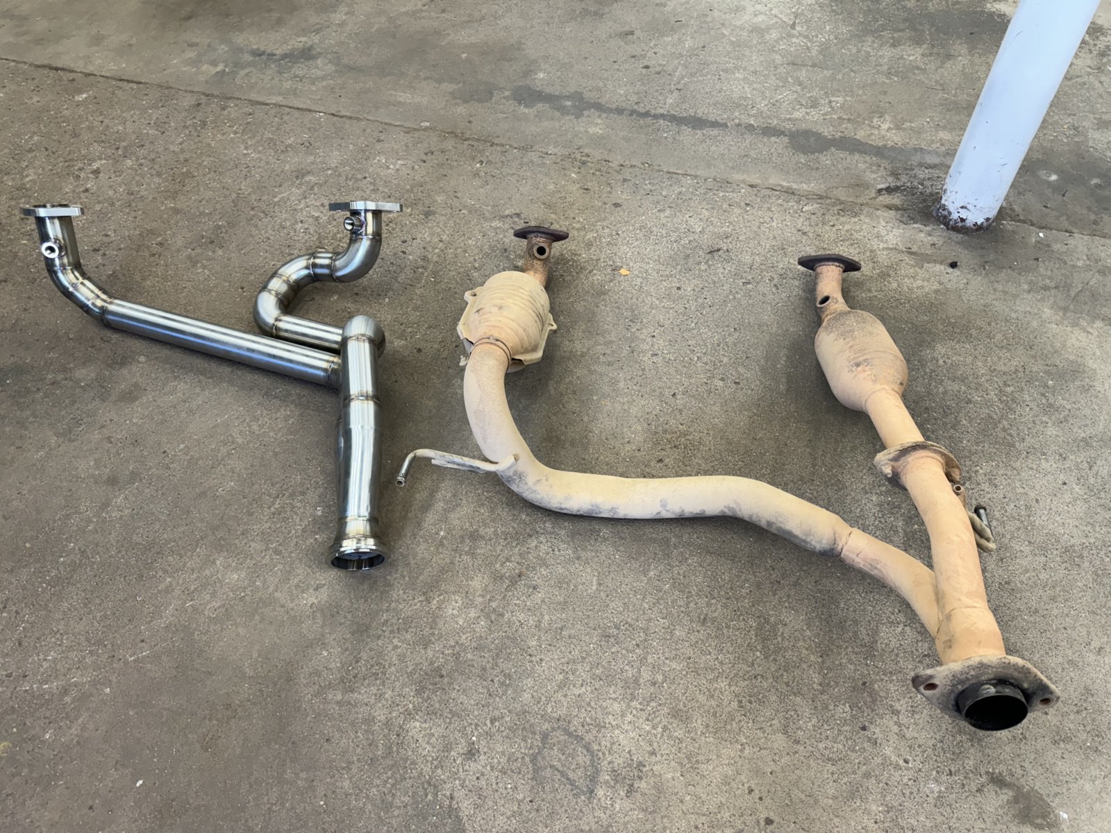

    Hey guys. So I own “sub-zero fabrication”. Recently I took the dive into a custom exhaust build for my not currently supercharged truck. But the system was built and designed around the future prospect of boost.
    This is an equal length Y pipe dumping into a straight through 3” system with resonator/muffler.
    I am entertaining the idea of producing these Y pipes for 2nd and 3rd gen trucks.
    All materials are the most top shelf 304 stainless money can buy with no cut corners. Fully TIG welded AND back purged.
    I have a sound clip up on my @906taco instagram if you would like to hear it. It’s epic.

    Looks awesome! Pretty sure the y-pipe on 3rd gens is different. They also have those weird heads with exhaust manifolds built in so they can’t get the same truly equal length exhaust like 2nd gens

    We will see about that! Going to get my hands on a 3rd as soon as a jig is built for 2nd gen’s!

    The EL ypipe looks great! Hope you make them available for those that didn't get in on the Roostfactor ones.

    That looks killer!
    Personally I would also offer a dual exhaust style setup for these trucks. Boosted trucks have A LOT to gain from not having to cram all that exit airflow into one single entrance like the stock style Y and it also should drop your boost pressure down by .5 to 1 psi, allowing you to run an even smaller pulley than what you currently run.
    All that, plus the trucks sound absolutely killer despite being V6's once you truly dual them out all the way through.
