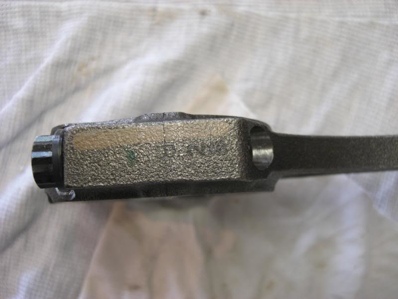

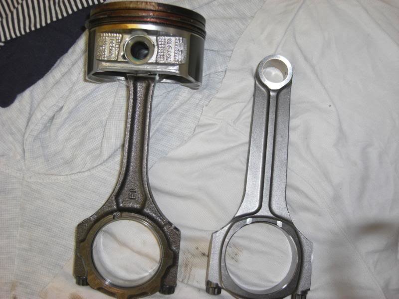

    Quote from page 2,
    "Side by side comparison.
    If you look carefully enough, you can make out the #2. That designates which bearings are for the stock rods. There can be four different rods in one motor. Strange to me.
    Stock rods are a powder cast metal. Pauter Rods are billet steel.
    Best place to get rods and pistons for these motors now, Hands Down, is LC Engineering.
    www.LCEperformance.com John there, is the man!" End quote.

    4 different rods in one motor?? And I thought 2 different kinds of plugs was weird.

    Yes.

    Not different as in design. Different as in tolerances.
