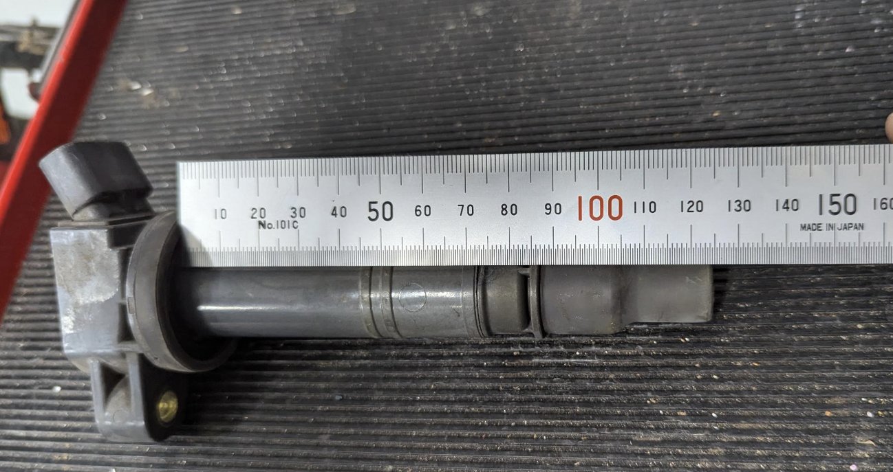

    PhoS
    PhoS Proffauxssional
    Apr 8, 2020
    #324146
    1,322
    PNW
    08 FJ Cruiser
    Contains MSG
    125mm
    Jowett[QUOTED] likes this.
  5. Jul 15, 2024 at 11:16 AM
    Jowett
    Jowett Well-Known Member
    May 5, 2016
    #186182
    1,636
    Brian
    North Adams, MA
    Thank you. I thought they looked shorter… sure enough.

  6. Jul 15, 2024 at 12:43 PM
    PhoS
    Apr 8, 2020
    #324146
    1,322
    PNW
    08 FJ Cruiser
    Contains MSG
    I could design a 3d printed spacer to make up that difference pretty easily.
