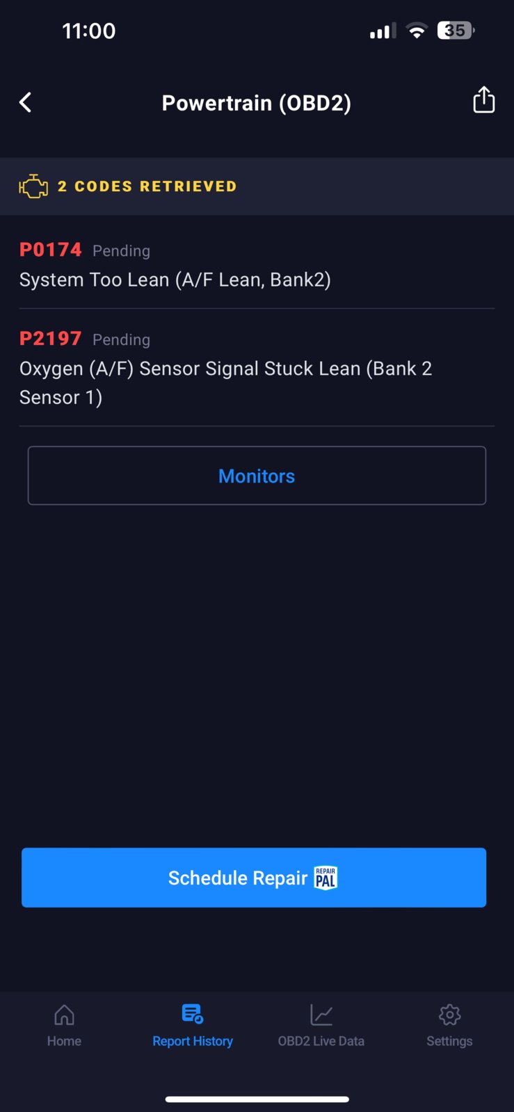

    Have you checked for exhaust leaks?

    I'm guessing Doug Thorley Long Tube headers and not the short tubes, right?
    I'm also guessing the TRD tune (ecu) is what is not playing nice with the O2 sims and mods.

    What sensors are you using in the upstream location, is it in the header tube for one cylinder or did you move it to the collector, and what are you using in the downstream location, where the O2 sims (not O2 eliminator??) are? And what sensor are you using for the aftermarket gauge, and where is that sensor located?

    the o2 sensors are in the upper location on the headers . The aem sensor is below this . The upper location on the DT headers collects for all cylinders .
    The down stream o2s have the simulators
    I bought my densos from RockAuto. I’ve had bad luck with Amazon stuff .
    as far as the after market gauge it’s a AEM UEGO. It’s accurate as I tested it in my other cars .

    yes and the vehicles has all new gaskets at the headers down from when I installed them
    I’m wondering if that’s the case and where I should go from here . Truck ran great before the mods . I’m guessing the ecu is just going crazy and dumping fuel?
    I swapped sensors with my other car with the same gauge and same results unfortunately. I’ve been chasing this for months
    the truck feels down on power compared to when it just had the TRD bolt on kit with no headers and a 3.0 pulley. Here’s a video of it before I did everything

    I wonder at this point if I need a custom tune or something because the ecu can’t handle the extra boost and headers . Half tempted to buy another 3.0 pulley and see how it performs since i modified to the quick change pulley
