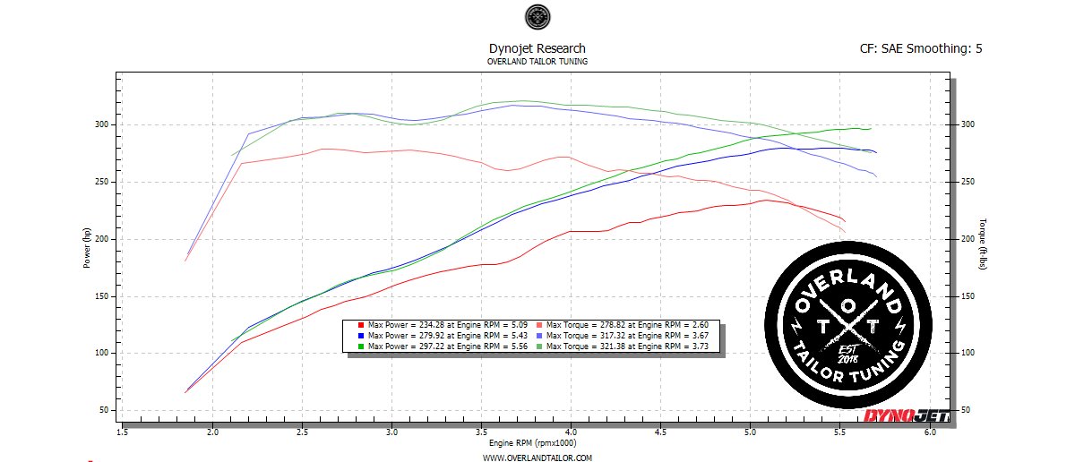

    For the general 1GR w/ the Maggy I target mixtures in the 11.3-11.0 range. These engines do prefer to run a little richer than traditional engines, but I think the TRD Engineers factored in enough safety for those hammering the snot out of these things on regular fuel despite being advertised for 91 or greater. They leave a bit of power on the table due to the ultra-conservative tuning.
    *RED/BLUE: Stock TRD Tune vs Custom Tune (both with very dirty/clogged K&N drop in filter)
    GREEN - Tuned w/ out the dirty filter*
    PhoS likes this.
