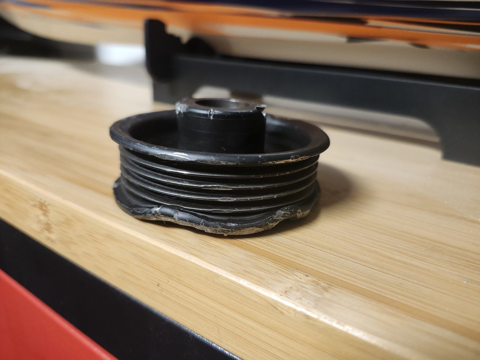

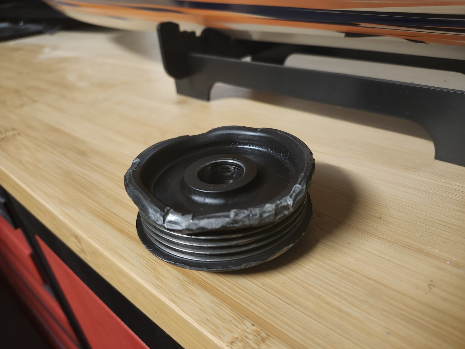

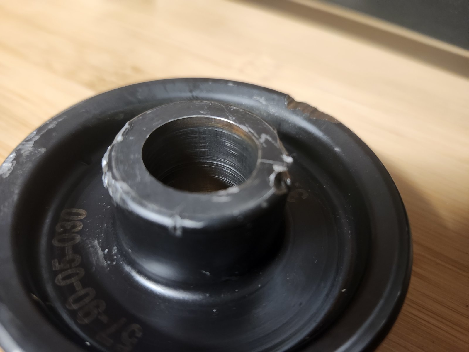

    This right here is precisely why I do not recommend the URD stealth pulleys to anyone and explicitly left it out of page 1 of the mods when I was building the Uber long bible (which I'm aware needs updating, my apologies on the lag in that men). I dealt with the exact same issue you and many others before and after us have and will. This is why I recommend only qwikchange pulleys at this point. 2 piece assembly. Relatively painless to press on. Money.
    IvanhoeTaco[QUOTED] and Norton like this.

    Was there any downside to PulleyBoys other than the gaudy etching of their logo?

    Not that I recall, but this is one of the reasons Smoothflow is the best option.

    Sorry, I meant PULLEYBROS PULLEYBROS PULLEYBROS. o_O

    Smoothflow is the best option for a qwikchange hub for these blowers. The fitment only requires you press the pulley flush to the shaft unlike Pulleyboys whose pulley hub requires you go past the shaft face in order for it to line up properly to the rest of the drive pulleys. I believe it was a QC problem at the time, but I don't know if they ever rectified the issue.

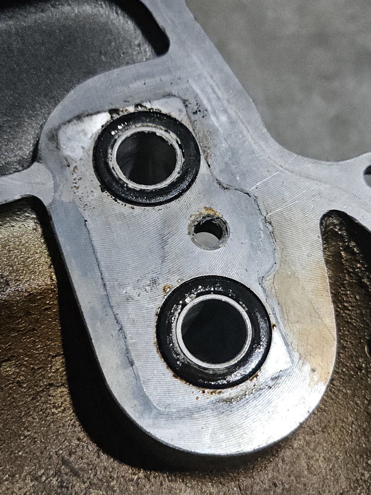

    Caught a really odd oil change that was jelly and sludge. Had me stumped for a few days. Went and checked fluids and found sc reservoir oddly low... seems the previous owner failed to have the lid to ic o rings serviced. Now I know where those two from the rebuild kit go. Thankfully the truck isn't fairly driven and started up everyday and moved around. This could've been catastrophic in most cases. Definitely a pita to get a perfect bead and line up the ic slot with the housing tabs.

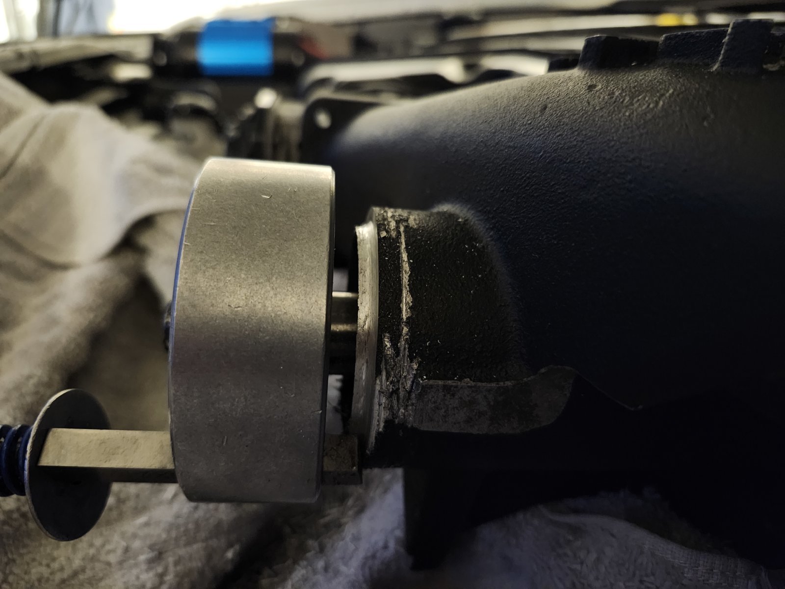

    My thoughts exactly. I'm trying to remember how it's assembled to wrap my brain around which way the shaft would move.

    Correction on my post, you would press the pulley side bearing on the shaft with something to support the coupler plate.
    A compression spring drops in the coupler side, then the shaft/coupler plate. The pulley side bearing presses onto the shaft afterwards.

    Damnit now I'm worried. I've got a spare nose drive rebuild kit.

    Yes, seeing all these horror stories about this pulley caused me to promptly return it and go with smoothflow.
