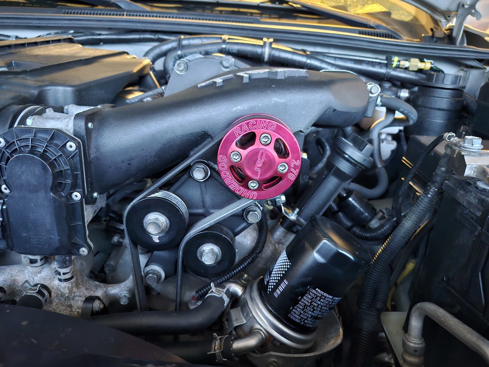

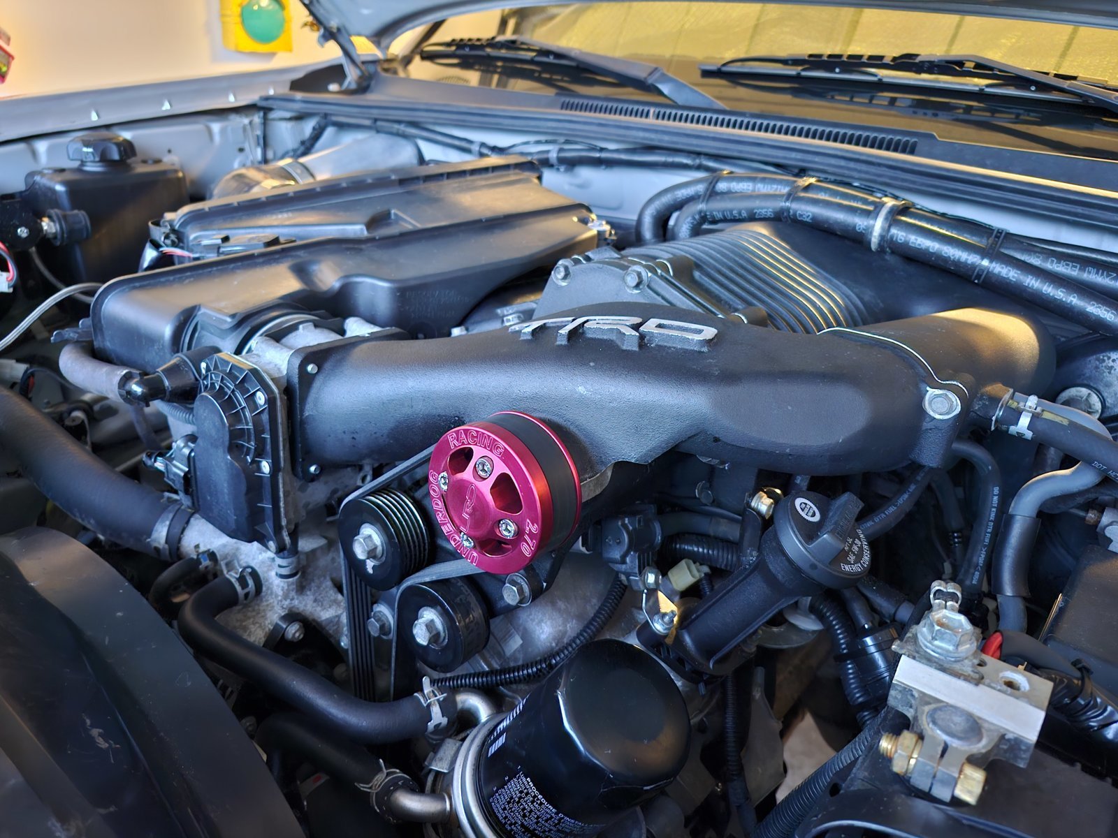

    Cut snout in under an hr, went well.
    Quick change hub pressed on suspiciously easy compared to to the hours I've spent pressing on the stealth pulley.
    Spun the new 2.7 pulley by hand and it has a small noticeable wobble, cranked it up and can't see any wobble at all. Oh well.
    Running stock 3.0 belt LOL
    Picked up 1-2 psi over the 2.85 pulley.
    6-8 psi at 10.9-11.0 WOT

    Smelled some burnt rubber this morning on my spirited drive to work. I got a 7pk 1781 here.
    Is that a better size for a 2.7 pulley?

    Can confirm. 7pk1781 fits much better with 2.7 pulley than 1790. Not crazy about taking a razor blade to a 35$ belt but yolo. I'll keep the oe belt in my truck is case something happens.
    Was able to easily slide it on and sill have some swing in the tensioner. No more burning smell.
