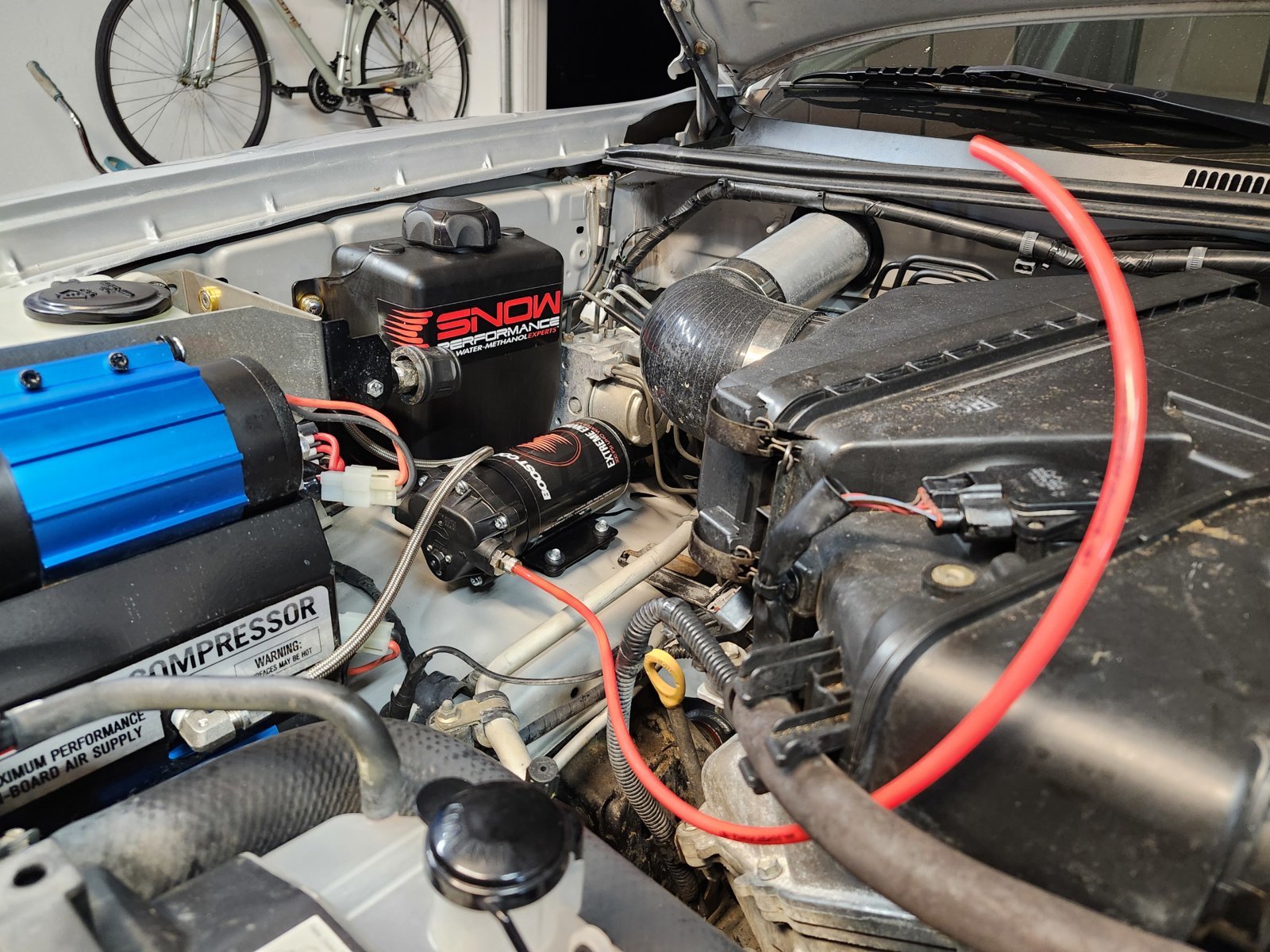

    Mounted sno kit thanks @jamesepoop
    Cut about 1/2 off reservoir threads to get cap to sit lower to clear hood
    Going to put a nozzle in this bottle neck intake and see what happens

    Very nice! Post impressions and any particular quirks. I was thinking of doing the same down the line, maybe an AEM kit.
    IvanhoeTaco[QUOTED] likes this.

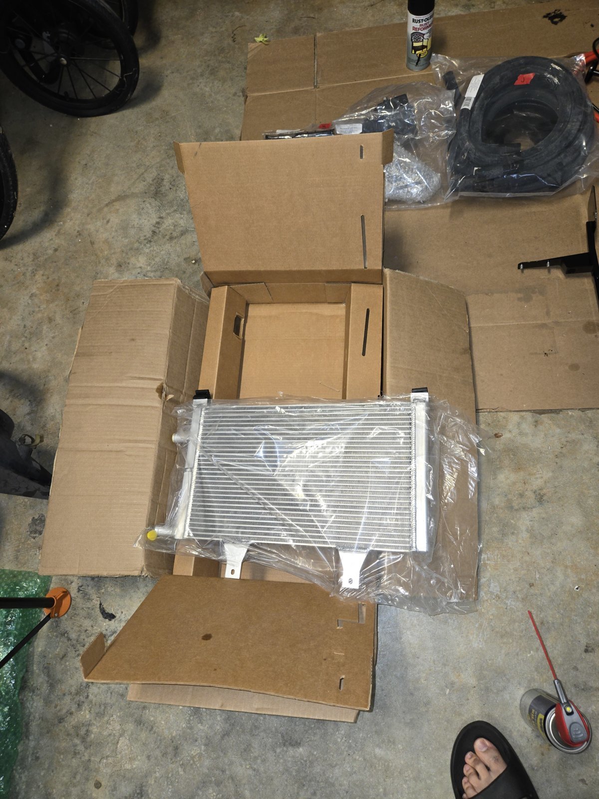

    Has anyone figured out what the orange foam gasket wrapped around the intercooler is made of? I know it is silicone, but is there anything special about it and the adhesive?
    Or a better source price/shipping wise than URD or SCOL? It's almost $50 w/shipping.

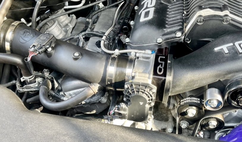

    76mm throttle body upgrade, just checking part numbers before I pull the trigger. Can anyone who has this confirm 22030-0S010 ?
    I plan on using the URD adapter and I’m guessing a 3” to 3.5” silicone tube to go from my AFE intake to the bigger throttle body.
    I’ve also URD’s 7th injector. I’m hoping that won’t be an issue when fitting things together.
    I did search old threads before posting this but wanted to be sure. Thanks for any advice.
    Here’s a pic of what I’ve got now:
    Ps, should I go with a factory throttle body gasket? I remember in one of the threads I read that someone was recommending that.
