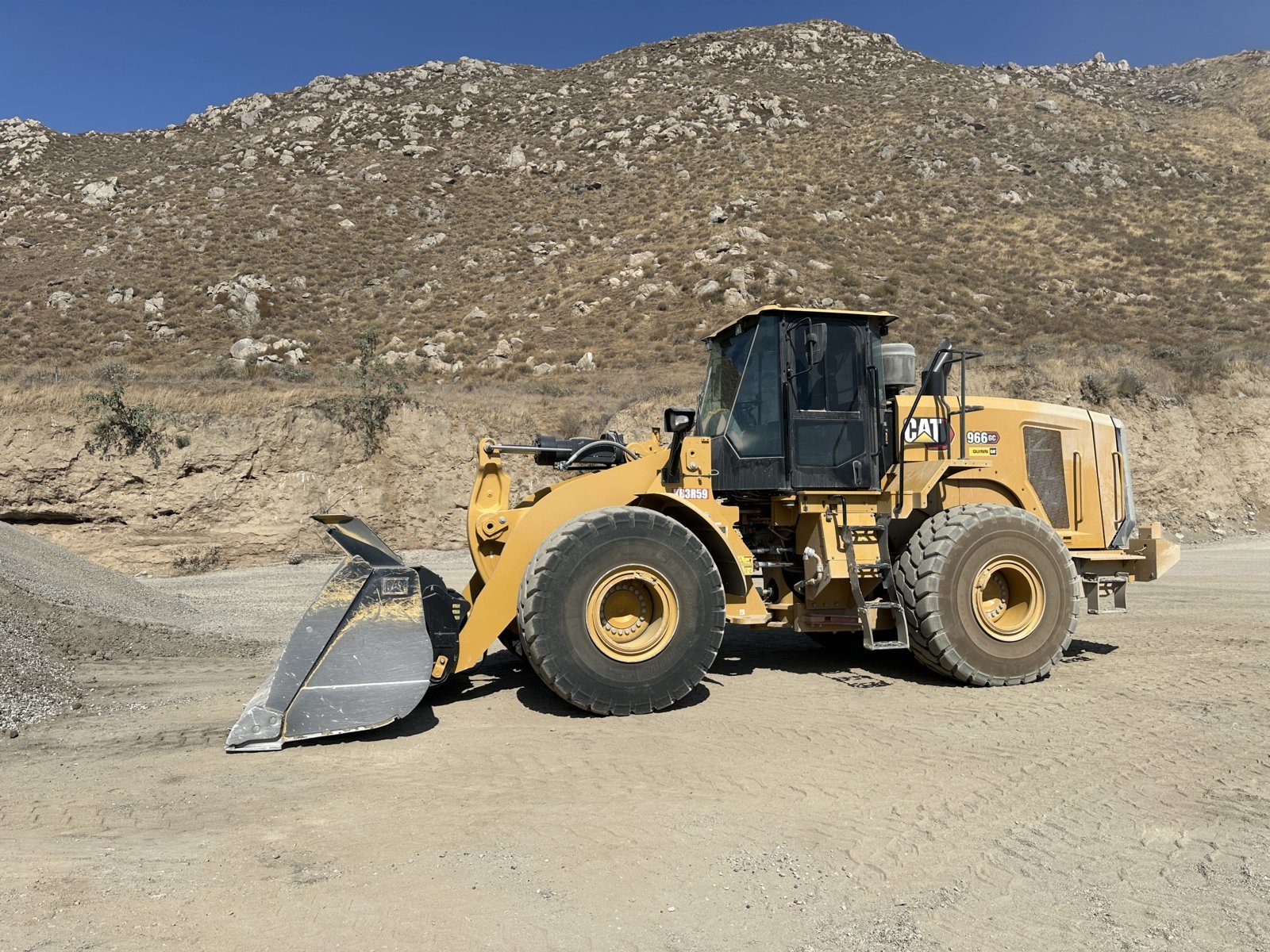

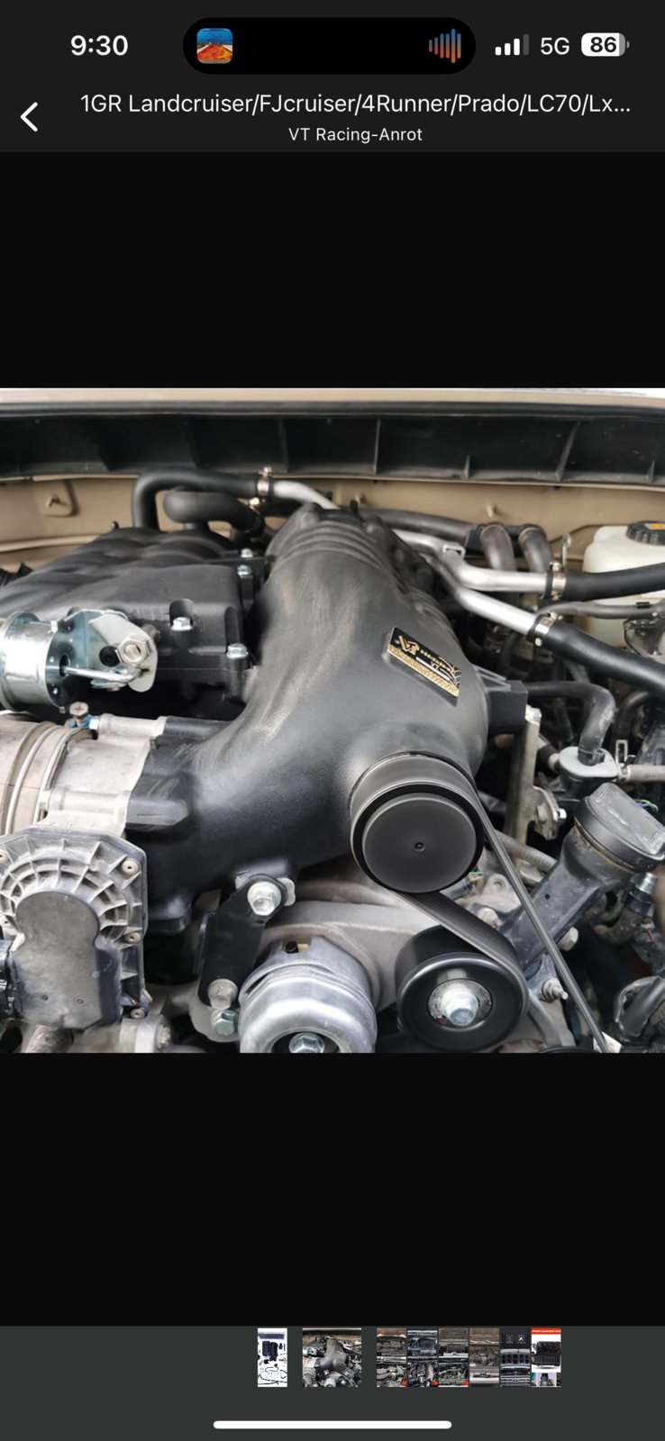

    That website Justin posted seems to have a cheaper price. Dunno if its legit but I did talk to the VT people on whatsapp. Here is more pics and you can see it’s very similar to magnuson but different mounting of the rotor pack in the rear. 2e9f2397-cc33-4f72-a545-4da2da310730.jpg 611b0e98-c64d-43a1-9441-419b356137c7.jpg IMG_1116.png
    Also just because it’s made in china doesn’t mean it’s garbage. There is a chance though lol. I mean if they are using good rotors and bearings it should be fine. Heck this thing right here was made in China..
    Aside from a few things being backwards from our other loaders this one is much better than the last one we had made in Brazil but we will see, it hasn’t even had it’s first service yet. It’s only burned 3.5 gallons of oil in 500 hours :oops:

    I do like the design of the idler/tensioner bracket. Looks like a wrap mod built in somewhat and also just looks more rigid.

    AS FOR THE SUPERCHARGER FROM CHINA, TWO THINGS, I LIKE THE WAY IT LOOKS MOUNTED UP ON THERE. IT LOOKS STOUT AND PRETTY WELL BUILT. THE INTEGRATED WRAP MOD ON IT BY DEFAULT IS SWEET, AND.... AND, AND, AND ITS GOT A SWEET ALL ALUMINUM THERMOSTAT REPLACEMENT ON IT THAT HELPS ROUTE THE HOUSING OUT OF THE WAY OF THE BELT WHICH LOOKS SIMILAR TO WHAT I WAS TRYING TO OBTAIN FOR OURS A FEW YEARS AGO BUT WAS HAVING A HARD TIME FINDING. THIS WILL AVOID BUSTED HOUSING DUE TO THE BELT SNAPPING, IMPROPER MOUNTING, ETC.
    ALSO LOOK AT THOSE SWEET ALL ALUMINUM COOLING CROSSOVER LINES THAT SITS ON TOP OF THE BLOWER UNLIKE OURS WHERE ITS JUST THE RUBBER HOSE WHERE IT CAN CHAFF ALL OVER THE PLACE.
