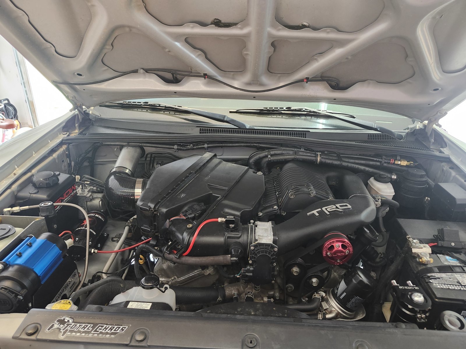

    Sno kit installed yesterday, made some boost juice and took it for a ride. Set at 3psi first and was a little boggy with #4 nozzle but could feel some extra pull for sure. Set to 4psi and is more predictable now. 88° 100% humidity and saw 7 psi which I don't see often at all. Blower is barely warm compared to last night when I parked the truck in garage and garage became 100° just because the truck was in it. I could literally touch the cats and the blower was still scalding
    On way back could only hit 6psi and could feel some surging at high rpm/higher speed. Possible belt slip?
    I hate chasing more power honestly. Every step up has its own set of challenges that are so infuriating you question every decision you've ever made.
    And the problems are always un-duplicatable sitting still and requires literally just throwing stuff at it to see what sticks.
    I'm sure this isn't new to anyone on this forum but I'm just venting. I'm happy with the truck but I should've bought a dedicated car if I wanted power/speed

    The gaskets and rubber washers would not last long with a high methanol content I would imagine. You would still have to plumb and wire pumps up. The only saving would be not having to mount an external resevoir

    Came out great! That's what I was imagining when you said stock airbox. I might have to rethink my own setup. Was going to do an aftermarket intake but the stock box looks good there. If that tank ends up being too small, I have the larger upgraded tank if you need but I think you're limited by space. I'll probably end up with a 1+ gallon tank in-cabin to relieve some space in the bay. I have my s/c coolant where your tank is placed

    Yessir, with the slee bracket fits nicely but ruins any hope for an aftermarket intake

    I had to get rubber intake adapter and that placement is literally the only place you can put it. Probably not 100% efficient but it works for what it is.

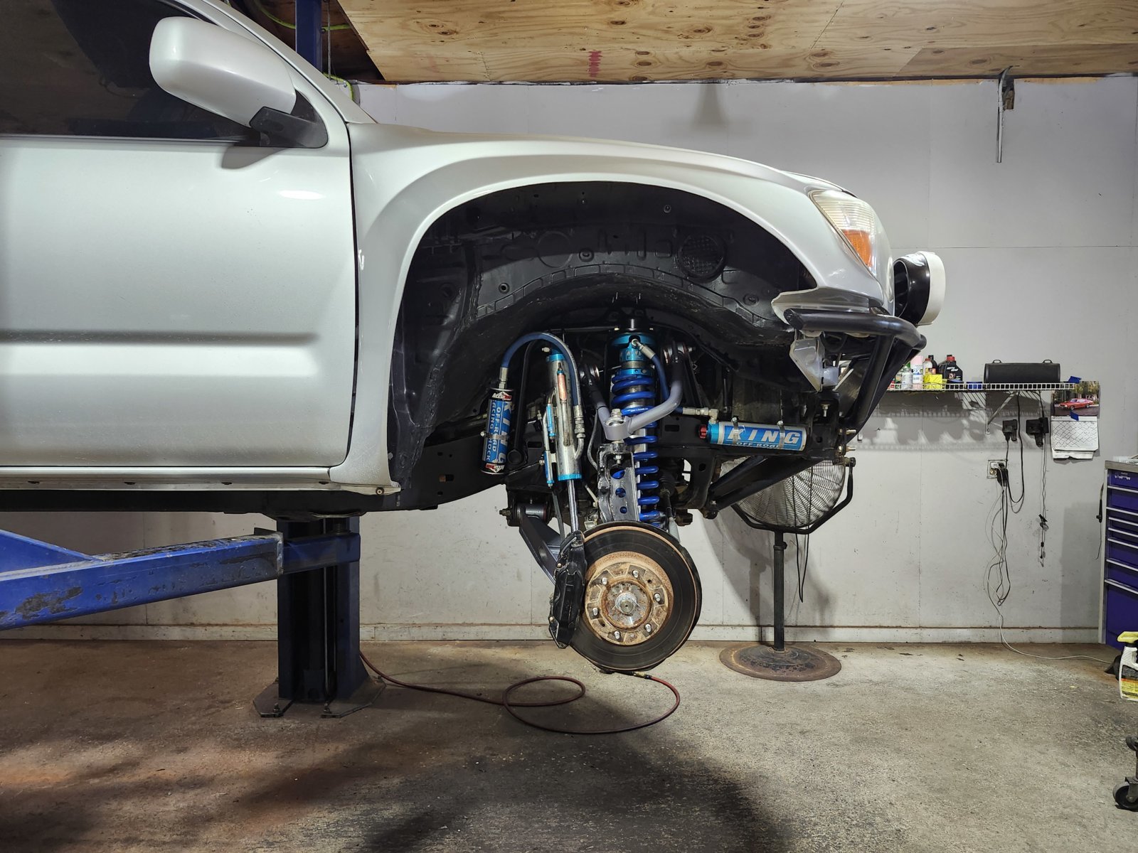

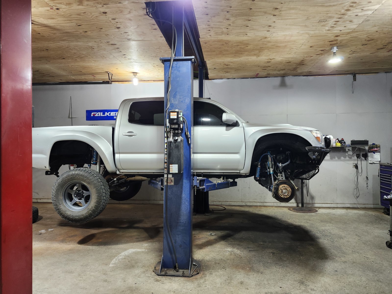

    Also finished up my front suspension with a double shear and some bypasses. So basically I'm trying to master suspension and performance at the same time. Neither of which gets better the more money you throw at it without lots of testing and tuning lol
  15. Aug 9, 2024 at 7:03 PM
    snowsk8air2
    snowsk8air2 how hard can it be?
    Sep 16, 2011
    #63607
    10,542
    Flagstaff, AZ
    Supercharged TX Pro
    2011 S/C and basic mods
    I’m 5+yrs into tuning my suspension in. It’s a dark art and takes time and testing to get to where you’re happy. Just keep trying things and tweaking it until it’s performing how you want

    Well your hard work shows. You the most famous orange tacoma on in the internet lol. I like the challenge, got to cut my teeth on valving with lightening up the coilovers for the bypasses, I'm still on stage one, bypasses fully open to get a baseline and start turning the screws from there
