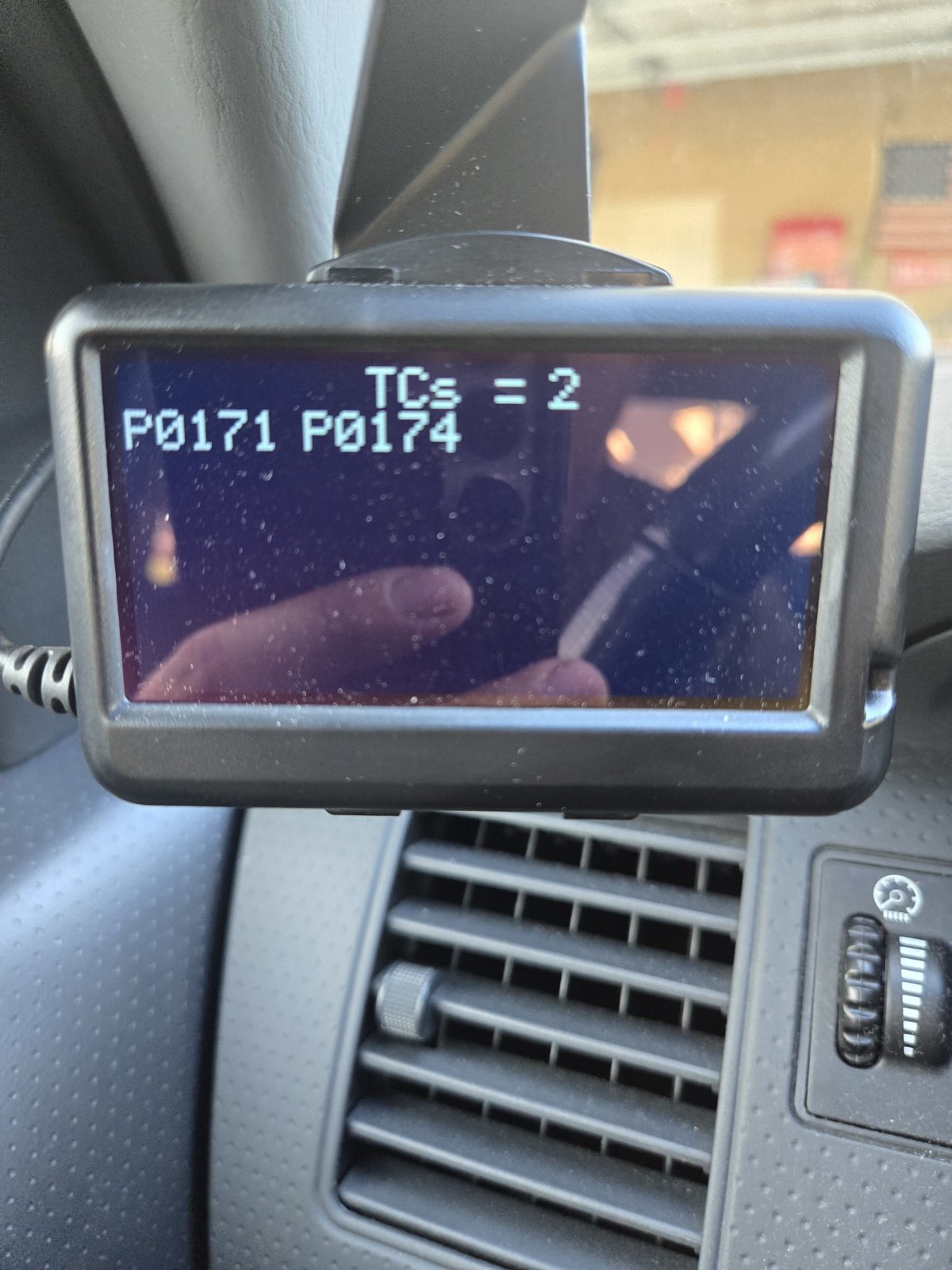

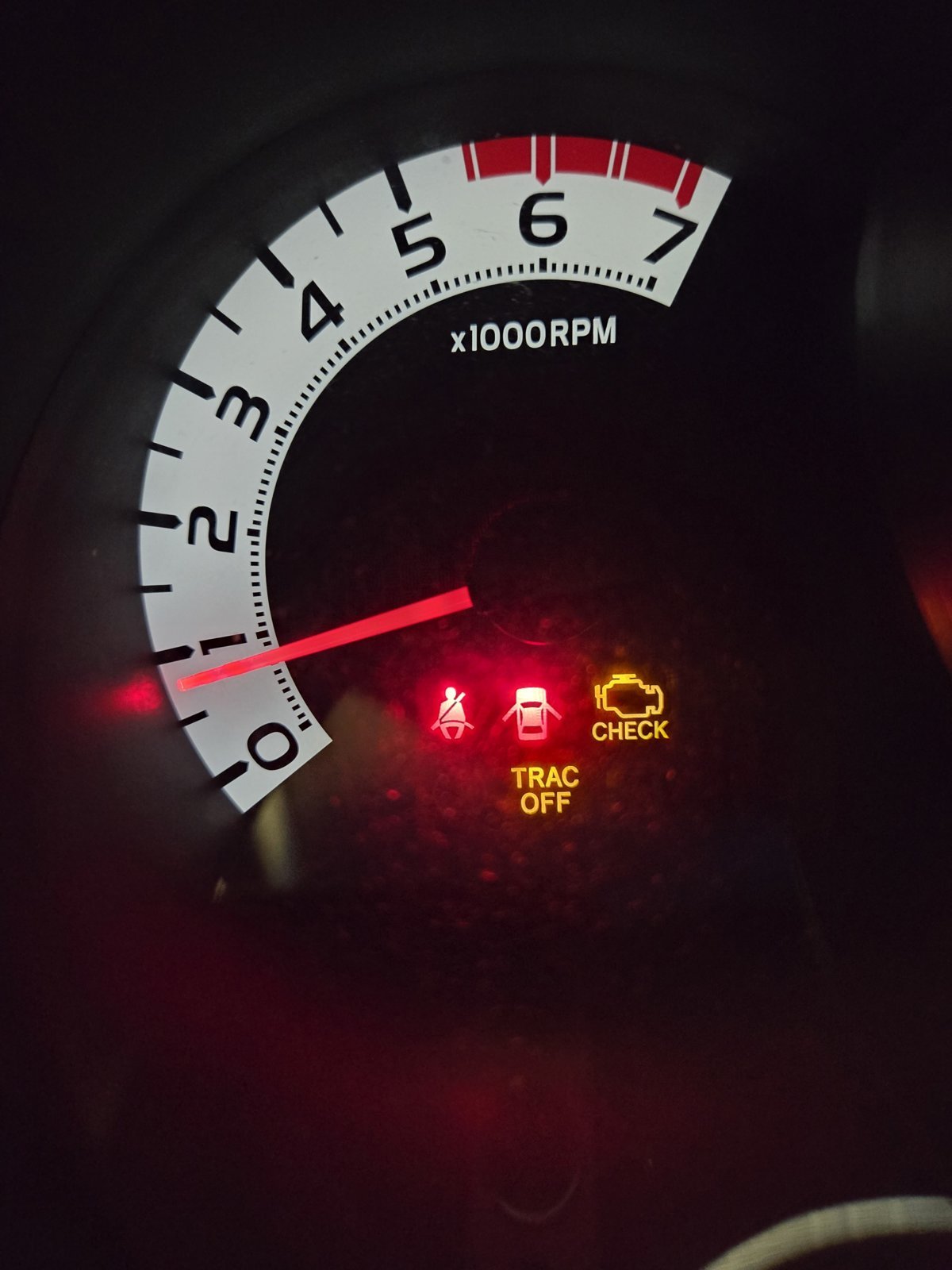

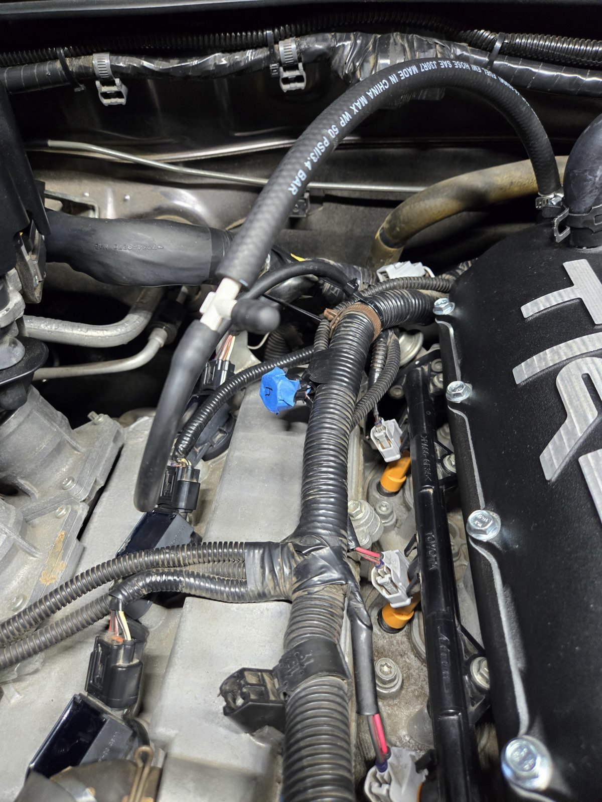

    Finally got to turn the truck over and get it on the road. Good news, sounds awesome and feels great. Bad news, got the dreaded bank 1 and 2 lean codes. Now I'm chasing down a vacuum leak somewhere. Long term fuel trims are reading nearly 40 on both banks. Cleaned MAF, checked around AFE Intake, checked vacuum lines. All seems OK so far. Really don't want to pull off charger to check the intake manifold gasket but it's brand new so I don't see that being an issue. Any suggestions?

    If it's the Momentum GT part of that is the MAF housing size. It's larger than stock and will require scaling. But I've never seen it 40% out.

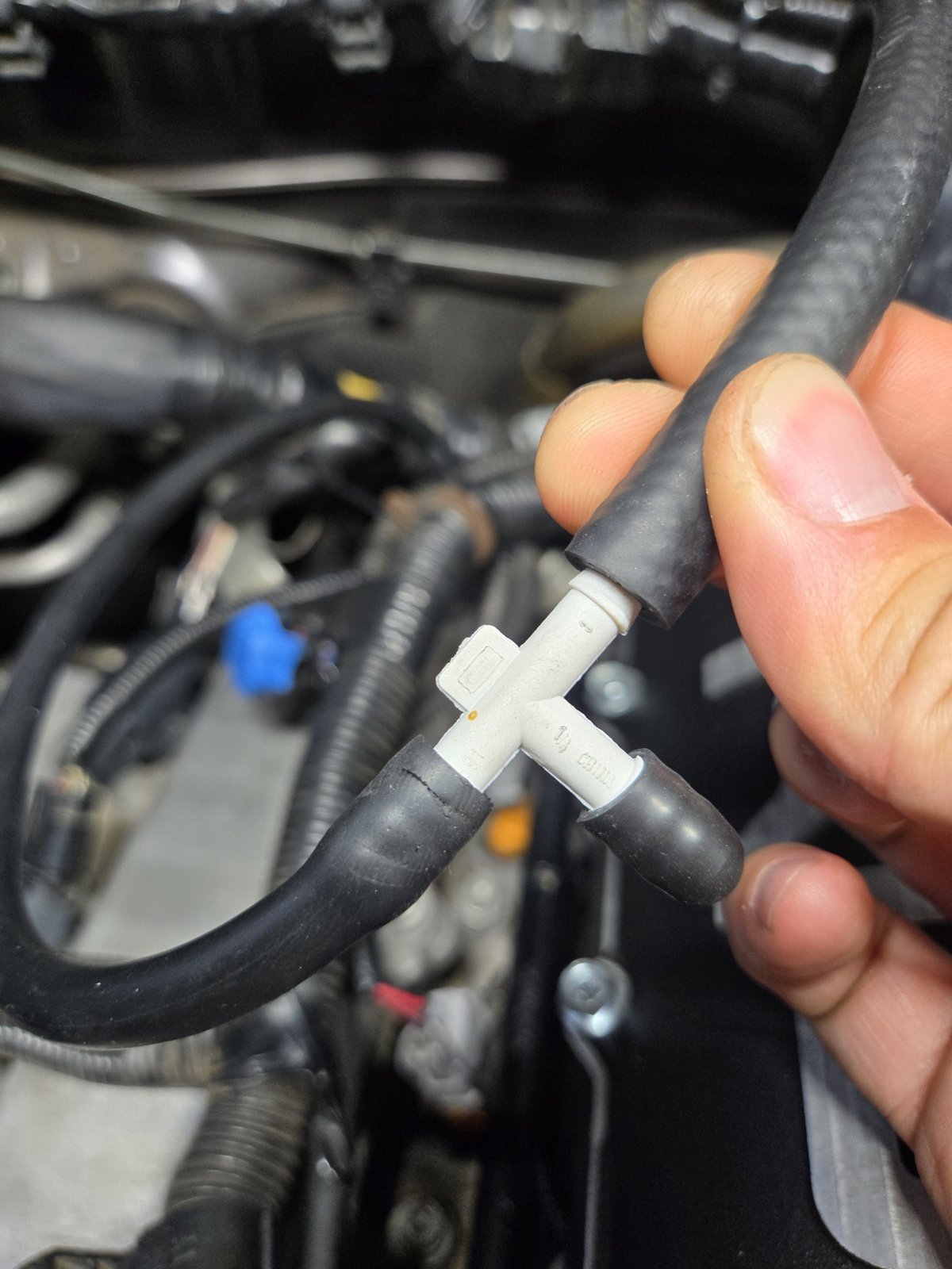

    It's the Magnum Stage 2. I may pull the MAF again just to double check. I'm not sure if this would have to do anything with it but I am running it boost referenced but everything at thw T seems solid. Same at the fuel pressure regulator. Everything is capped off until I install my gauges.

    Yes, boost referencing the FPR will throw the fuel trims off a decent amount (in the positive direction) as it lowers fuel pressure when the manifold is under vacuum when the stock/TRD calibrated ECU's calculation assume it's fixed at ~43.5psig.

    Ok. I'll switch it back over and see how it does, thanks!
