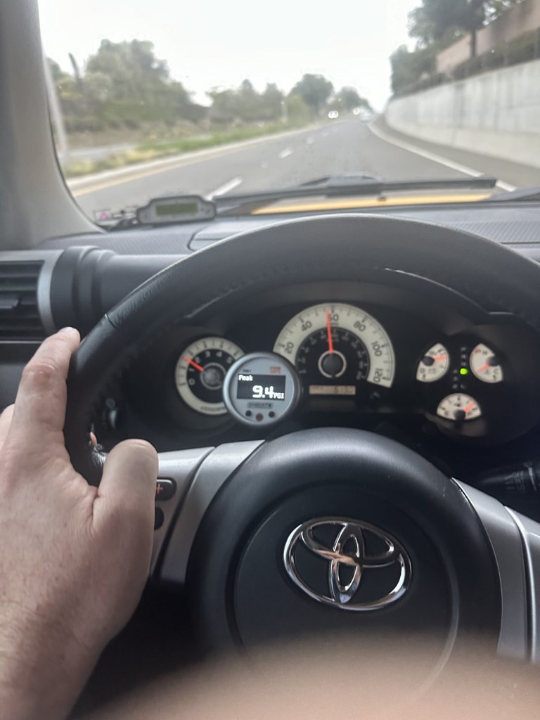

    I got same setup with you minus the water meth, how come you can reach to 9.4psi of boost with under 2k rpm while mine run almost 4.5k rpm only reach close to 5psi.
    Is it the water meth really help to max out the boost?
    What tune do you use?

    Zooming in on the gauge I see “PEAK”, so that looks like the max boost reached, not at 2k

    Same but different. Many other variables.
    Altitude, ambient temp, quality of gas, diameter of exhaust piping, etc

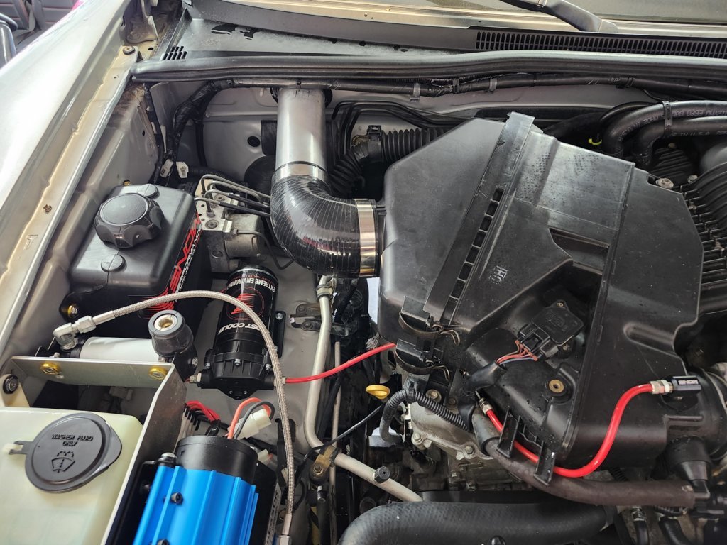

    Water meth will help tremendously. I cannot recommend it enough. Noticeably stronger pull when it's spraying as well as lowered the afrs. I used to be able to do a few good pulls and power would fall off with heatsoak. Now it's strong all the time. Plus, a gallon of water meth is about 7$ when mixed. Kit is universal so can be mounted literally anywhere.
    The only thing extra I had to order was the sno rubber I take tube adapter. I have the 2.5 kit courtesy of @jamesepoop 20240808_143120.jpg

    That wasn’t at 2k rpms. It was the peak boost that is stored on the Innovate gauge. I normally peak high 7s, so not sure if it was a fluke or if the water meth is somehow raising boost.

    Any suggestions on brand for this kit?
    Btw this meth and water kit is it legal on state inspection? Bc I just put it back my catalyt converter and don't want to get problem with state inspection.
    Btw thanks for the picture!

    The kit is SNO performance. Get the 2.5 kit.
