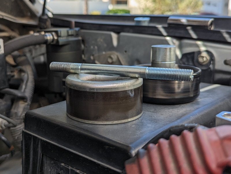

    I went the opposite. Replaced the S/C crank and water pump with the NST. Stock belt with Roush tensioner. Will be throwing on the Detsom studs on the next version here. But I have some more miles on mine. If your eyeball check looks good, I wouldn't worry about running them 100k.
    At 20k miles the nut-bolt check seems key. I'm at 40k in the s/c. I just want to keep this thing running reliably as well. Loctite anything that vibrated loose and send it.
    Checked mine at 20k as well but looked mint to me.

    I'd swap the studs. They break. No one knows why exactly, and no one knows when. Better than having to drill and easy out a broken stud later on.
    Also, while you're rooting around in there, check the coolant hose between the SC and the firewall if you haven't already. The hose clamp if positioned wrong can rub a hole in the SC body.

    That was my 1/2 brain to change them. I bought the SC used and don’t know how many miles are on the studs. I’d guess 120k + maybe, as I had to rebuild the supercharger when I bought it. Then put 20k mi on.
    I’d much rather extract the regular studs however. I know both have broken. I think loose studs may be the ultimate culprit.
    I picked up the NST pulleys for a good price, other wise $250 for the set and another $250 for the single SC crank doesn’t seem worth while to me. But maybe I’ll be pleasantly surprised !

    I forgot that you had to rebuild yours. Yes it's a good idea then. Leave old studs for spares in the box. Replace it! Replace it all!
