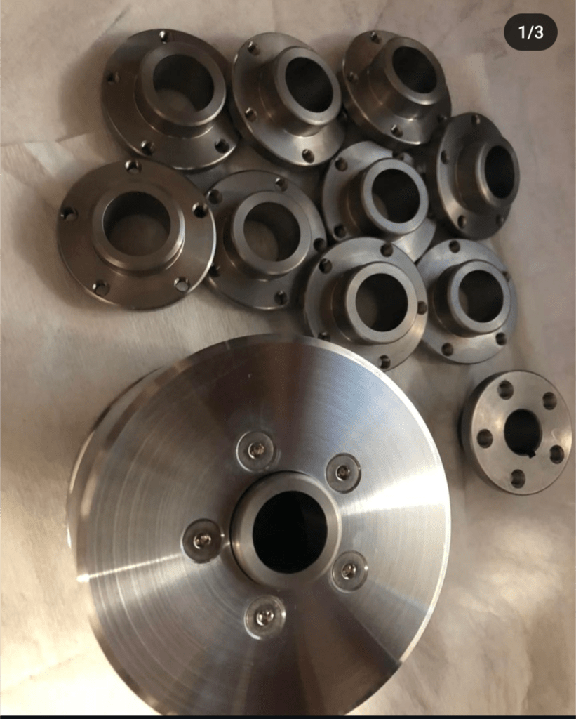

    Skip the 2.8 and get a quick change pulley setup. You will always want to go smaller.
    Norton and 12TRDTacoma[OP] like this.

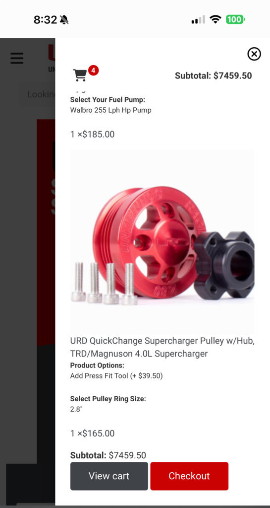

    This one right?
    IvanhoeTaco[QUOTED] likes this.

    Yessir. I have a snout cutter if you go below 2.8

    Is the 7th injector needed for anything below 2.8? From reading, HP tuner won’t work with it?
    EDIT***
    I’ll stick with 2.8 right now lol

    7th injector only works with the ucon ecm, skip that. If you do go smaller you can always do FPR boost referenced or get larger injectors to help with smaller pulleys

    7th injector setup requires the URD UCON or similar. If you get to that point there is similar performance options with Meth.
    Either way, I'd install a quick change pulley. At some point you will need to start shaving the snout if/when you go down in size. The pulley and or hub will need to be off at that time.

    I agree on the quick change pulley setup. If I had to do it again I would have done that from the get go. And make sure you trim the snout first that way you can go to smaller pulleys with no problem

    I don't endorse URD here and it's evident that they follow the thread here because how else would they have come out with their own qwikchange years after I found pulleyboys and smoothflow. Smoothflow is the best option here. Out of the bunch due to price and because he's our OG quiet sponsor.
