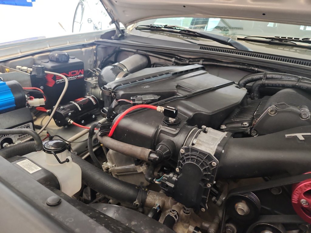

    I would heavily consider a water/meth setup. You can be safe without it, but it's cheap insurance and 100% adds power and keeps heatsoak down. I cannot recommend it enough. If you can wire up a light bar you can easily install it.

    I have the sno 2.5 kit bought from a fellow member. Everything needed to run. I use a mixture of heet and washer fluid to get a 50/50 mix.
    I live in southern NC so summer temps are brutal, was only able to hit 6 psi and after a few pulls would get so hot it would lose power, after meth i can run hard all day in 100° temps with no issues.
    A/F at wot is 10.1

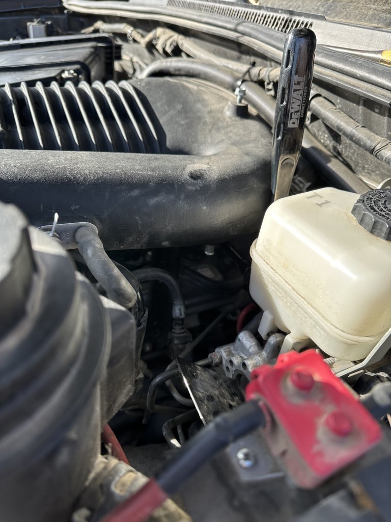

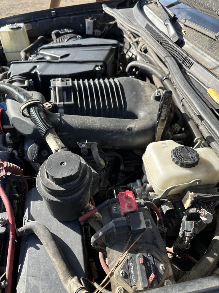

    There isn't really an easy way to swap out the pcv valve once the blower is on, is there? If anyone has any tips to do this on a TRD off road I'd appreciate it.

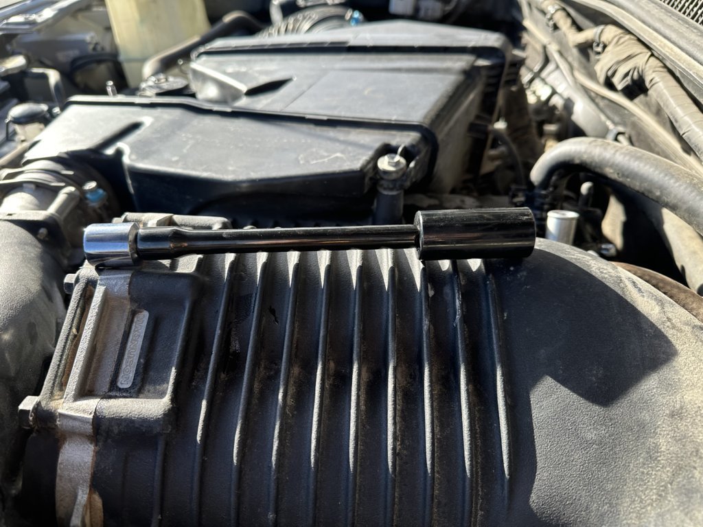

    I moved the coolant reservoir and there's just enough room but it is definitely a faster job without the supercharger.

    A swivel will help too. It's a tight fit, but it can be done.

    I used a breaker with a swivel head to break it loose but I dislike the ratchet with a swivel that I have so I didn't even think about using it.
