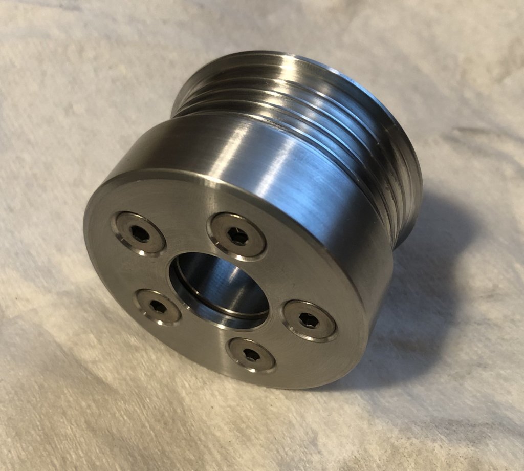

    Haha! I'll mark you down as tentative for now and I'll check in with you closer to the initiation of the next group buy.
    I suppose the studs you have now could be sold to someone who is planning to keep the stock bearings/idlers.

    Sorry I've been out of the loop. So there is a revised study?

    Yes

    Rolled threads this time around?

    Can I be marked as tentative? I'd be interested to see the details. Tacoma is going turbo but my 4runner might inherit the supercharger.

    I'll mark you down as tentative.

    Regrettably no - this shop doesn't have the equipment for it.

    Do you want to make the next batch? ;)

    We definitely could.. @Athlaos if you wanted to see what we can do, send me some info.

    only 2.0, why not toss in a 1.87 like @Athlaos
