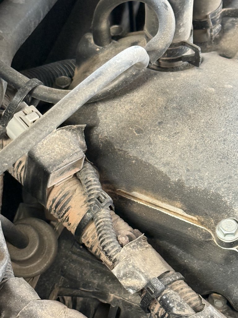

    I did notice this today on the edge of the S/C. It could be nothing, but it seems like some type of residue.
    Game for any suggestions or tests to run or see if I can run them.
