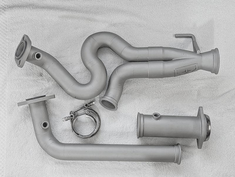

    did you have him install the 02 ports up front and rear? Looks like it. something I had asked him about while ago.

    Yes. Looks close enough to the stock location (with the driver side port a bit lower than stock) and the single rear for a wideband. If I did need it. Possibly could remove the rear sensors and use for dual wideband
