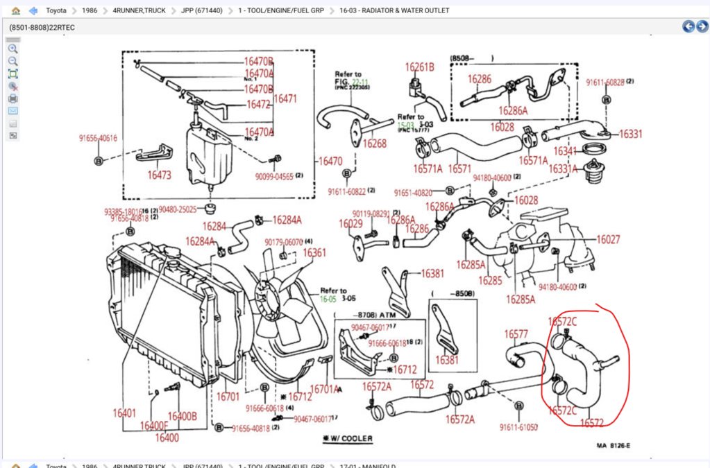

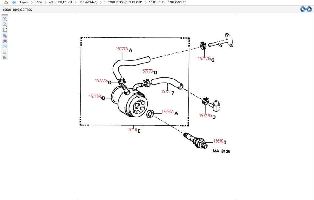

    @XPOTRPR Sorry to hear about the mishap. Not sure if they're still there, BUT there should have been a pair of lock plates that serve as washer and holds the turbo together to the manifold. Most likely not, most "tuners" leave it off on aftermarket installs. It's not guaranteed to hold it but it's a bandaid.
    I got kinda lost with the explanation..I would however put all the heater hoses back to stock orientation and fix the blocked off hose if you're going to run a standard heater core and plumb it to your engine. Upon some research I've saw some people.use the heater as a point to T off a coolant return but all other hoses and routing remained the same.
    I've had an OEM sr20 turbo on a non turbo Nissan motor. I've never had a 22re and not sure if they had coolant supply on stock turbo but I assume it would be applicable. For the water to turbo supply, you may be able to tap the radiator line as you planned. I considered the same and ended up using the plug via the access/drain port on the side of the block. For return, I tapped the metal thermostat housing for a coolant line..I have had to braze on an -AN fitting to thermostat housing before. It's been too long but I'm 99% sure. As long as you have coolant in there, it's doing the the job of heat exchange. Hopefully that helps. I didn't mess with any extra T unions and tried to keep the cooling simple. Sorry I would provide pictures but it's been 20 years since I did that swap.

    I appreciate the input. Yeah it's hard to explain just due to so many aftermarket parts + the modification of the factory components. I think I have it sorted out.. I just wanted to confirm the water feed location I was going to splice in would be ok. I have all the parts listed out, just need to gather everything. This will put it back to OEM setup.

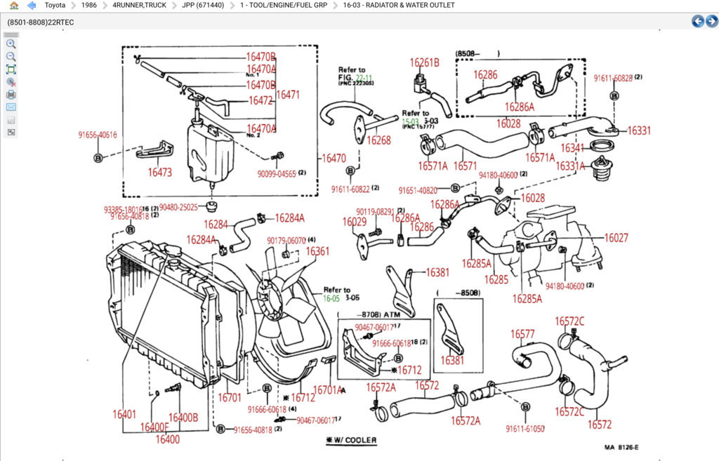

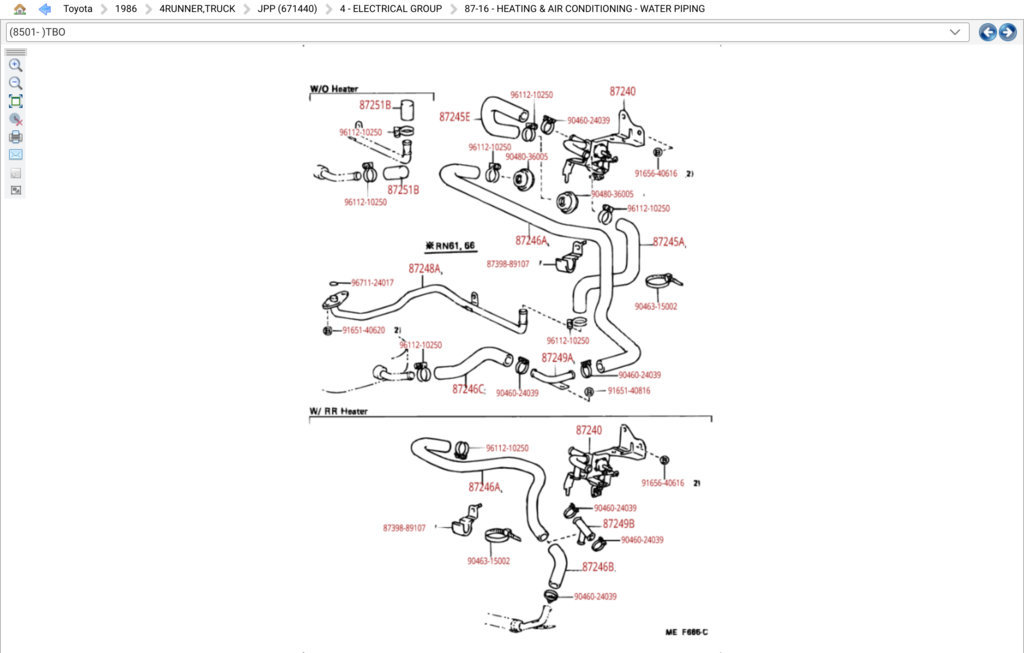

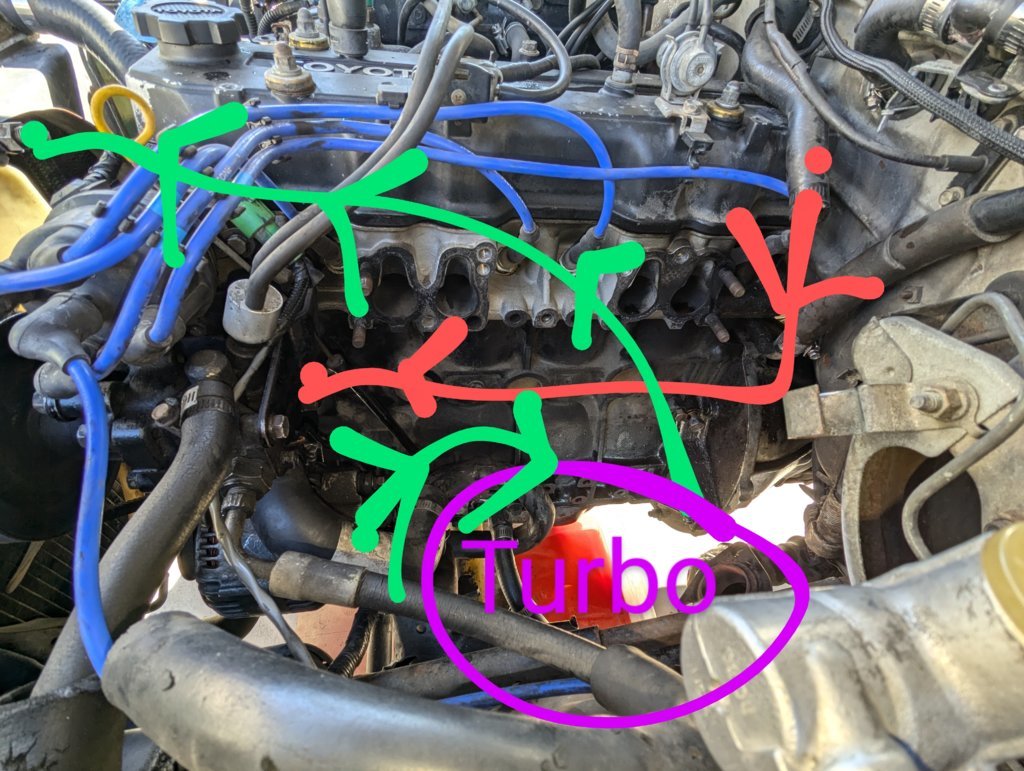

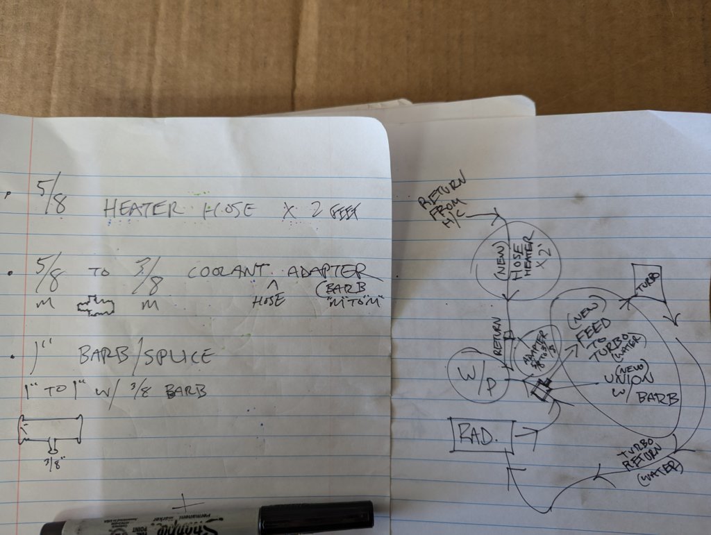

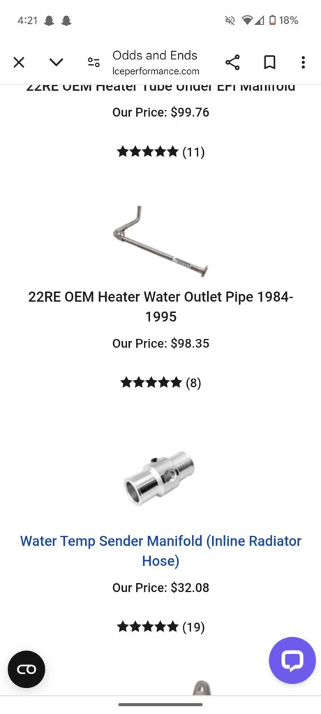

    I love you Jake.. thank you so much for posting this! It's all I needed to be able to understand what was changed and how its intended. Now its reassurance. This part right here is what I suspected was replaced, but could not find much if any info on it.. or a solution for when it fails.. as most of the posts that were even remotely close had broken picture links.
    Here's my plan/diagram.. and parts list from LCE and AutoZone..
    Green is water. Coming from the piece that was replaced. I plan to splice in a T Union with a 3/8 barb to feed the turbo... Then back to the factory return at the radiator. Red is heater core return. I plan to run it back to factory location at timing cover/water pump.
