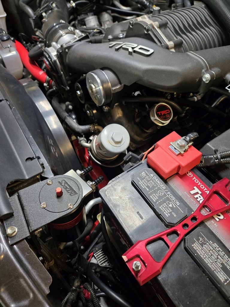

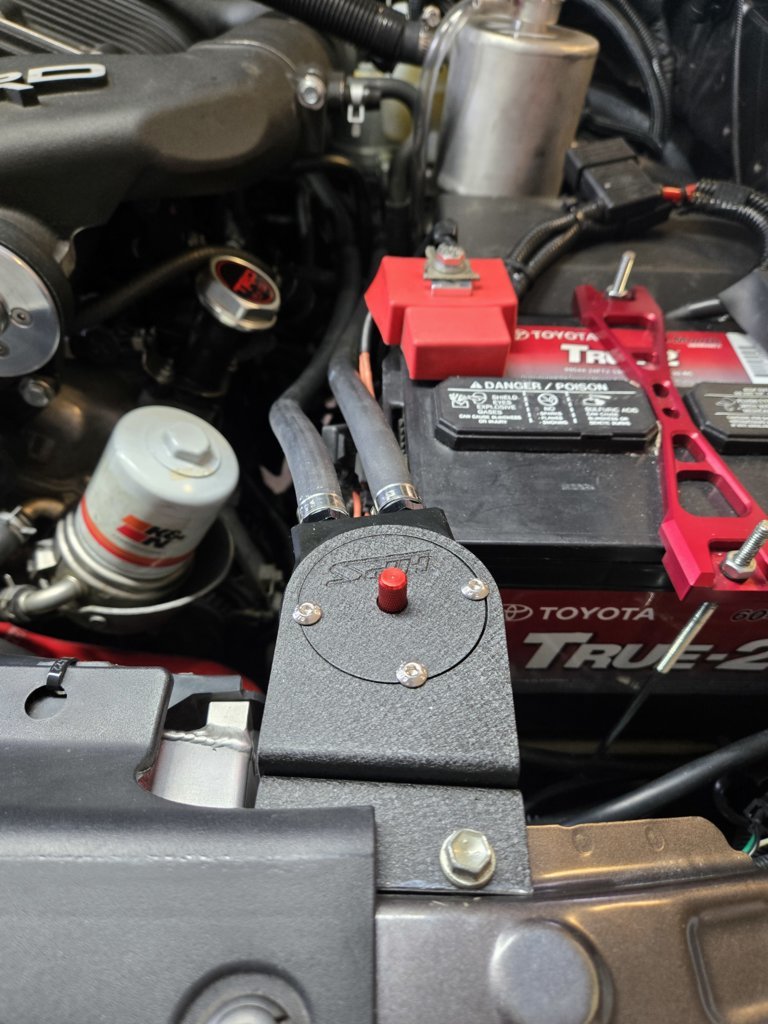

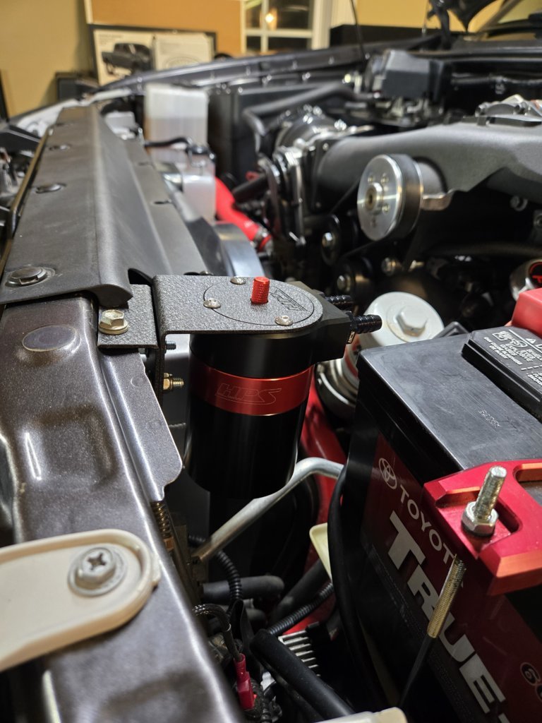

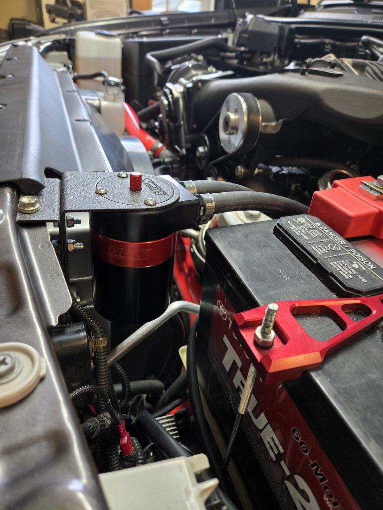

    Going to run the lines tomorrow, but got it to fit in there perfectly. Trimmed the bracket and used m6 rivnuts on the front.

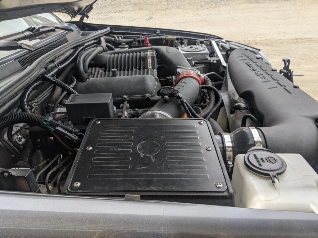

    I drilled holes in the side of my afe airbox and mounted the can to it. My catch can has a drain valve and hose routed down to the frame for easy maintenance.

    Ideally a catch can should be at the lowest point ;)

    Right side of the engine bay wall is where mine is. There was already a couple holes it mounted right up to.

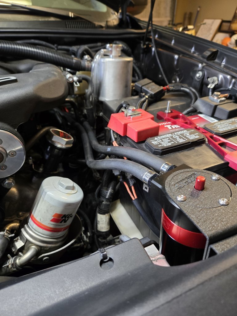

    Here's the end result. I'll probably trim the lines just a little bit but that's how it sits now. Appreciate everyone's inputs. TW is the best.

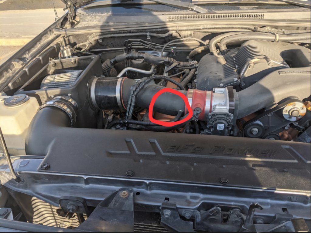

    I like how you've combined the larger TRD pipe with the AFE air box. I'm looking to do the same. Just curious but what do you have tapped in right before the TB silicone coupler?

    I had something like this made of abs. Can't remember the size off the top of my head but 3 or 4", had to cut one side nearly flush with the tube stub, drill a couple of new holes and used small bolts and nuts and RTV to seal it good. Then bought a silicone adaptor that bumped up another inch or so to fit the intake extension to the radiator.
    Can't remember if there was much improvement in airflow either hahaha

    Thanks! That helps alot. What do you have running right here?

    One of two points of methanol injection the other being on the opposite side of the intake tube. The whole intake system was a real Frankenstein project. TRD 4runner/FJ intake tube (bigger inner diameter than the AFE one), silicone adaptors, somewhat smoothed out 76mm throttle body port matched to the URD Throttle Body adaptor which was also matched to the smoothed SC inlet. Also spliced wiring for 4runner/FJ MAF sensor. Pioneered by a couple other fellas on this forum (BillDaCat8 was one of them).

    Nice! I currently have the T4R 70mm throttle body. Methanol is on my wish list. Any issues running it? Yep, just did my harness yesterday going off @BillDaCat8 write up.
