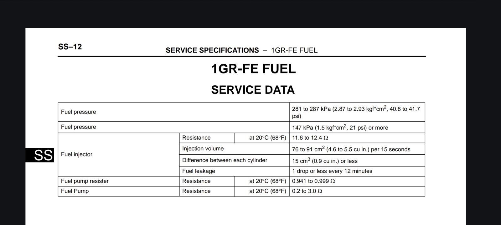

    To those who monitor fuel pressure; what values do you typically see?
    My manual states between 40.8 and 41.7psi is normal. I read around 41. Under high load it goes to ~47psi. This is on a diagnosis gauge. At shutoff it drops to 37psi and holds for at least 10 minutes. Manual states it should remain above 21psi after 5 minutes.

    i want to say mine is at 50psi. id have to check again when i drive it next which will be tomorrow. so if i remember ill report back. and it doesnt move at all. i know that. whatever it does read its always at that constant reading.

    50psi is way above what I have been finding as the spec.

    just looked at a video i have of truck running and its 50. pretty sure thats what its suppose to be. on stock pump i had it down to 45 at one point but with the DW 255 its at 50. i also have the stock regulator on it too.

    Mines anywhere from 41-43psi depending on the ambient temp. But im running the UCon and it wants to see steady fuel pressure so it is not boost referenced

    I am not boost referenced. Wondering if I should try. Also thought of reinstalling my UCON again to try something different.
    My injectors are not maxed. Fuel pressure is ideal at idle. Not sure how much it should be going up when under load. Still leans out once into boost.
