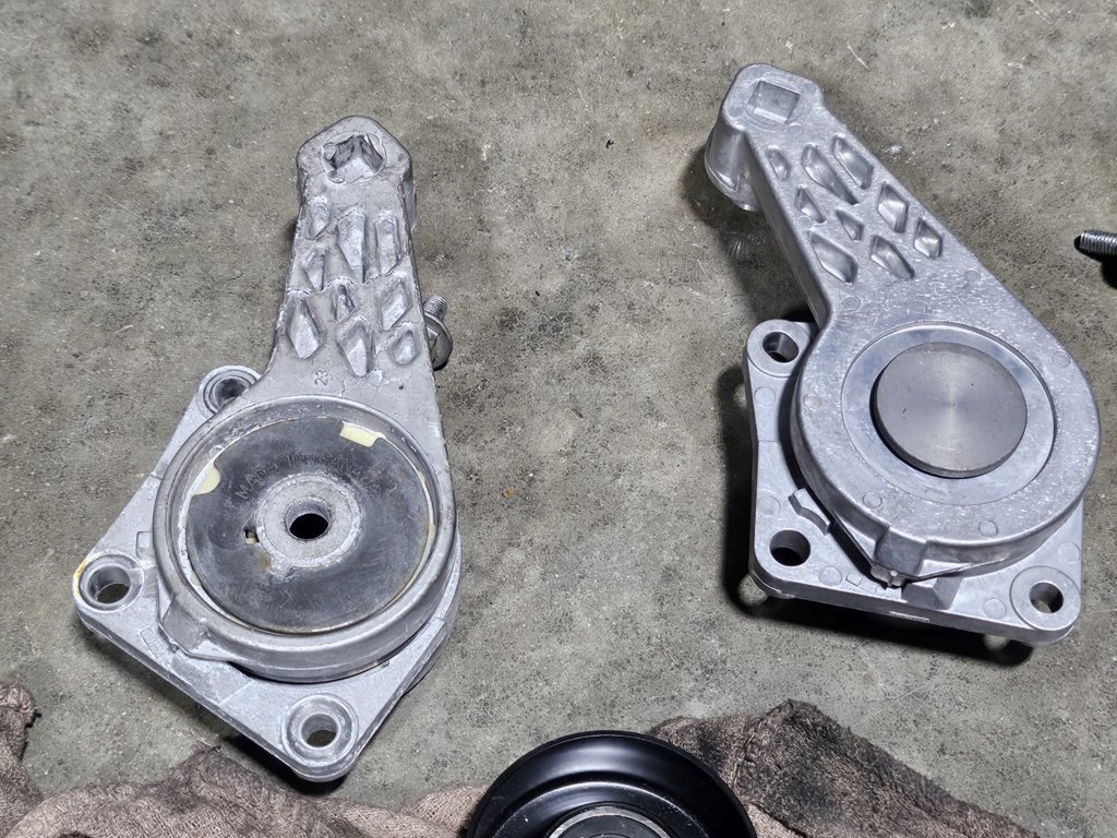

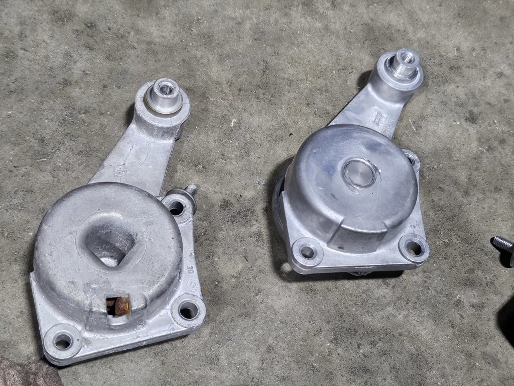

    Found this tucked away in the corner of the shop recently. Pretty sure I bought it years ago and forgot about it. Existing tensioner on the left has only had a breaker bar on it less than half a dozen times.
    I completed shaving the stop and prepping to install it in place of the "new" existing one which practically has 0 miles on it.
    I am running a 2.8" pulley for reference.

    Future-proof by cutting the snout and going with Smoothflow Pulleys Qwikchange Hub. :burnrubber:

    I already got the 2.8 URD QuickChange pulley. :)
