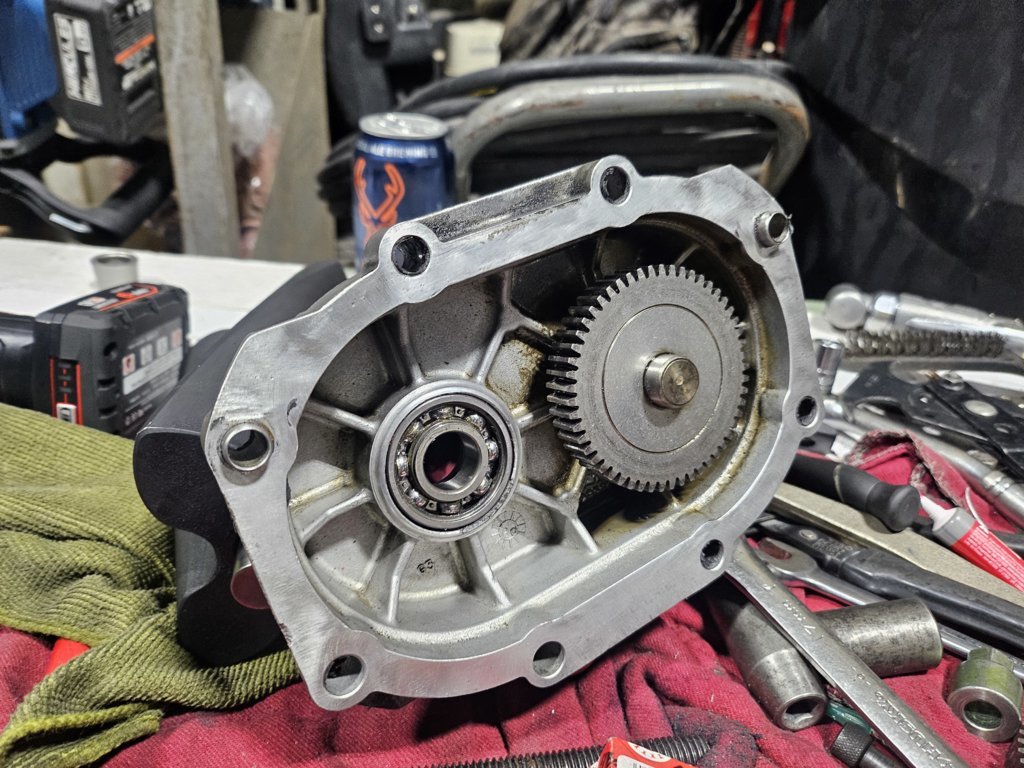

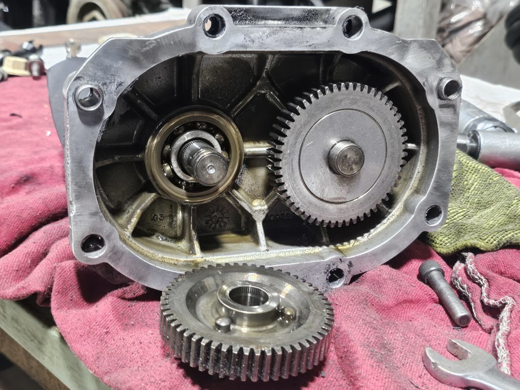

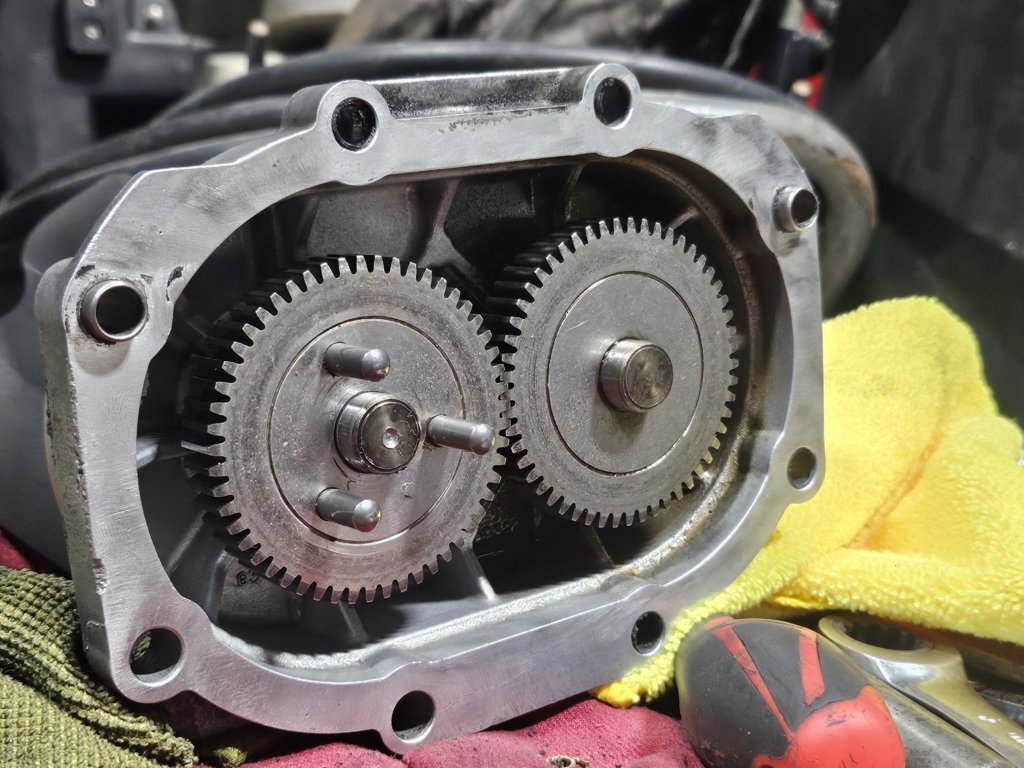

  14. Feb 14, 2025 at 9:11 PM
    will.i.was
    will.i.was Well-Known Member
    May 6, 2018
    #252688
    1,691
    Will
    Houston, Texas
    SC 2.5

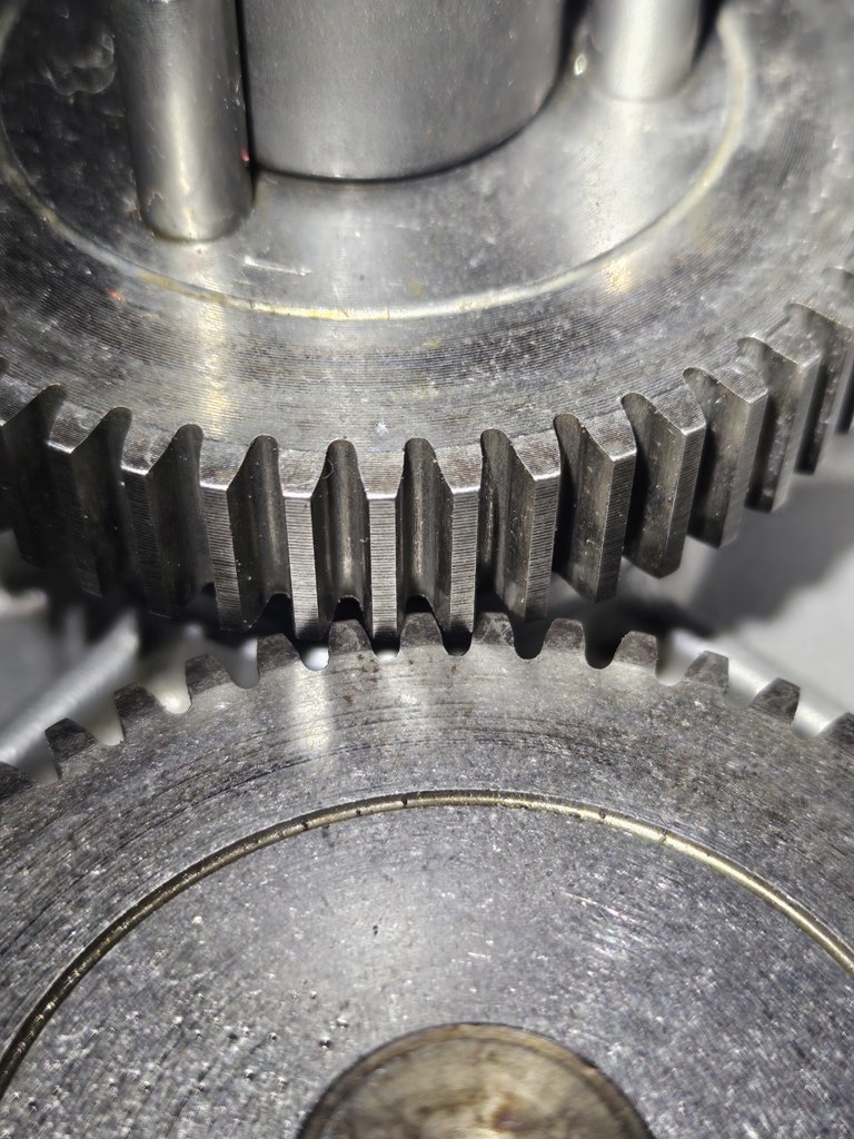

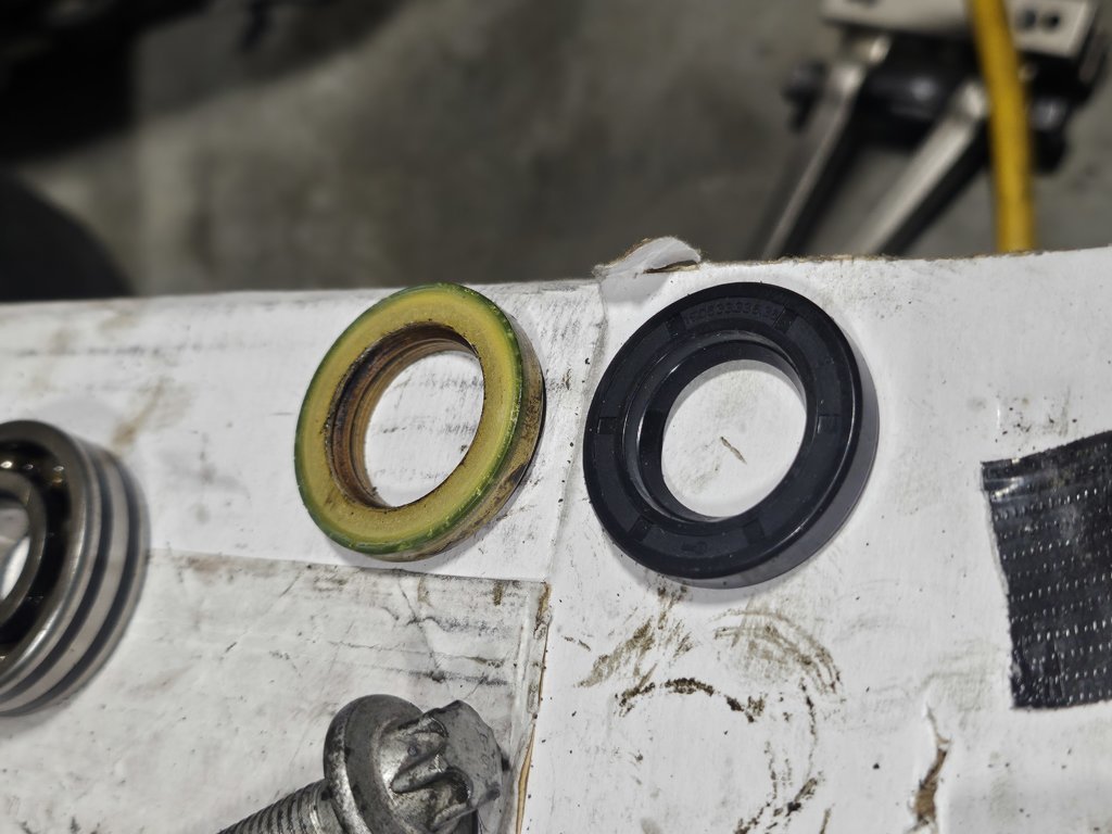

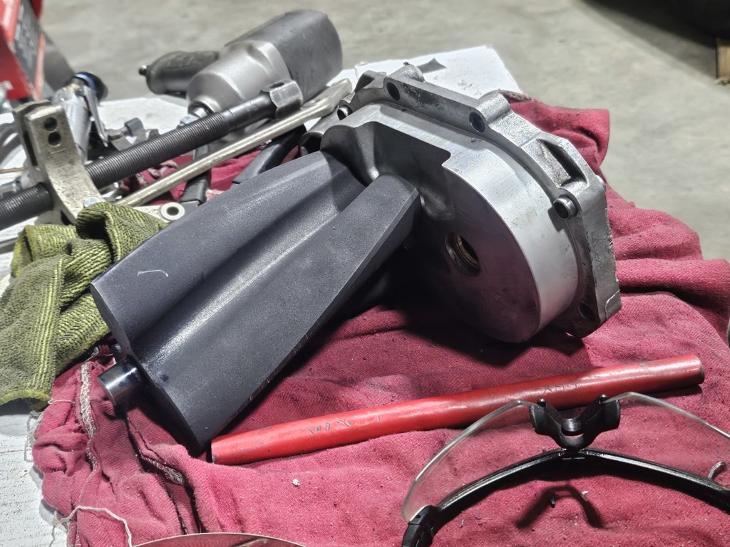

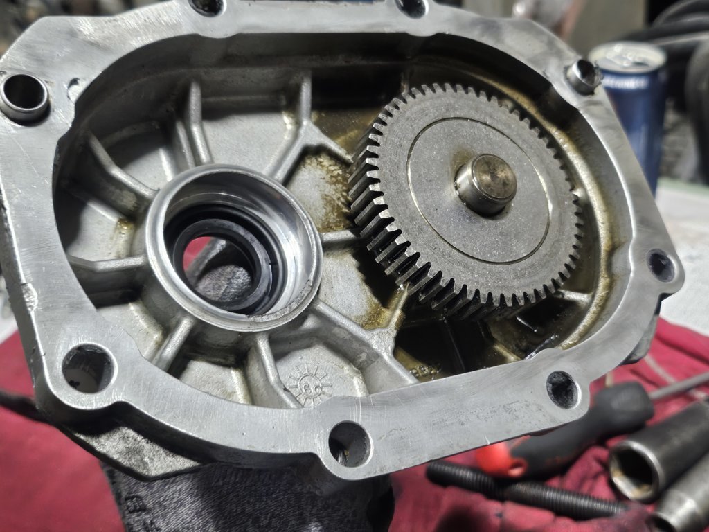

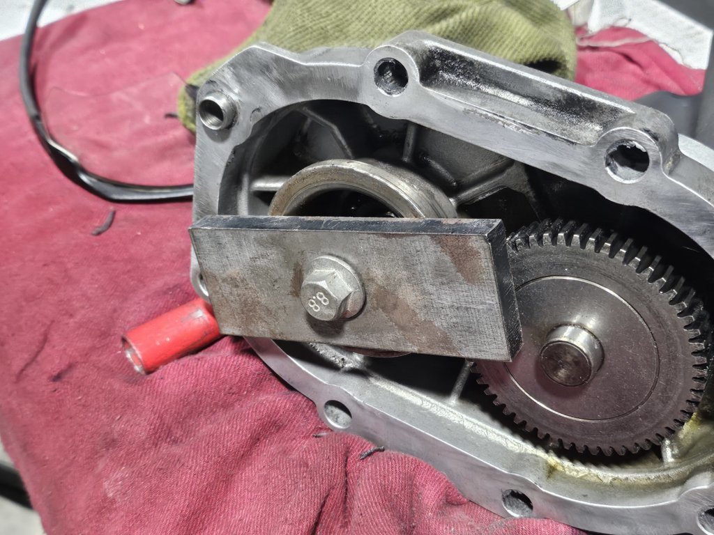

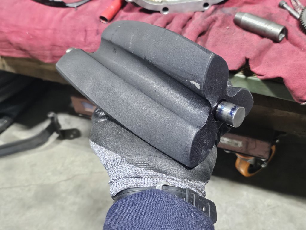

    Another rotor pack bearing rebuild.. went much smoother this time. 20250214_200926.jpg 20250214_202137.jpg 20250214_203501.jpg 20250214_202141.jpg 20250214_205923.jpg 20250214_205929.jpg 20250214_213341.jpg 20250214_220430.jpg 20250214_221025.jpg

  18. Feb 15, 2025 at 3:44 PM
    will.i.was
    May 6, 2018
    #252688
    1,691
    Will
    Houston, Texas
    SC 2.5
    Typically the bearings that wear out more often are within the nose itself which is relatively easy to service. The rotor bearings are more difficult because they have a fine cast on the inside that needs to be reinforced when pressing them out.
    The other biggest issue is timing. You can see some of my witness marks that i made with an engraving tip and high speed drill.
    I always have my butt cheeks clenched doing these. It took me about 5 hours to do the rotor bearings due to some serious deep cleaning that needed to be done. This was also the first time I utilized these types of seals which i very much prefer over the ones typically provided in a rebuild kit from the more well known suppliers.
    For those wondering, this was the kit i purchased.
    https://www.ebay.com/itm/175498536942
    BassAckwards likes this.
  19. Feb 15, 2025 at 3:49 PM
    will.i.was
    May 6, 2018
    #252688
    1,691
    Will
    Houston, Texas
    SC 2.5
    I have all of the tooling and a full shop in order to accommodate even attempting this. I pull and press in dozens of varying bearings everyday but these rotor bearings require the most absolute focus. I almost feel like im going to snap a rotor shaft pressing on the gear all the while ensuring my timing marks are lined up.
    Its not perfect compared to a laser alignment machine and a full specialized shop but i think im only a few thousands off lol which may be, in the long run, too much tolerance. We will see in some time.
