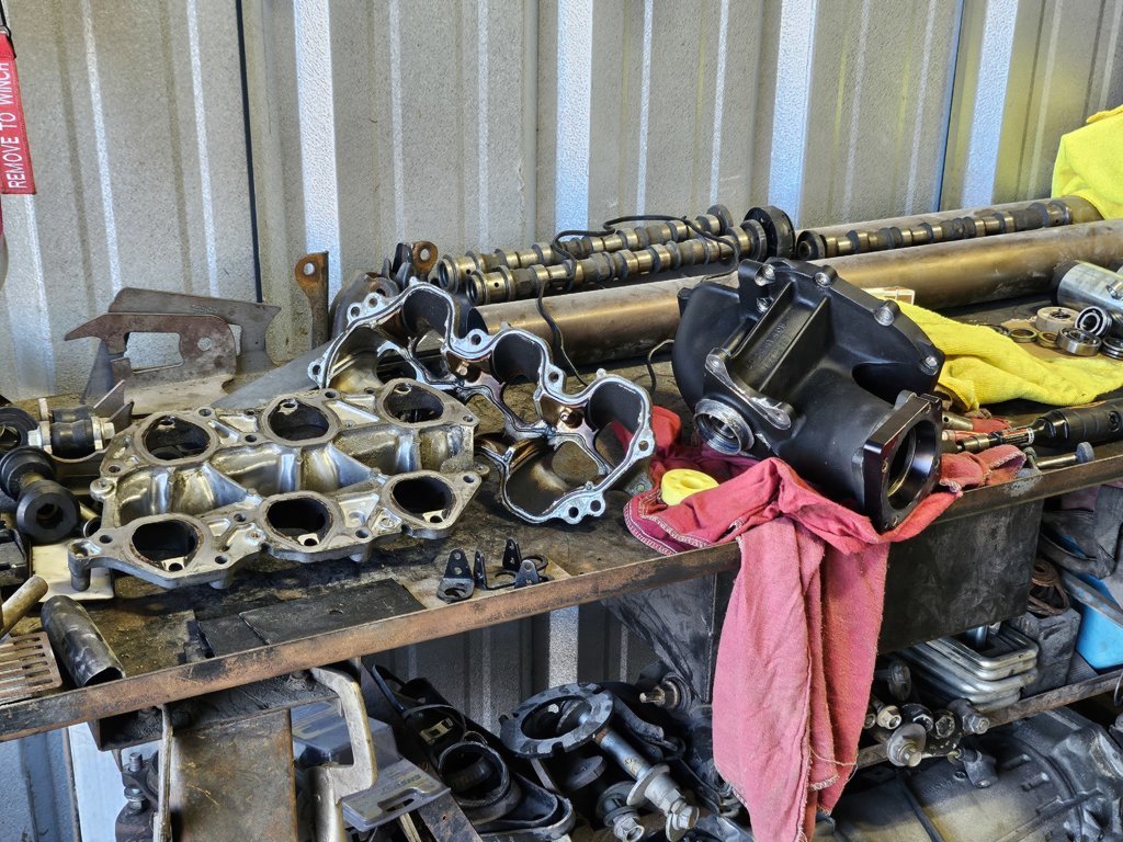

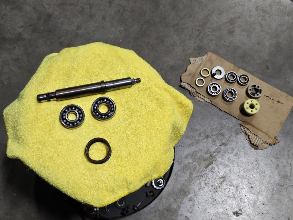

    Here's a whole family picture.. pretty much all of the old and new besrings together minus the rotor bearings. Completed that today and almost done with nose drive. I'm utilizing stud and bearing formula on the bearing mating surfaces as I see some obvious indications some bearings are free spinning are20250215_212650.jpg 20250215_212615.jpg 20250215_212641.jpg

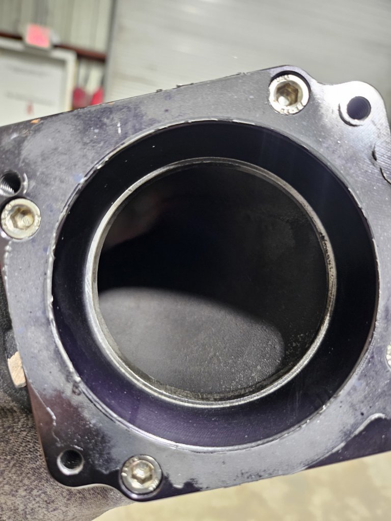

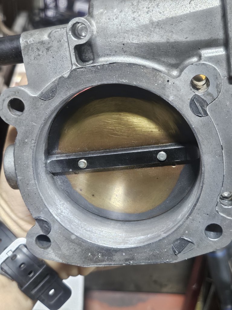

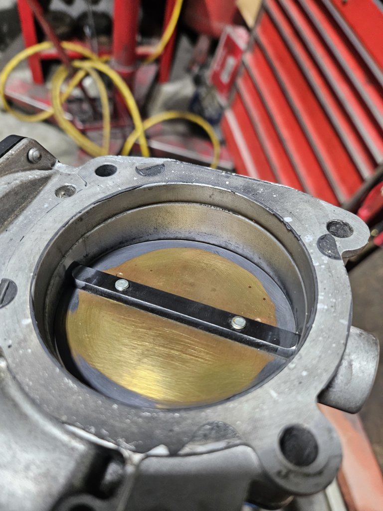

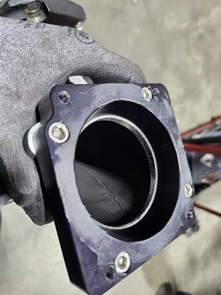

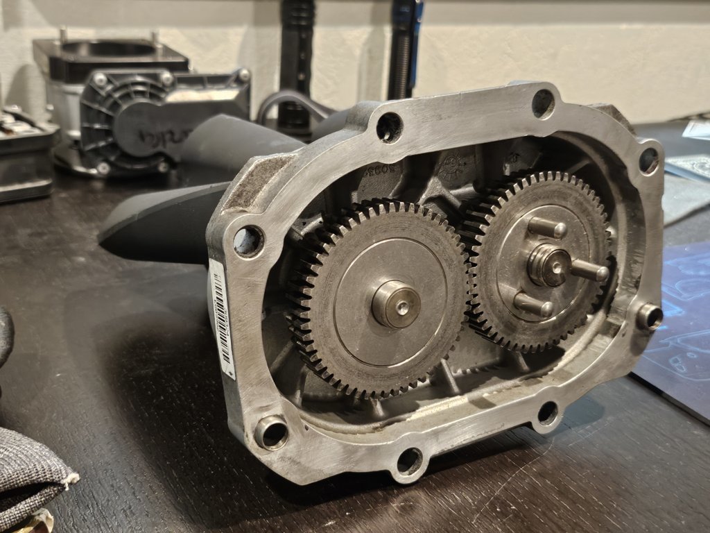

    I did start some porting as well with the tb, sc inlet and have had a spare intake manifold to experiment with. Haven't gotten too far but after seeing the sc inlet from the urd adapter it's a pretty substantial restriction. Pics are of a very rough cut.
    I have been tuning a few vehicles with hpt lately and the gui is getting more intuitive and informative to me. I definitely would not be doing this many modifications without a congruent understanding of tuning all of it.

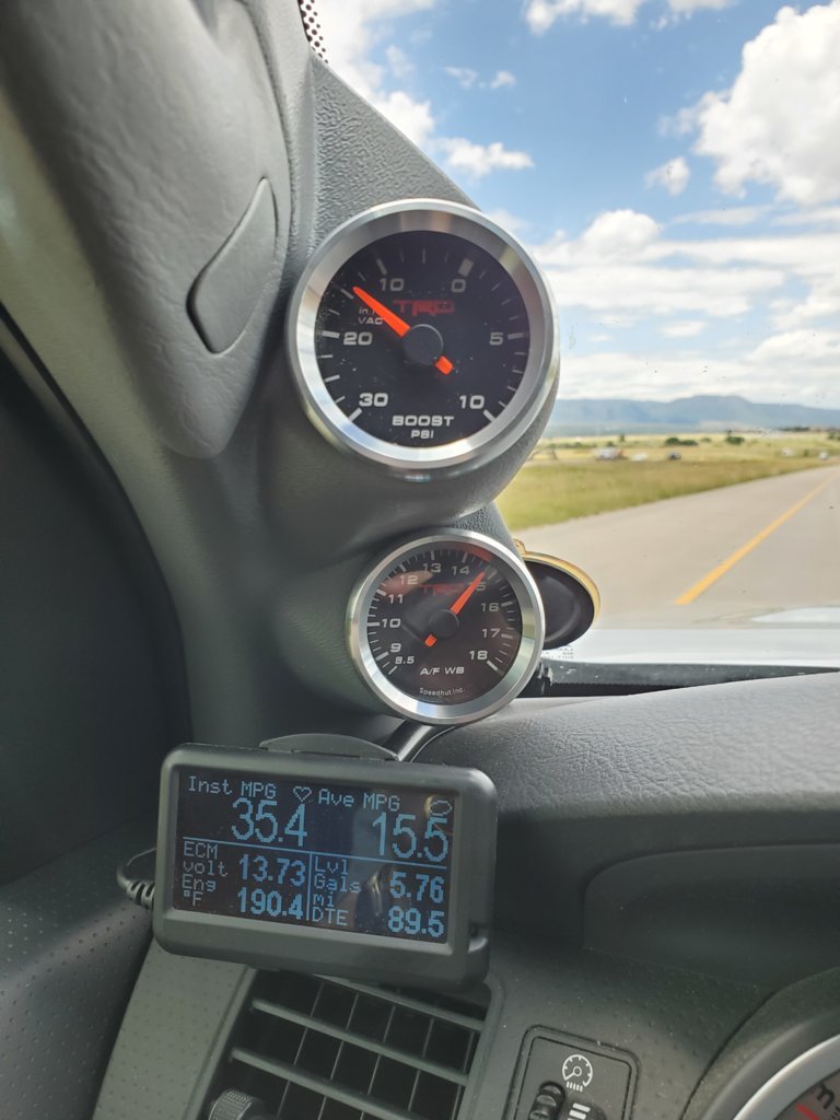

    this is what i have. boost and afr on the column and fuel psi and oil psi on the a pillar

    go smaller since you are at altitude
