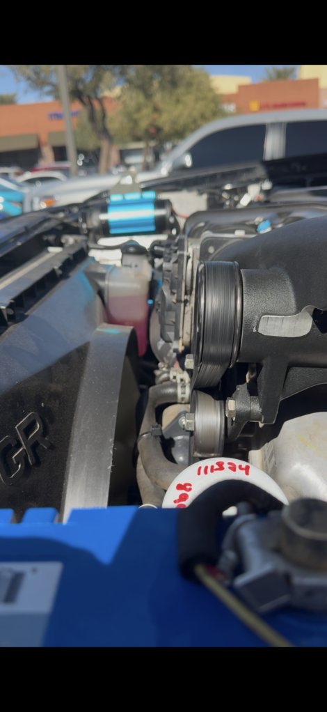

    Hello,
    It is with great pleasure to use this thread for some help. I have recently received my truck back from the shop after install and i believe i may have a bad SC tensioner.
    I purchased a used SC and had it re built internally. But i have noticed a few things while driving recently it felt like the truck briefly fell flat on its face once for a moment on the freeway and drove normal right after. a couple days later it threw a p0430 code. Also i swear when they were running tests i was getting close to 10 lbs of boost at times. so far when i have driven im getting 6-7 max which seems low for the setup.
    reset code ran for data and it didn't come back yet.
    here is what we did.
    2015 Tacoma 4.0
    Magnuson SC
    7th injector
    2.5 URD Stealth Pully
    Cam gears
    URD ECU
    URD Headers
    we have rebuilt almost the whole front end of the engine
    upgraded fuel pump
    new o2 sensors and mass airflow
    new ignition coils
    on top of much more
    wondering if this may be the culprit of the issues what made me also dig more is i noticed this belt not sitting flush. please see image below. if you have any questions i can try an answer or get more information.
    Thank you all for the help on this. i was not so much hands on with the SC portion of this build.

    With the 7th injector, URD ECU I don't have direct experience with your setup.
    I do have memory of another member recently having to send back their URD ECU because it had failed yet again. This was after back and forth with them to even get it fixed.

    Sorry to rehash this for everyone else in the thread… this was the UCON chatter from last summer. This is for @whiteapino254 :
