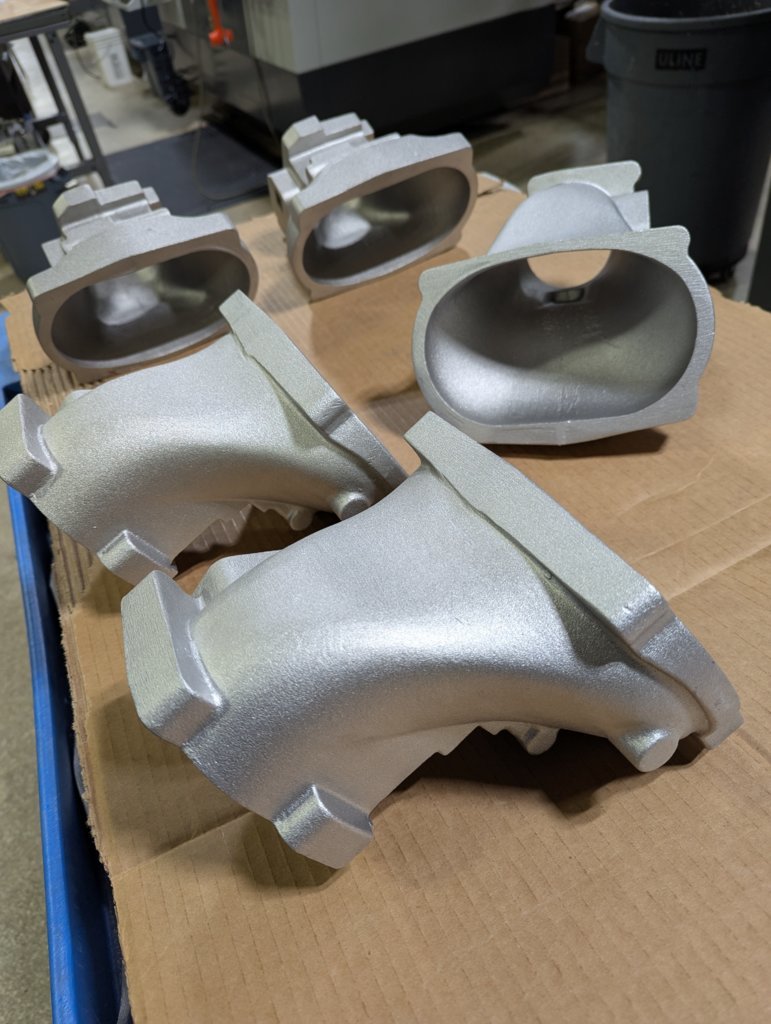

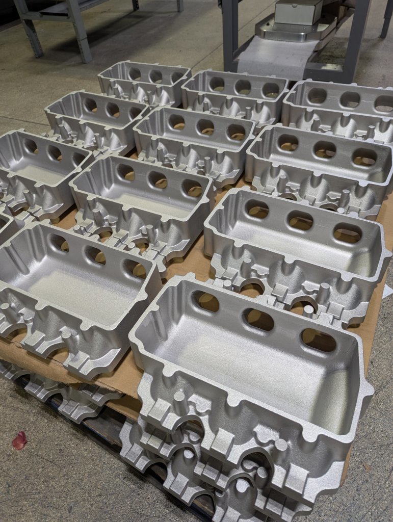

    Off topic.. kind of.
    We got another order of NSX supercharger castings rolling through the shop. Been getting them set up today and updating programming, etc. Lots of finishing work on these..
