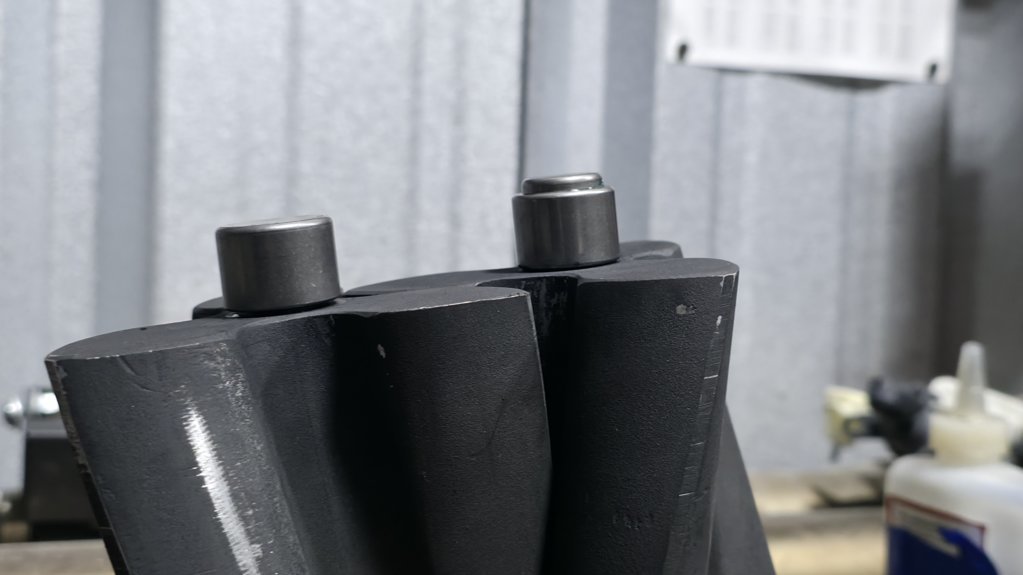

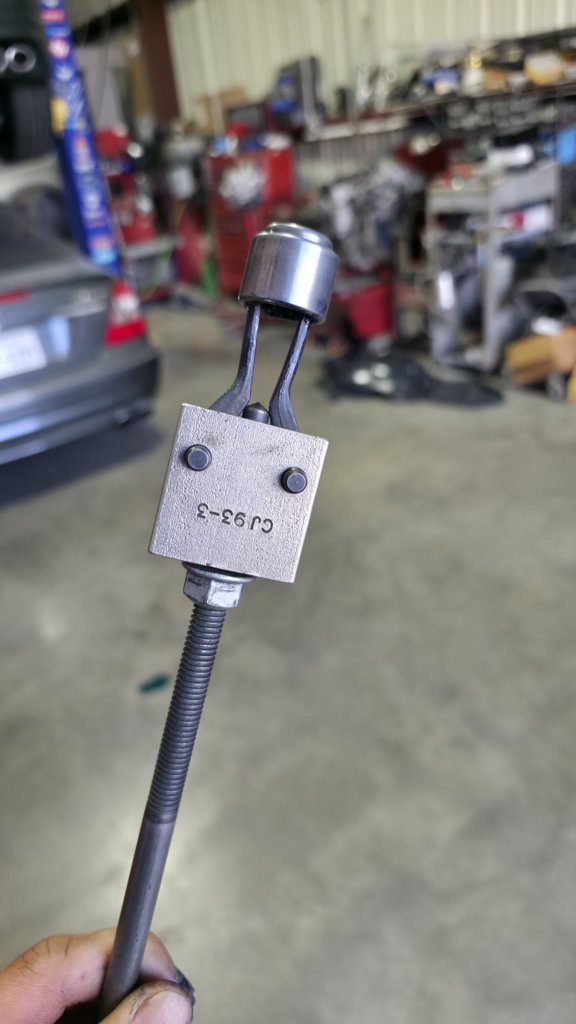

    I always fumbled past this little tool and it finally clicked.. substantially less effort to pull.
    Also note that the m90 needle bearings are too short vs the mp90 housing bearings and the correct ones are specified as the "cup" type.
