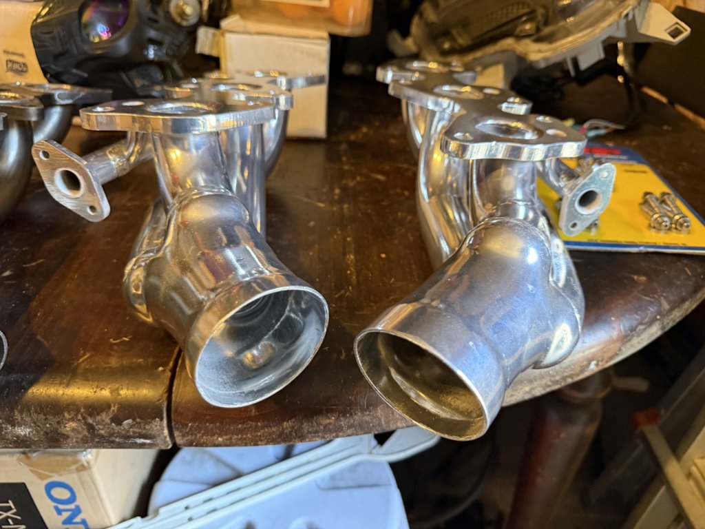

  16. Mar 29, 2025 at 1:42 PM
    nudavinci64
    nudavinci64 Robert @ Holy Horsepower
    Nov 14, 2013
    #116533
    10,146
    Robert
    San Mateo/Cayucos, CA
    13 S/C TRD OffRoad 4x4
    Boosted Money Pit....

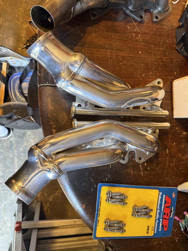

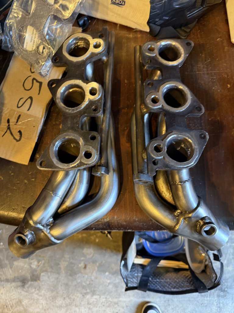

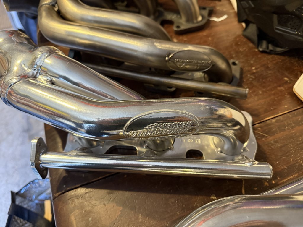

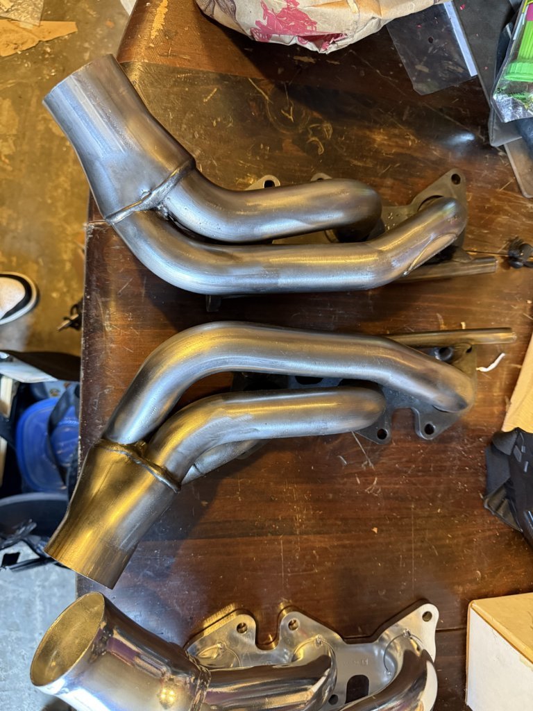

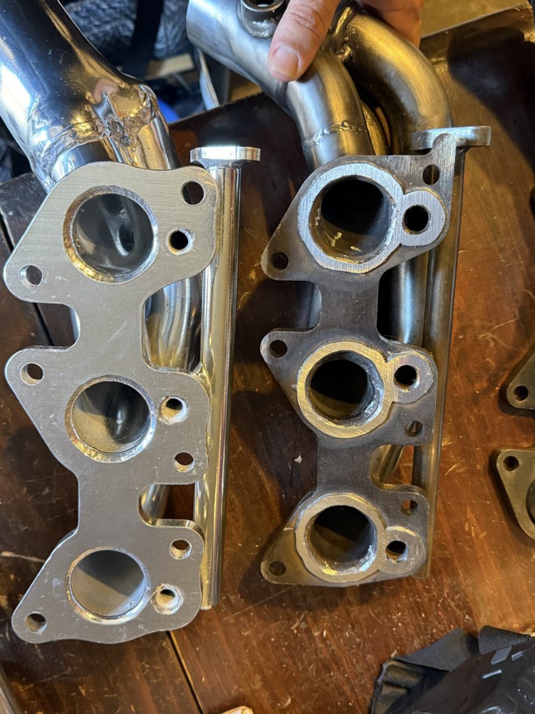

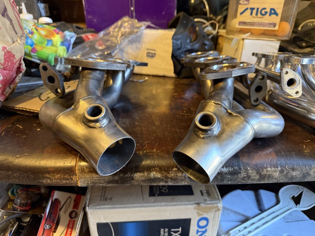

    JBA’s arrived. The DT overall seem much nicer made and finished. Similar design. The JBA the stock slips over where the DT sits over the stock side. Also the O2 sensor port is part of the JBA vs the DT which is not and retains the stock location I believe. JBA notes they use a raised beads for a better seal as DT is flat. JBA included gaskets and CARB OE as well.
    is it worth the effort to port or clean up the edges? Wasn’t sure if it will do much. JBAs def not as smooth as the inside of the Data.
    IMG_3524.jpg IMG_3523.jpg IMG_3525.jpg IMG_3528.jpg IMG_3530.jpg IMG_3535.jpg IMG_3532.jpg
  17. Mar 30, 2025 at 9:11 AM
    EricT
    EricT Well-Known Member
    Jun 1, 2009
    #17887
    929
    Arizona
    '09 4x4 shortbed TRD Sport
    Those headers look cool.
