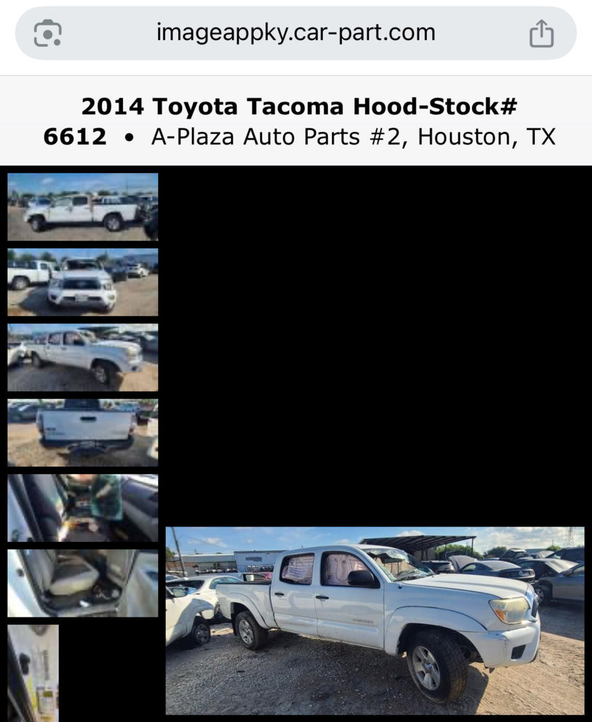

    Start searching on http://www.car-part.com/ for a 2012-2015 hood and fender!

    Looks like there’s a white dclb with a good hood and passenger fender in white!
    https://aplazaautoparts2.com/
    I searched carport for 2012 Tacoma 77611 zip, then navigated to body > hood and this one popped up in Houston.

    Thank you for that I didn't even know that was a thing!

    Yup just saw it too. About to take a trip to Houston. I wonder if that hood will fit in my wife's Honda pilot lol

    Already reserved the hood and fender. Man thanks a lot for the help I really appreciate it!
