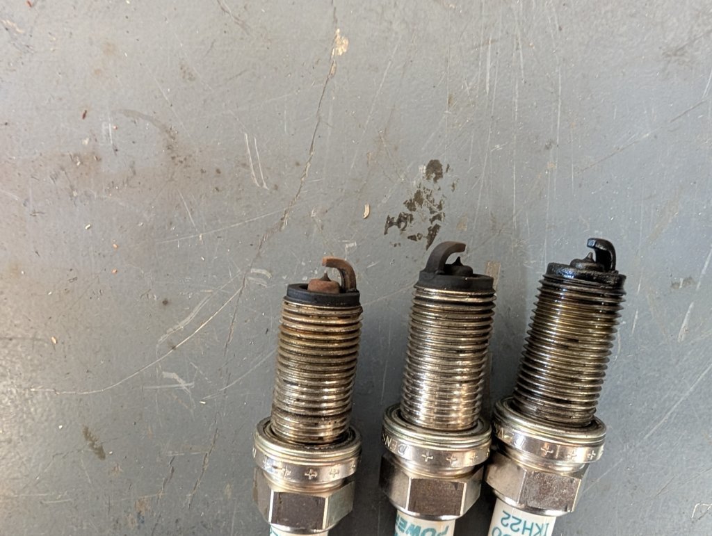

    So, update on my shit. I've had two bad cats for a little while now. Well the start to come apart and on my way home from work Friday I had to limp it home in fail safe mode with a constant misfire. I was thinking it was the cats causing it. I spent all day replacing all four cats and welding on the shorty headers on the new cats from the old ones. During the repair I found large amounts of oil in cyl 6 exhaust port and down through the header and cat. Start the truck up and still has a misfire. Tomorrow diagnosis why there is oil in cycle 6 and the misfire.
    Wish me luck for something easy.

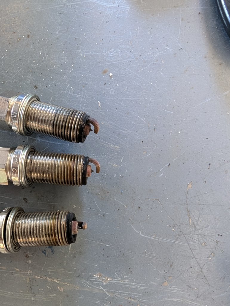

    Pulled the plugs and bore scoped cyl 6. Covered in oil and carbon. No obvious signs of damage. I did see oil running down the walls. (Possible valve guide seals.)
    Performed compression test high 180 low 160. With the lowest cyl was #6. PXL_20250420_191031978.jpg
    1,3,5 top to bottom
    2,4,6 left to right
    If my math is right it is 11% difference between high and low. If I use the second try it would be 9%.
    That is right on the edge of rebuild.
    I will need to get a second set of hand to do the leak down. Unless I take off the supper charger. Which at that time I could check the intake valves for seal leaks.
    At this point out a new plug in #6 and see if she runs correct.

    I managed to leak down cyl 6, only. 37% leak going past the rings and out the oil filler cap.
    REBUILD TIME!! :annoyed::spending:
    Let's hope it just needs rings.

    20 psi difference is what is considered the maximum allowable variance tolerance before some sort of rebuild is required indeed. Anything over that, it's going to cause some misfires but given that you got some misfires already you are definitely going to need a rebuild based on that alone, not even mentioning the oil issues.
