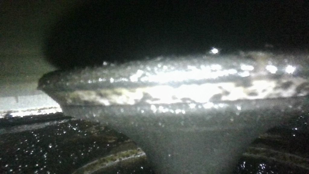

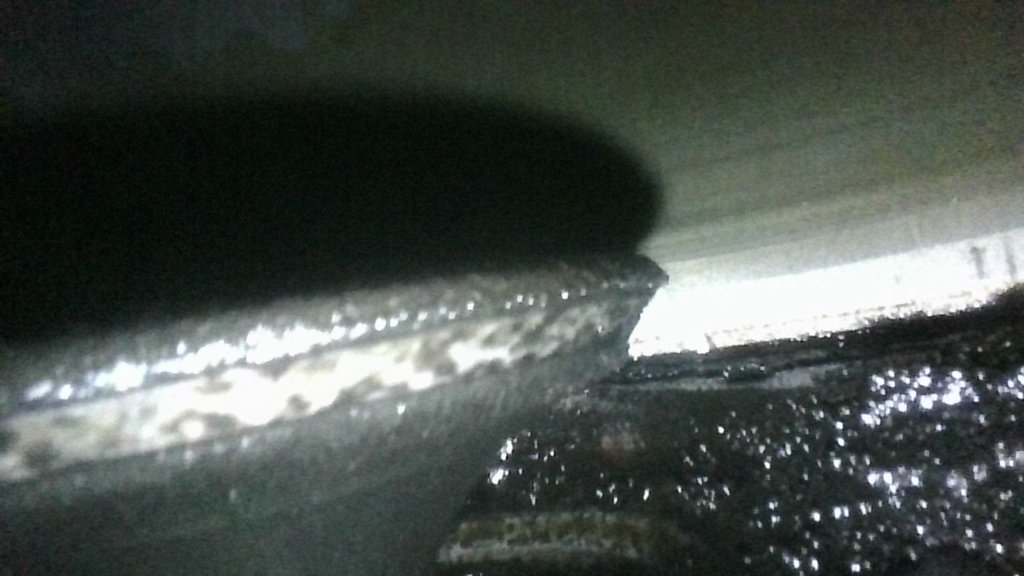

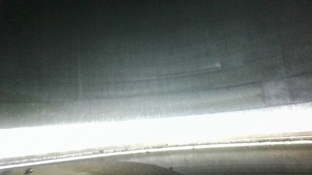

    Here are a few pics of cyl 6.

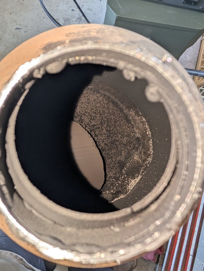

    And one of the cat. LOL!
    12TRDTacoma[OP] and Billy182 like this.

    Damn, that says it all :(

    Are you thinking the fried cats ruined that cylinder?
