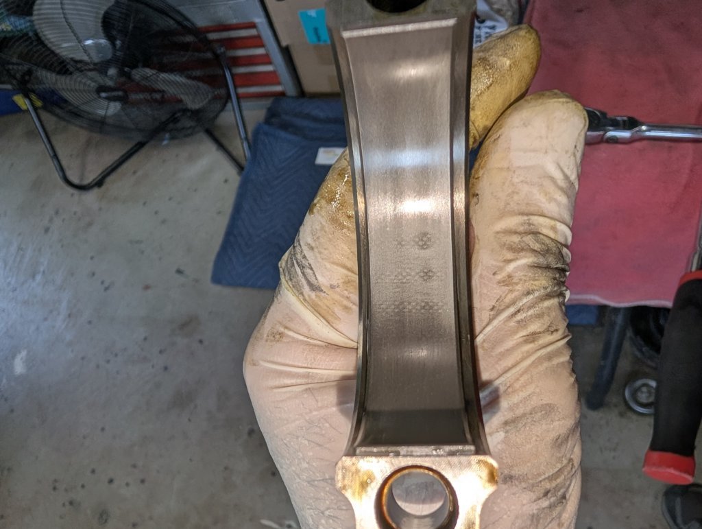

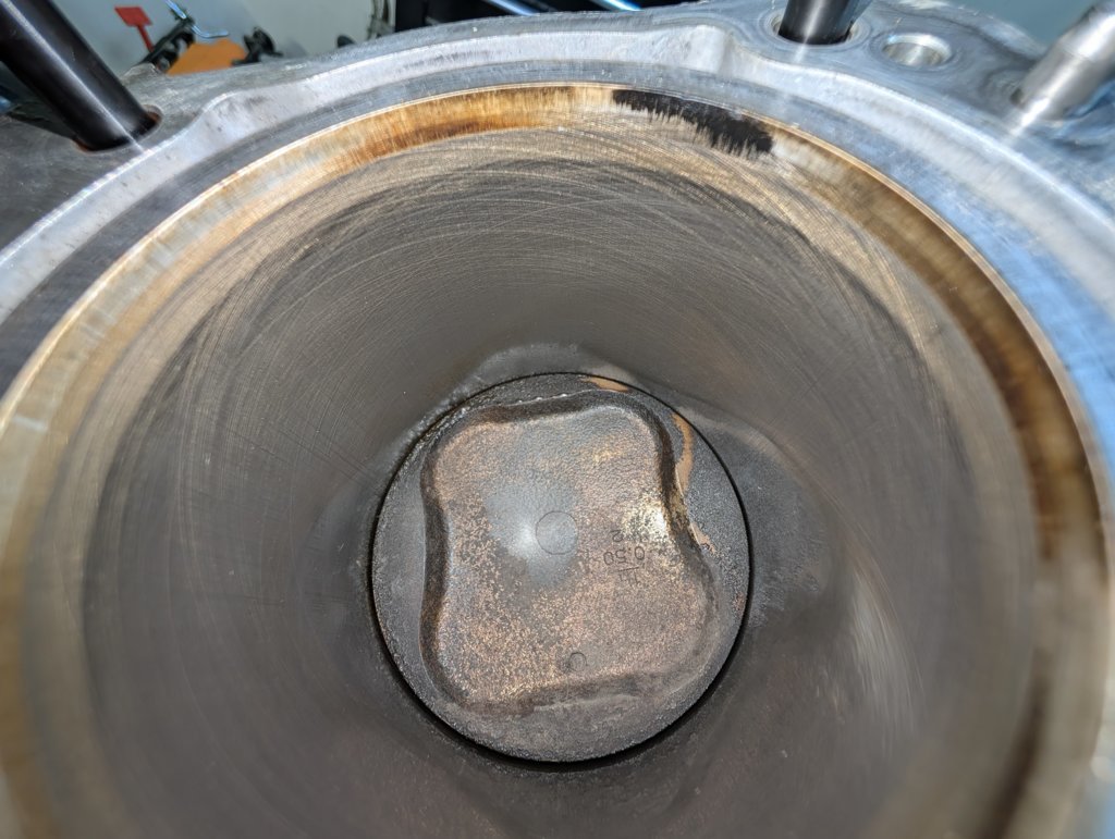

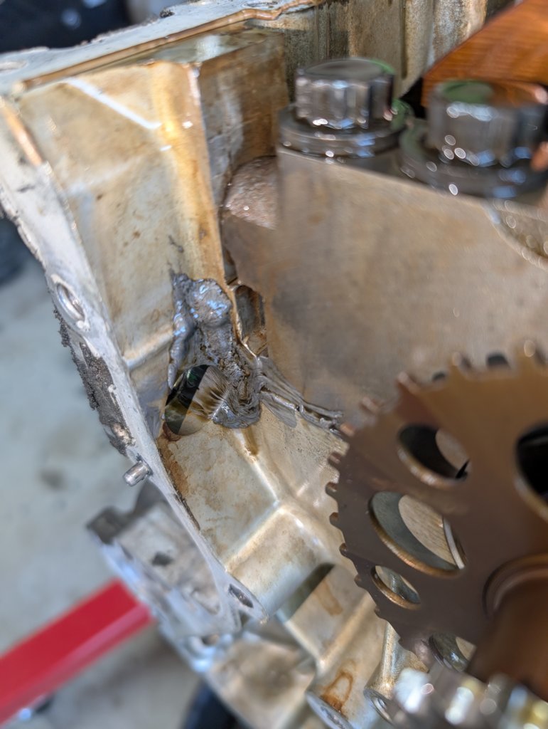

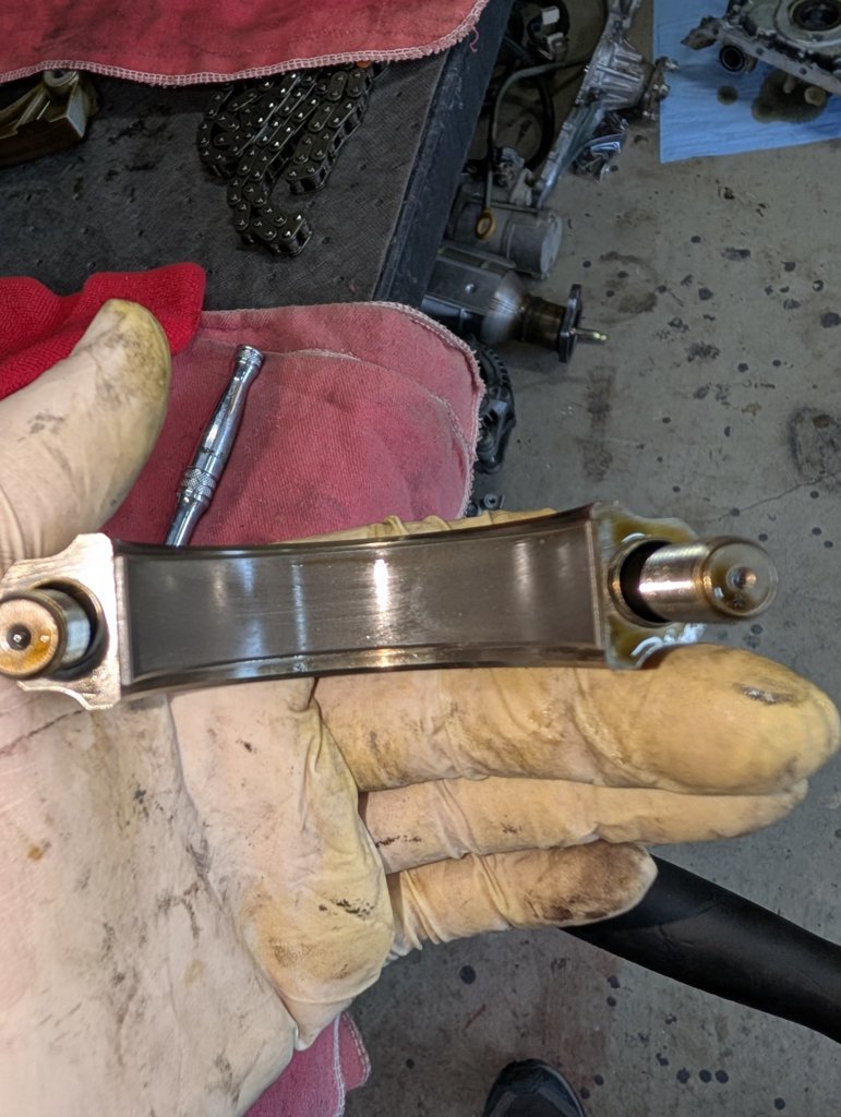

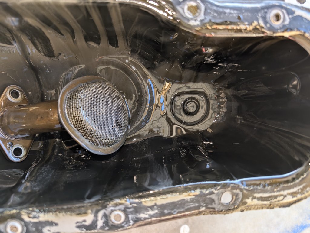

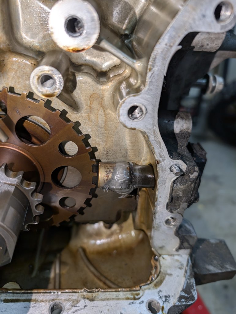

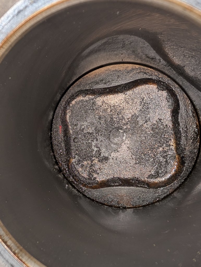

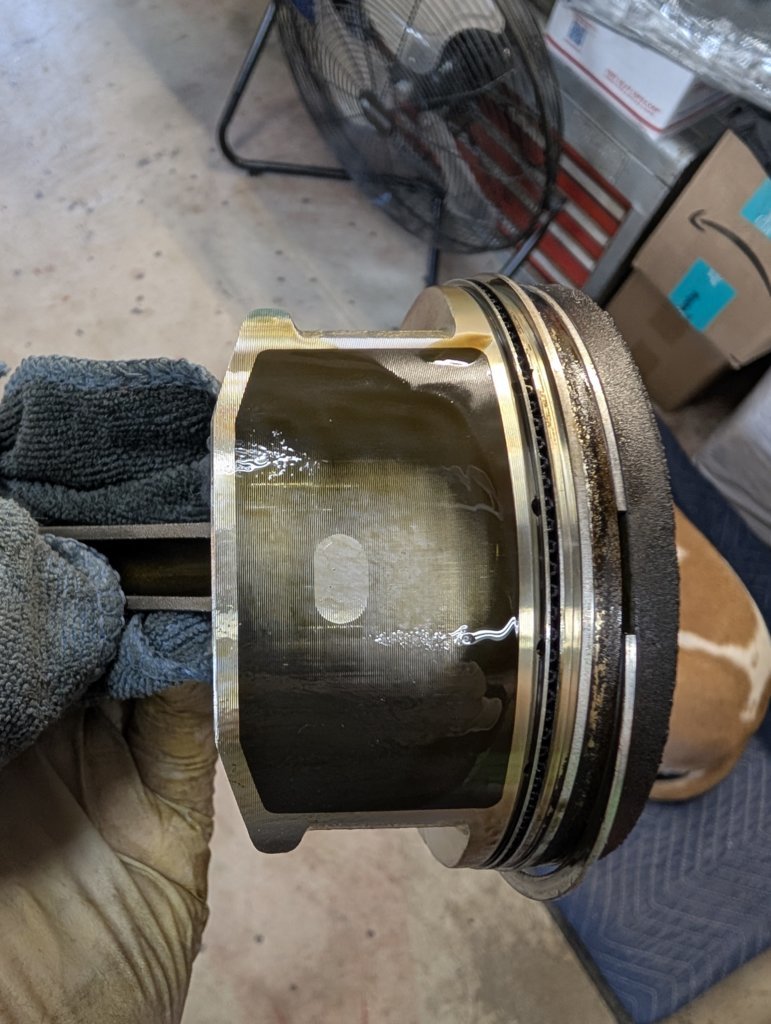

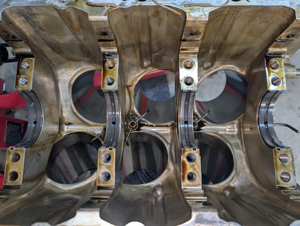

    I have the engine torn down. Most of the parts look good. Surprising! I am finding sludgy cat material everywhere. It looks like a gray paste. the crank main and rod journals look fine and are in spec. The bearings show some signs of wear, but it mostly looks like the dry film lube coating wearing and not the bearing. Here are some pics, not all. No point on seeing repetitive pics. Lol!
    Gray paste cat material on the crankshaft sensor
    Oil pan and pickup, more gray paste.
    More cakes up around the crank sensor
    Cyl 6 bottom rod bearing. Looks good
    Cyl 6 top half. Little more wear. Not bad. All the rods looked close to this.
    Top half of the main bearings. Zoom in and you will see a little wear, but nothing major.
    One of the pistons. Don't remember off hand.
    I contemplating on reusing the bearings and the pistons. As long as the bock does not need to be bored out. Cyl 6 has no more cross hatching.
    Cyl 6
    Cyl 5 last cylinder on bank 1 for comparison. Here you can still see the cross hatching.
    Well, I'm done for the night. I hope you enjoy or learn from my experiences.
