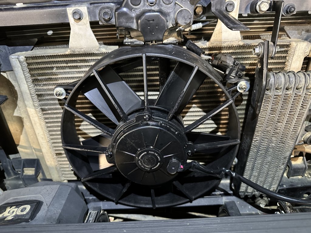

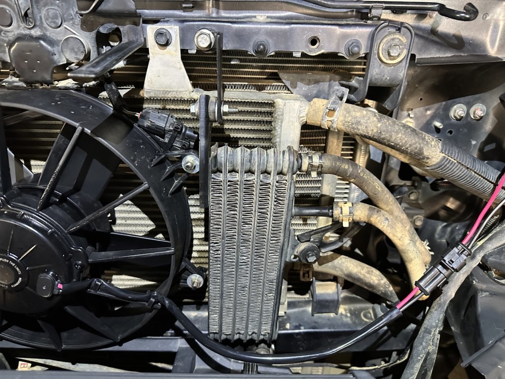

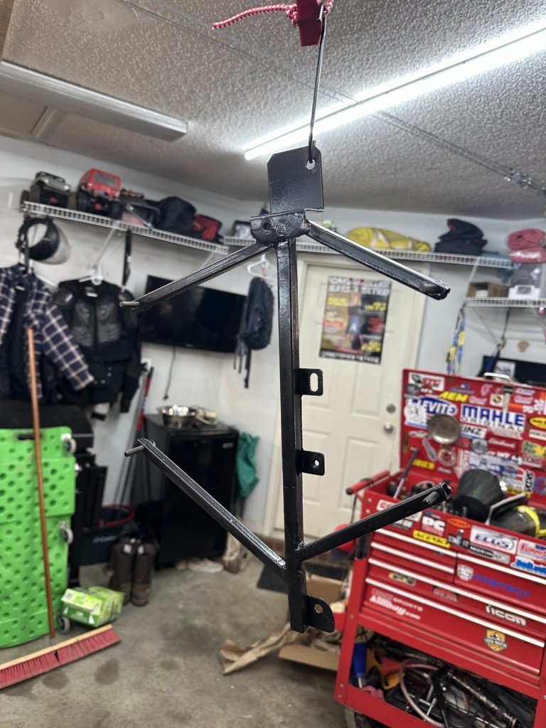

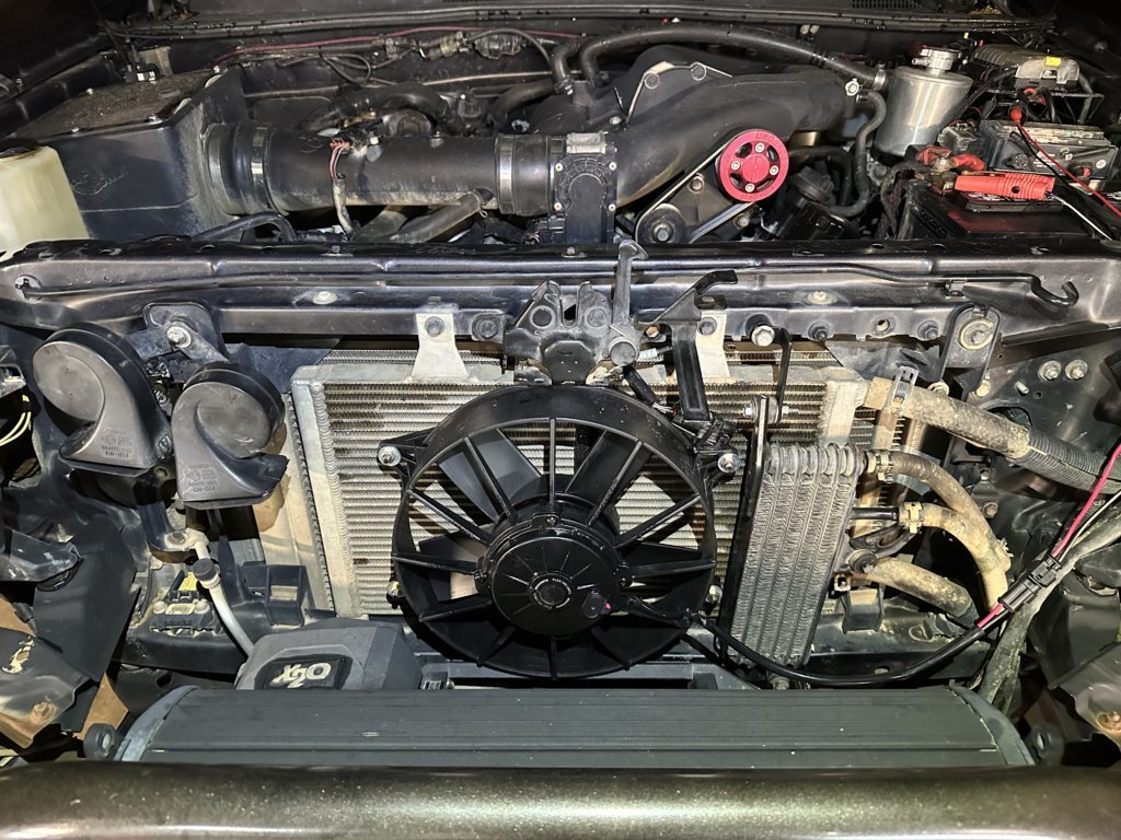

    Went with the Mishimoto race line fan. Finally got it the mounting buttoned up tonight after fabbing some stuff to get everything mounted and relocated. Shifted the horns to the left, rotated the trans cooler 90 degrees and mounted it vertically after some modification to the mounting brackets. Everything is mounted real rigid so I don’t think I’ll have any issues. It def isn’t enough to replace the factory fan but I think it’ll do exactly what I’m asking of it. I’ll be wiring it to an empty port of my Trigger wireless controller for manual control.
    Anyone know if it matters which way the lines go into the trans cooler? I reversed them due to hose length but if it matters I’ll pick up some longer hose and replace it.

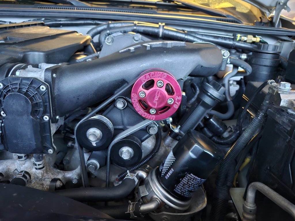

    I picked up a URD universal pulley. I see a lot of people talking about how tough it is to do the press install - possibly dumb question but would heating it up right before installation help at all? Not something I would try without confirmation, just planning my install process.

    Definitely!! Some guys put the pulley in boiling water just before install, you can put it in the oven, (even pan seared with some garlick) - J.K
    Also people use cans of nail polish dry spray kinda like dry ice on the pulley shaft to freeze it up to shrink it. If your doing a pulley hub they go on pretty easy.

    In my situation it was extremely easy to press on. Definitely needed a press, but took little pressure. Did not preheat.
