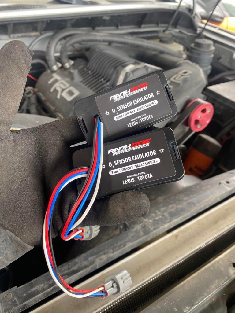

    I need some help.
    Anything above 30% throttle I am getting a surging issue and losing power. My wideband is dropping to 10.0 AFR. Way too rich . I’ve tried plugs, replacing the headgaskets, timing chains.
    Bought a new MAF and TB today but the livestream showed they were functioning ok.
    this happened after my upgrades. To a 2.7 pulley and headers it could be a coincidence.
    Truck is fine is if I baby the throttle and I can keep 5lbs of boost in the 11 AFR range .
    Mods.
    TRD Flash
    TRD injectors
    URD 2.7 pulley
    AEM 340lph pump (tried swapped 255 and did same)
    TRD injectors
    Afe intake
    Doug Thorley headers
    Secondary O2 deletes
    any idea on what this could be ?

    How was this done? I wonder if this could be causing issues on the TRD tune. It might want to see those

    Same as the URD units .
    A company in Europe is making them

    Okay so the sensors are still there, but you’ve got o2 simulators. Cool, I didn’t realize there was a company in Europe making them.
    i would start by unplugging those and see if there are any changes. The only codes you should get from not having them is p0420 and p0430, but there should be no drivability issues. Could be that they are making the ecu unhappy

    ill try it . Its worth a shot and its free.
    I want to see if anyone is running a 2.7 pulley and headers and having the same issue on a TRD ecu flash /injectors . Part of me is wondering the lack of Cats is too much for the ecu. I also burn up my primary O2s once a year since these mods .

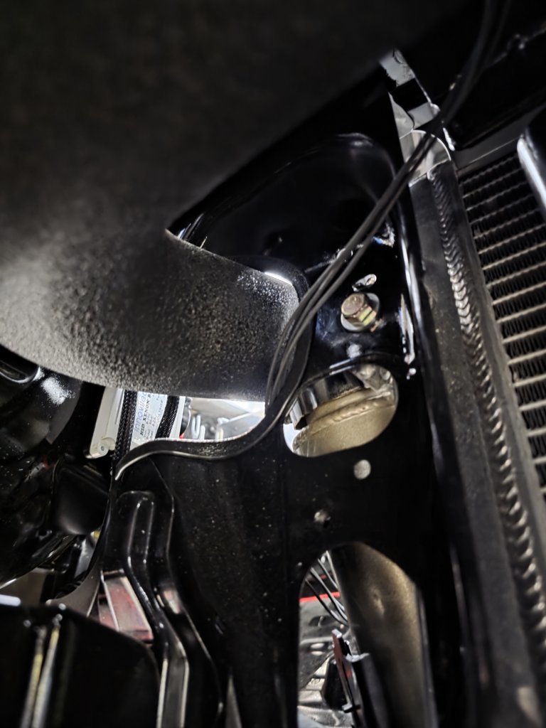

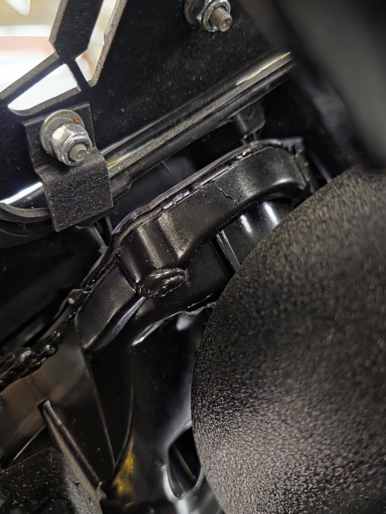

    It doesn't seem much if at all actually. I do have the 3-4 sections that I cut off of the main pipe to tb. That may have alleviated some fitment issues.
    The headlight vent guard at the bottom had to be trimmed. I went at it with some angled shears but do plan on cleaning it up. The anticipation of taking 2 whole days to install an intake was killing me lol
    I do recall trimming the upper area even more after these pictures and cleaning up the maf wiring. I decided that under hard wot some clearance up top would be beneficial.
    I am considering and have already planned to gusset and redo some sections of the core support as it flexes way too much and I already have the heat exchanger contacting the front support ever so slightly.. sigh
