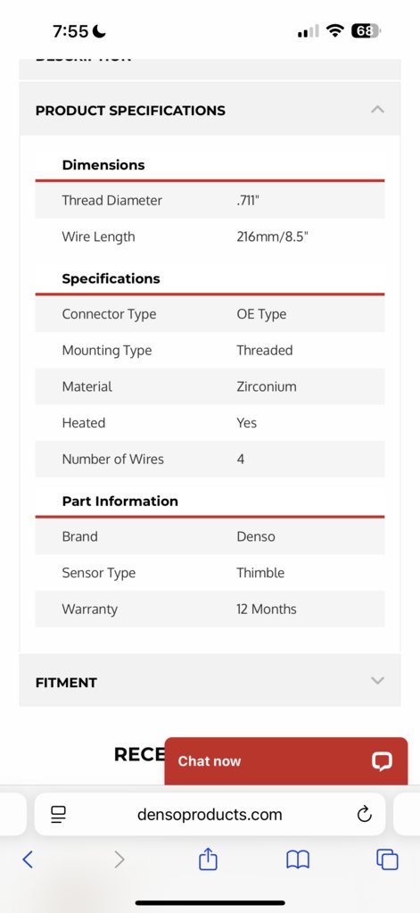

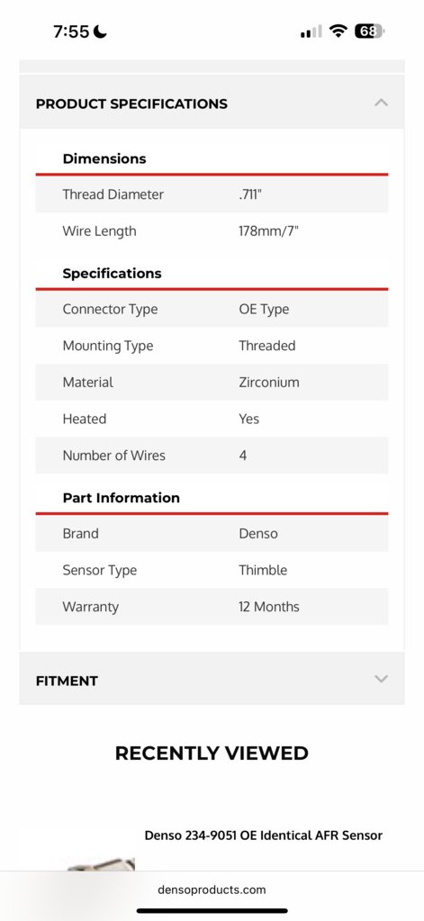

    SAS INW
  12. May 8, 2025 at 4:53 PM
    TegoTaco
    TegoTaco Well-Known Member
    Sep 29, 2016
    #198555
    7,354
    Ontario, Canada
    ‘13 SUPERCHARGED DCLB TRD SPORT
    I’m going to guess, it’s the length of the wire.
    Norton and Operator8[QUOTED] like this.
