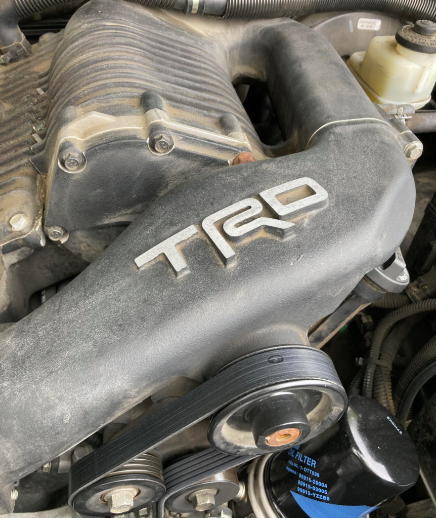

    Im also curious although my adventure with the pulley press tool has taken some wild turns today. I'm not a fan, and I only have the pulley pressed on halfway. Not sure what I can do to finish the job, threads on the small stud things are not surviving the fight.
    Editing to add - I'm not going to do it yet but man I really wanna just use my deadblow hammer to finish it out. Only have about maybe 3/8" left to press it on. I mean. "Press". Also not doing that unless I get an agreement that it's a good idea, I don't want to beat up the inside of the charger. But it does feel like that shaft has zero play in and out, extremely tight.

    Current status is, checked the inner threads on the SC pulley shaft with a spare bolt that had the proper sizing - coincidentally, the bolt that held the old stock intake on I believe. Those threads - good. Threads internal on the install tool - smoked. Not sure where to go from here. I could use a long bolt with some washers, but that puts the strain on those inner threads on the pulley shaft and that's probably a bad idea. I wish there was something for a press tool to grab onto that wasn't just a bunch of threads!
    More edit - found a spare stud, most likely something removed during the SC install - it worked. Pulley is on. Now I just need to solve my coolant problem, no I will not explain that just yet. Too annoyed about it.
    But also THIS is a thing. The electric pump for the SC coolant just kind of... goes on every once in a awhile. Runs for maybe 60 seconds, then turns itself off. Bad relay? No keys in ignition, truck just sitting there cold. So bizarre.

  10. May 13, 2025 at 6:37 AM
    Sterling_vH111
    Sterling_vH111 Go do something real instead.
    Oct 4, 2015
    #165793
    3,035
    Sterling
    socal
    2012 DCLB Prerunner V6
    Secretly Long Travel & Supercharged
    If you have it hooked up per the magnuson instructions, it will do that.
    The fuel pump relay or whatever it’s hooked to periodically runs to test itself and the fuel tank for pressure / leaks.
    You now just hear the s/c pump lol because it’s louder than the emissions pump near the fuel tank
    EricT[QUOTED] and herecomesace like this.

    Lots of quiet to hear the pump yesterday. And the leak. I nicked my radiator dropping that press tool, it backed off and I hadnt realized it. Pulley is on and good now, I could fix that pinhole leak but, its a 15 year old radiator. I wasn't planning on it but I suppose it's time for the csf. I was going to do it at some point. Gives me a chance to replace the remaining collant hoses anyways, oil/throttle body etc.

  12. May 13, 2025 at 7:30 AM
    JasonLee
    JasonLee Hello? I'm a truck.
    May 9, 2014
    #129454
    12,350
    Jason
    Q322+3C Denver, Colorado
    15 TRD OffRoad
    TRD Supercharger and more.
    you can wire it up better to not do this on 2012-2015 trucks with the SAIS…

    I don't mind it if it's got a purpose. If it is going to wear that pump out faster though, I may just wire it differently.

    The pump should be fine for a long time. If you never drive the truck may want to connect a battery tender but I don't see the pumps going out a ton (not saying it wont but not a common issues)

    I ended up just rewiring it to an ACC ON fuse so it turns on only when the truck is turned on. Maybe it's just me, but I encountered a couple other issues with the tie-in per magnuson's instructions. I think it's tied into the EFI fuse? I can't remember, but I removed that tap and applied a better one on a different fuse.

    Yes it’s on the EFI fuse. I recommend expanding my quoted post. All the info is in there…
