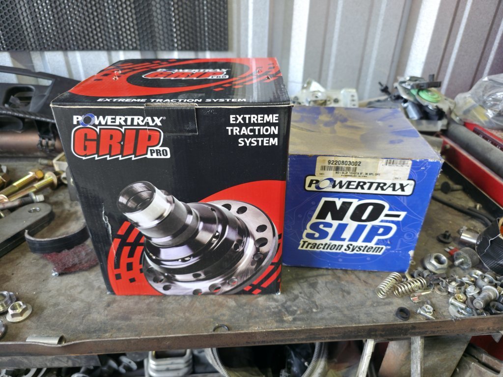

    You interested in selling that locker?
    What type/brand is it?

    Any particular reason why you chose Powertrax over TruTrac?

    Powetrax noslip. Sure pm me.
    Just newer component with potential ease of install just like my existing no slip and just familiarity of the brand. My no slip is pretty aggressive on loading and unloading due to the nature of my setup.

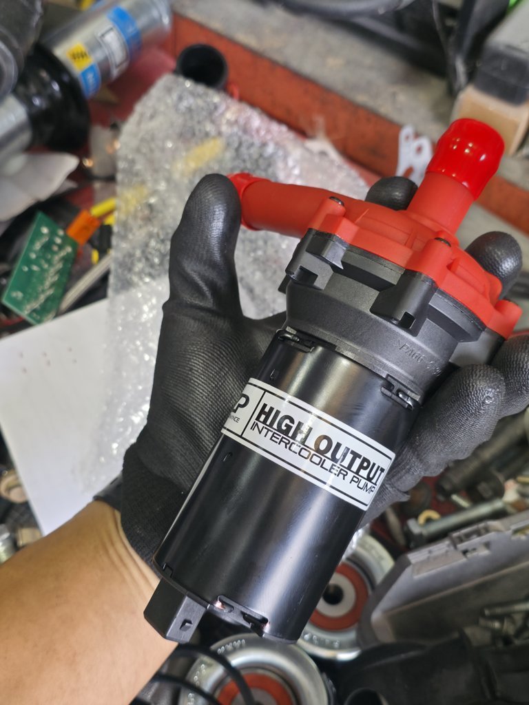

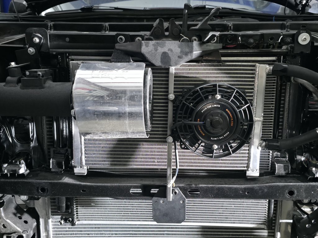

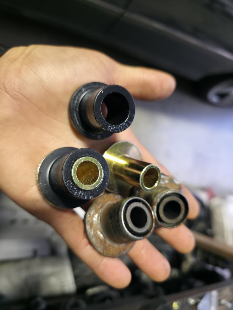

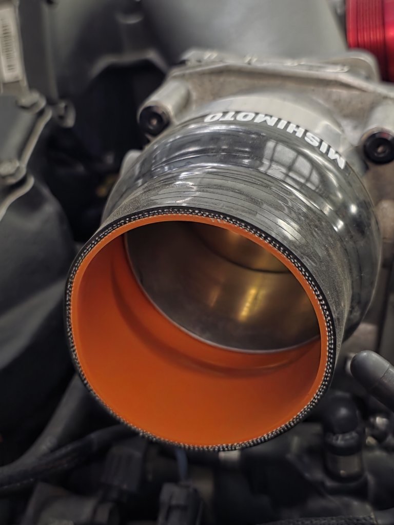

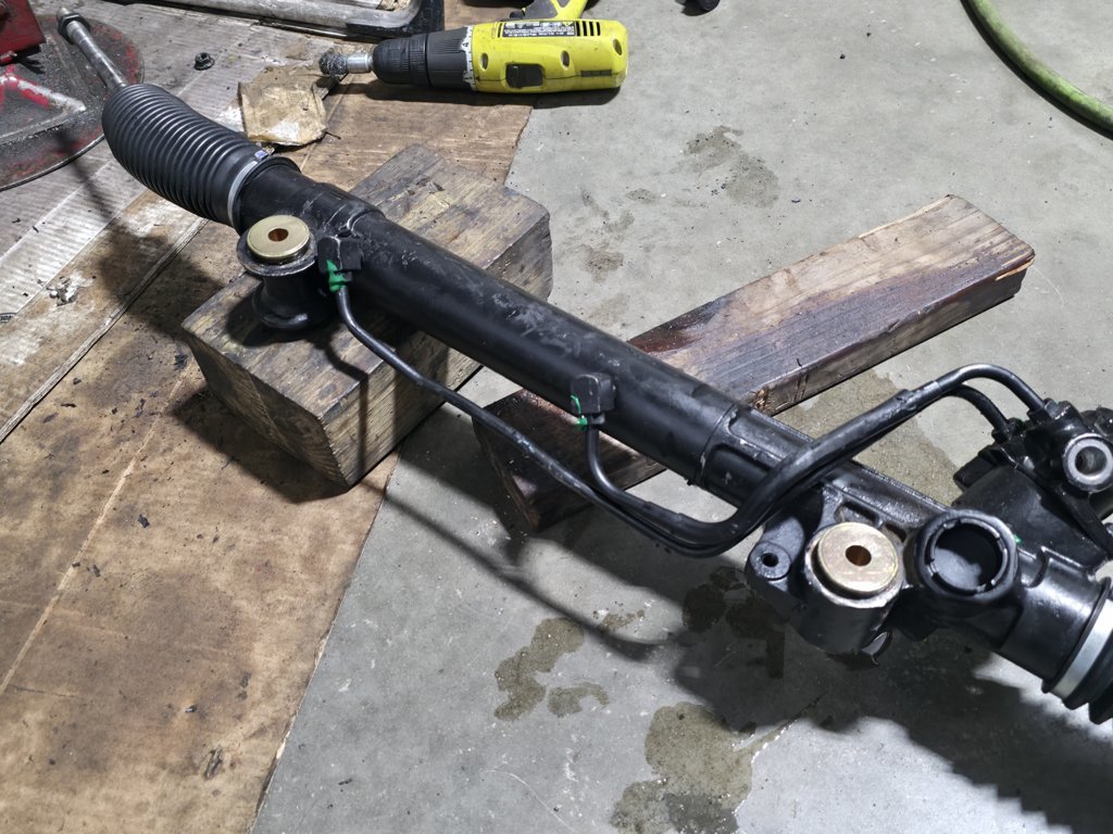

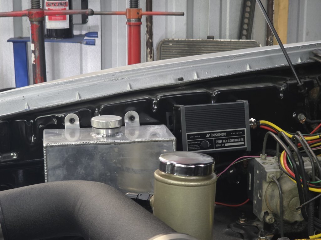

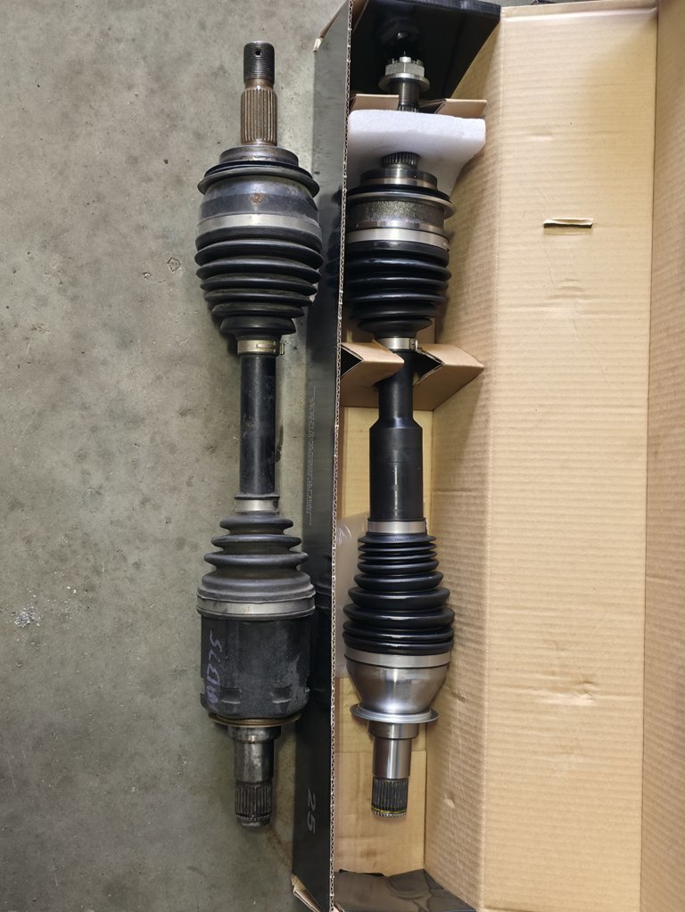

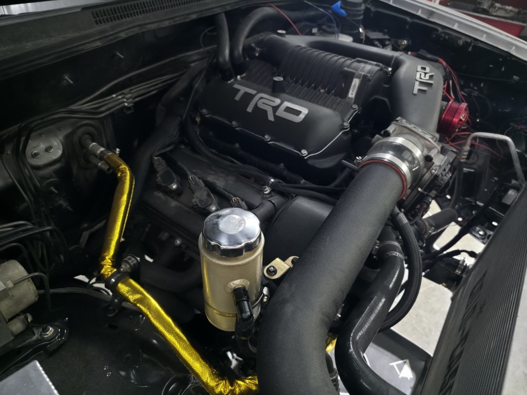

    I did the flex a lite fan conversion when I installed my cold case radiator a few years ago.. recently just integrated a higher quality pwm fan controller..
    The oem fan shroud integrated coolant overflow was hideous and cumbersome. Installed a bpf cooling plate as well awhile back..
    Newest addition to combat the 100*÷ weather lately. I find it pretty crazy to see IATs of 110*+ on a cold vehicle. Worst IAT lately was 165* from a bad air intake duct on a e63 AMG. Was easier to diagnose that, at least.
    Plan on adding the aux fan to the existing flex a lite circuit and run by the mishimoto controller.
    Also have some front crossmember shenanigans I need to finalize and weld up to re I nfoce the fan and protect the heat exchanger from the urd intake a bit better.
    Also got a pair of these high articulation axles to test out..
    Zzp high output pump..
    Relocated ps reservoir and decided to just go full AN on the ps system.
    Also got a new steering rack and did poly bushings while swapping.
    Been busy lol also rebuily my entire upper end lower oil pan and front differential with poly bushings.. for another time. Can barely keep up with work and this thing.
    Last pic is of ported tb and sc inlet ported to match. Varies around 90-100mm. Tuning got pretty spicy with injector duty cycles screaming. Fun stuff
