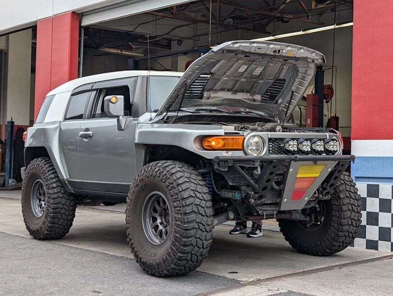

    Thats a very impressive rig. But down to a 2.0 pulley? Oh man you went for it, that's amazing!

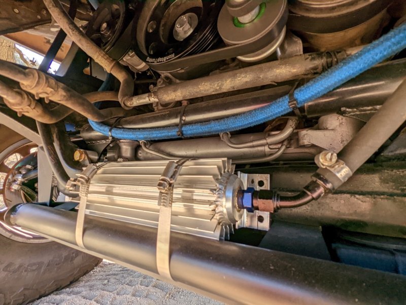

    Fuel pump install itself going well - pulling the gas tank out wasn't as bad as I thought it would be, ran it down to 1/8 tank before the job. But man getting some of those hose lines unplugged yeeeeesh. What a pain.
    On the stock pump, it looks like the fuel filter sack thing also had some carbon in it, the new one is just an empty mesh sack. Either that or it caught a lot of mess over the years. That's gotta be carbon.

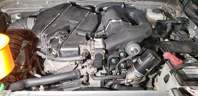

    Just spoke to Gadget at URD, he seems to think that it’s a misfire, suggested I replace the spark plugs…plugs are brand new…it was a brand new S/C kit. Haven’t gotten around to replacing the fuel pump/filter yet but so far it hasn’t done the hiccuping since last week. It idles perfectly fine, under normal driving conditions it drives perfectly fine. No noises, nothing usual. No check engine lights or pending codes.
    edit***
    Was told to check with a scanner for any misfire counts and all is good…0 count.
    herecomesace[QUOTED] likes this.

    Just finished this job up.
    Some long 90degree needle nose pliers go a long way. Highly recommend.
    I did my job on the ground, used a hydraulic pump cart I have for holding and lowering the tank down/going back up. That was nice to lower it slowly and disconnect things before they ran out of slack so nothing was strained.
    And I did pick up a tool from my oriellies to pull that ring off. 16 years of being closed it was pretty sticky, I tried a strap wrench and a few other methods but nothing worked. The fuel pump ring puller tool did a great job, for $20. Well worth it and I needed that for sure. Nothing else worked.
    The round nosed long pipe plier would have been nice. But I don't have any. My harbor break special 90 degree needles definitely put in work.
    Tank was harder to remove than reinstall but that's just because it was my first time.

    In a way, I was getting a similar symptom. When my engine was cold and warming up, I'd get noticeable hesitations when accelerating. At the time, I had also recently installed my SC, brand new, from Magnuson.
    For me, it turned out to be my plugs. They were all covered in black soot. After replacing, my issues went away.
    My suspected cause was installing a new intake without tuning for it. Once my new plugs went in, a new tune was flashed and never had the problem since.
    Anyway, just thought I'd share.
