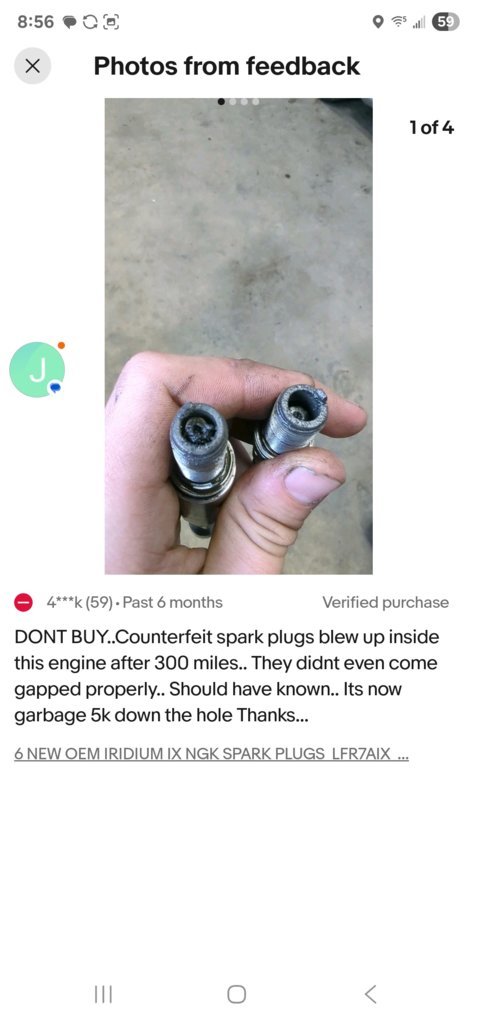

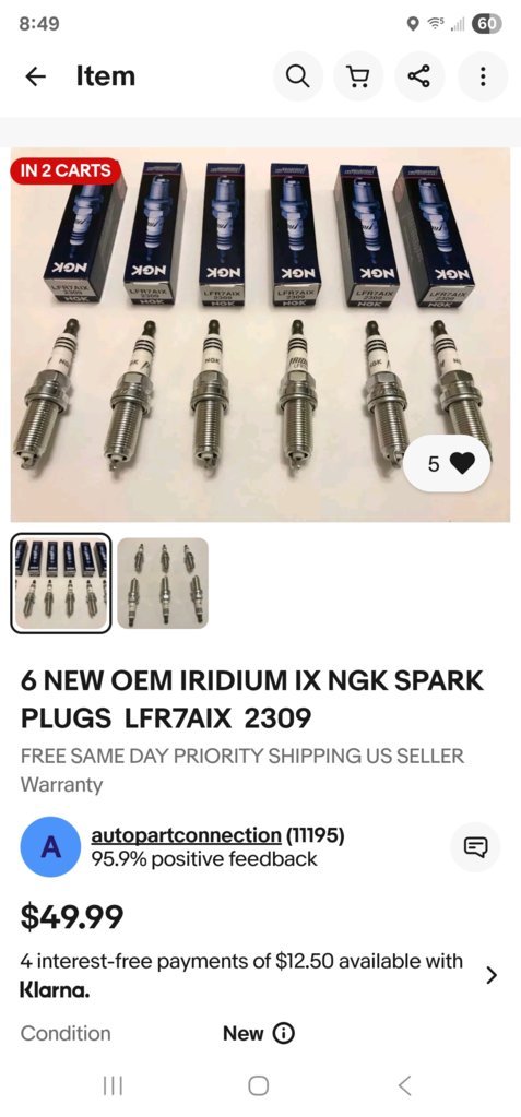

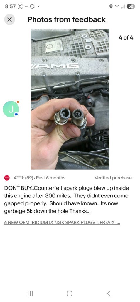

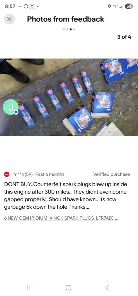

  16. Jun 1, 2025 at 5:58 AM
    BlueT@com@4×4
    BlueT@com@4×4 Well-Known Member
    Dec 30, 2020
    #351081
    258
    2015 TRD PRO Tacoma
    You definitely right, I should buy from certified reseller. I just never think spark plugs counterfeit reach American land... I thought that available only at third country .
    Btw buy these from ebay and I just read the feedback from three buyer who's buy it from him.
    1 said is counterfeit spark plugs with the picture melting spark plugs.
    Screenshot_20250601_084919_eBay.jpg Screenshot_20250601_085648_eBay.jpg Screenshot_20250601_085718_eBay.jpg Screenshot_20250601_085724_eBay.jpg
