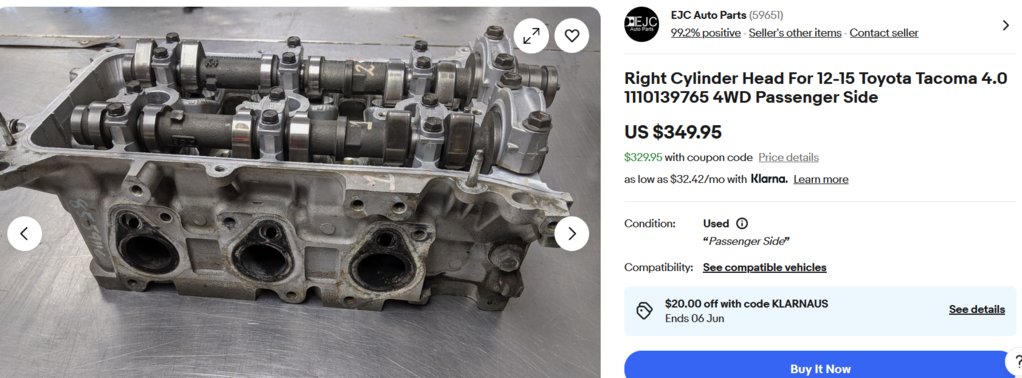

    Any pics of the same side to rule out just a difference between the driver and passenger side?

    yeah one of those is the intake manifold side and the other is the exhaust side.

    I didn't even notice that, ha. Stupid descriptions both said "right"

    Just get the OEM Toyota gaskets.

    Yes you are correct. This has been done! I can’t remember who did.

    I put the 2015 engine in my 09 truck. Everything lines up. Difference is the 2nd air inject exhaust. Use the old header/manifold and use gasket for 2012+.
