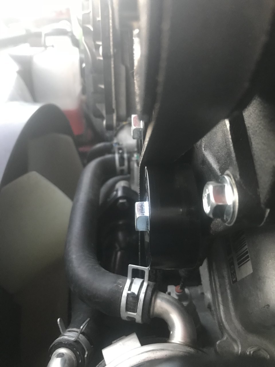

    Hey guys just pressed on my qwikchange pulley until it was flush and bottomed out the urd press tool. Does it look okay even though part of the belt is slightly off of the pulley right below the s/c pulley?

    Im ready to go test drive it but want to make sure everything is kosher

    I would hold off for now, there was some discussion about this previously and how it can be finicky. I'm sure someone who was involved in that will respond shortly.

    Should have been pressed a bit more using a washer. I think the quick change pulley thread addresses the issue with it not lining up 100%.

    I would guess it's designed to line up. Maybe some techniques to push it on more.

    Buy an 1/8 washer that will fit over the shaft and press the pulley on that much further.

    Thanks for the replies gents. Went back through the qwikchange pulley thread and found a post by @12TRDTacoma that mentioned he took the idler off and added a 1/8" washer behind it. I did that, and now it lines up great. Took the truck for a drive, and it also solved my fuel issues from it hesitating and studdering when going from zero throttle to WOT. Gadget had mentioned the truck was just running too rich since my ucon was tuned for the 2.8, but the 3.0 was on there. Truck no longer does the herky jerky, just takes off. Couldnt be happier:D

    Sorry for the late replies guys. I had a very busy day. I am glad to see you managed to get it all resolved and up and running to get it going fast.
