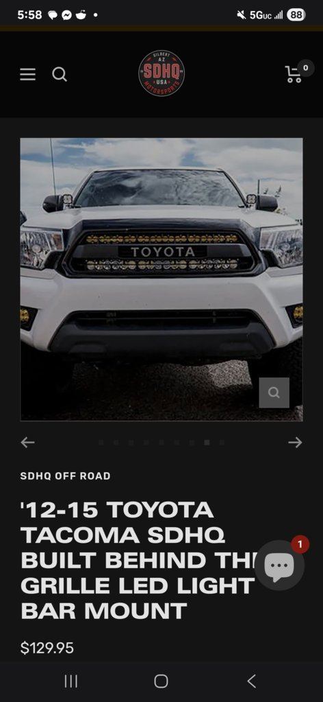

    Posting here as it pertains to SC folk. Anyone running an SDHQ behind the grille mount for light bars? This is only for the 2.5 gen. Not sure if it'll fit with the excess lines and intercooler. Screenshot_20250910_175817_Samsung Internet.jpg

    I am, it’s a bit of a tight fit, with the coolant lines, but I have run the cooler and pump and other things in stock location.
    I did have to cut/bend a bit of the core support sheet metal on the inner ring around the headlight however.
    I kind of just made it work in the spots that already had the widest gap.
