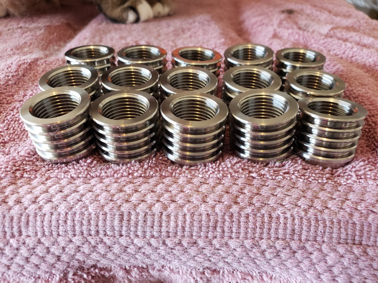

    I really dont know which sensor is good or bad. I am building some y-pipes for people here using the same finned bungs I installed on my truck and never have had a problem. I have an Innovate gauge setup and in the instructions it even states you must use a longer bung if exhaust temps are above a certain point. To play it safe I am installing these in every o2 position so none of my peeps have to worry.
    Quality is never cheap!

    Nice to see you are putting your talent to a good use for these guys that want these y-pipes. :thumbsup: I know they have been after you for a while now for you to fab them up for them....

    Those bungs are just ridiculously trick. Reminds me of the early eighties factory Honda works bikes.
