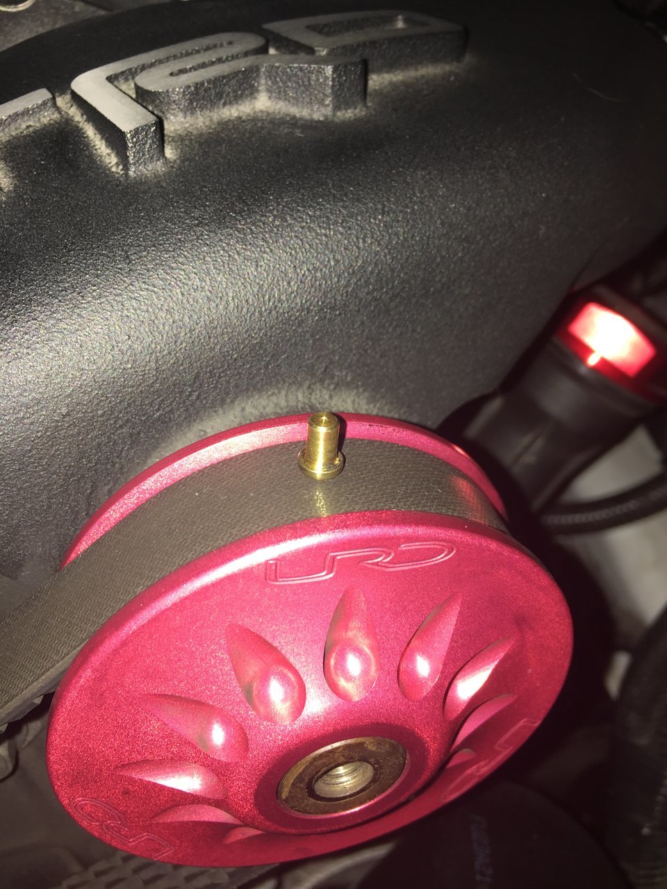

    It's not just you. It's that fucking o ring that is the bane of my existence. I had to remove the plastic cap and attempt to reseal it like 3 times. It kept leaking out fluid because it would shrink while I was attempting to put it on.
    Finally I put silicone paste on it to make it tacky and it stuck just enough to where I could put the ring on without having to worry about it. No problems after.
    Edit: the seal doesn't leak fluid. It leaks out gas. Apologies on my scatterbrain. Lol.

    Finally.....Finally.....Finally!!!!!!....... I hope this was worth it, I won’t know until the drive tomorrow into the firehouse....wd40, is a must. Sprayed just a tad after I loosened it and was able to pull it up just a smidge. Sprayed it in then twisted....
    Edit....I also chewed up my hands in the process, scrapes and cuts that will hopefully heal with a smile on my face.
