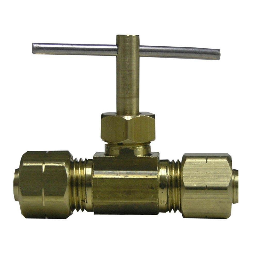

    I'll take your word for it. I think if anything I would remove the jet completely and install an adjustable valve in the middle of the line. It would be much easier to access and you could adjust it at will.
  12. Jul 8, 2018 at 12:31 AM

    Actually. That is a GREAT idea! It wouldn't take much either. Like literally. You could probably just install a small butterfly valve (I'm thinking of a very crude design here) and open or close the valve as much as you want when you want. Got any ideas in mind for a better design?

    A small needle valve would be good due to the control of small adjustments.
    Something like this with barbs on the ends.
