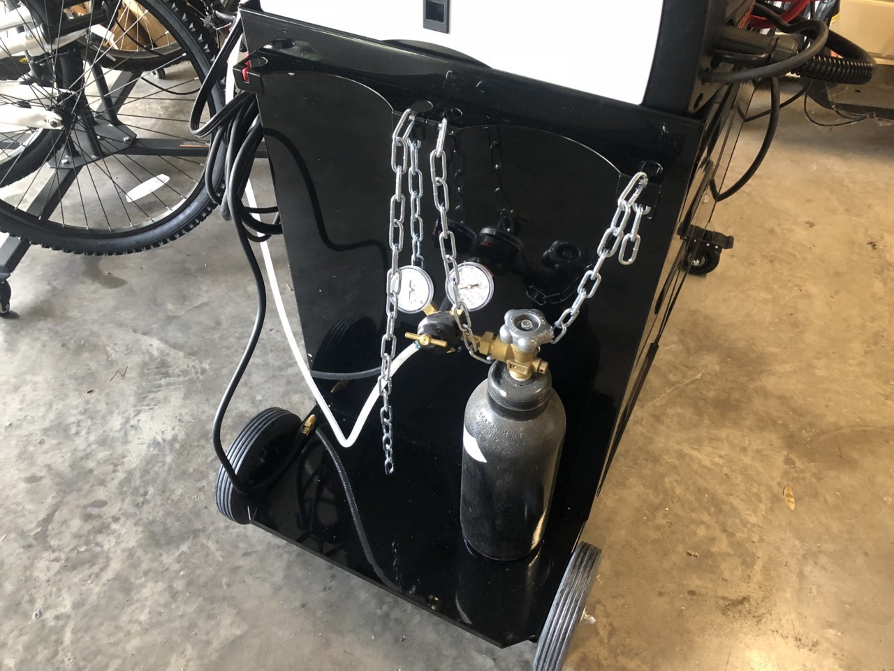

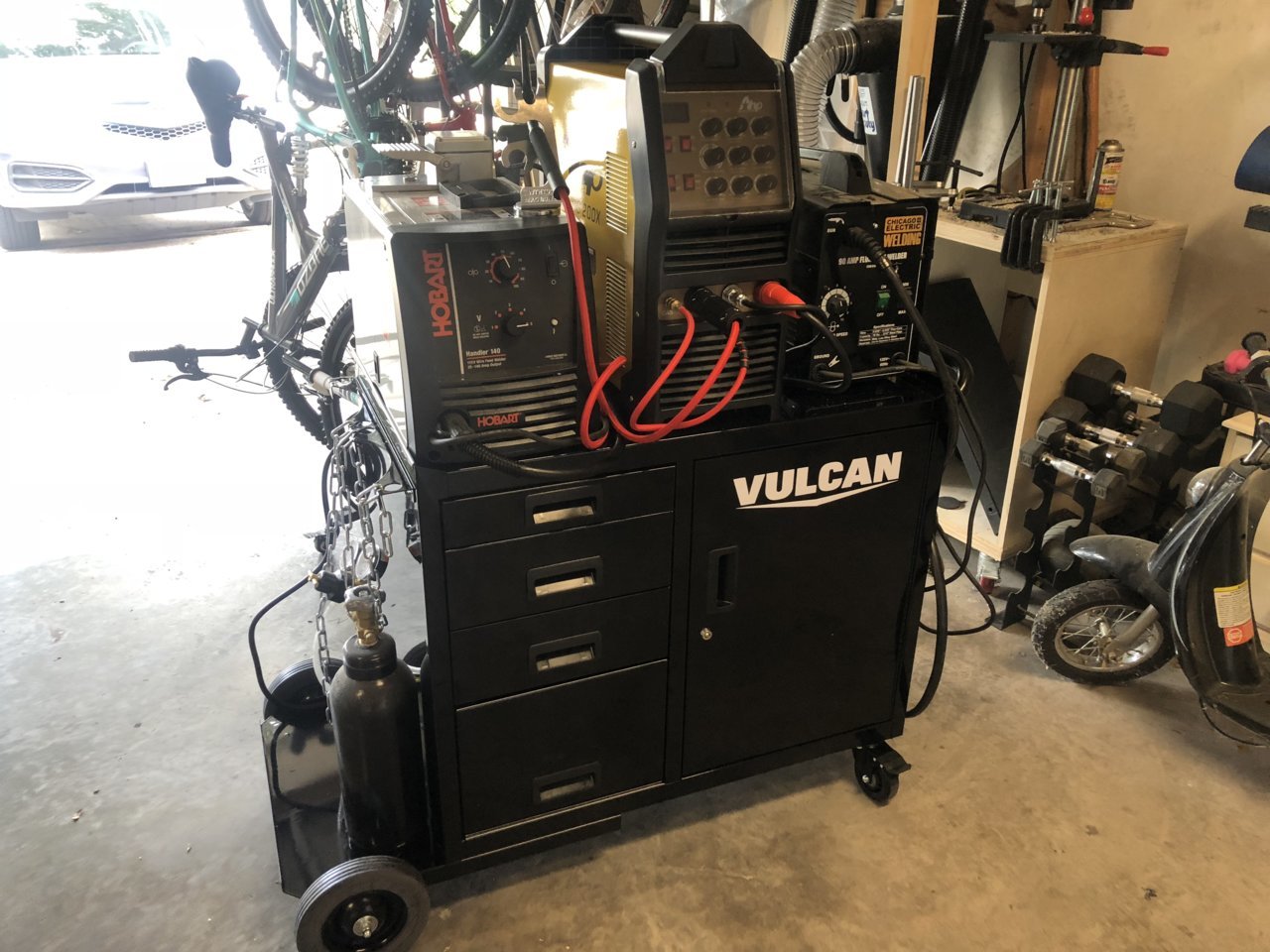

    I was going to build my own welding cabinet, but I cheated and got the Vulcan one from HF. For the price it’s actually a really nice cart.
    Still need an adult sized Argon bottle before I can really play. :D
