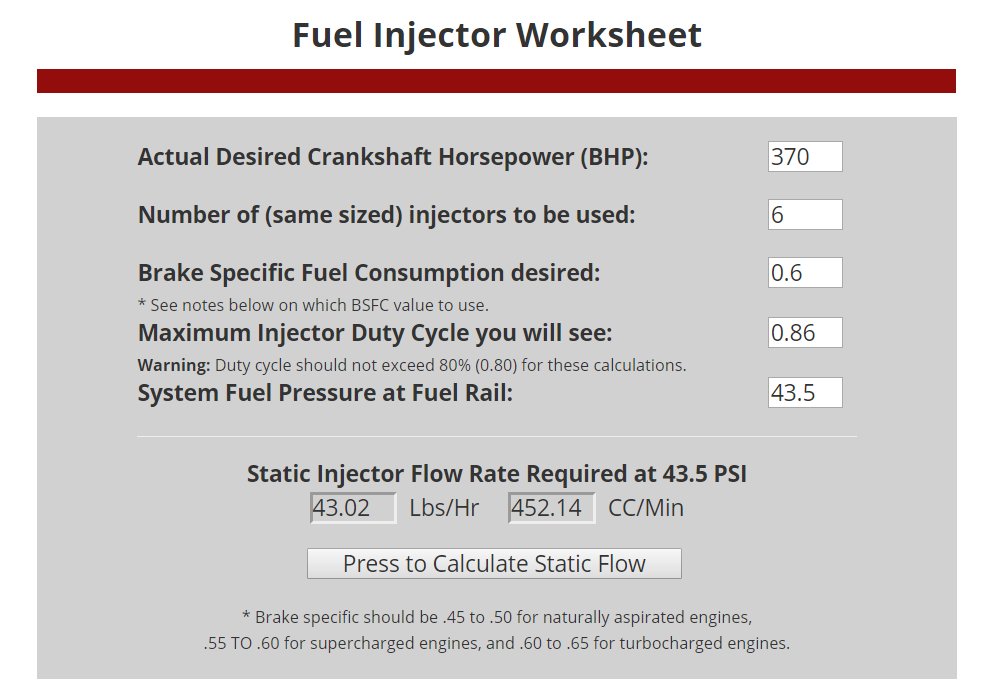

    Thanks, Torspd. So I may be closer to roughly 86% duty cycle at 455cc. I'll see what my AFRs do with the FPR mod

    I think for some reason the x-1 was calibrated or set at 425cc for some reason and that's where the confusion comes in to some of the veterans. :D

    Burned the wrong #into my brain. Ugh.

    And yes, to reclarify..
    455cc on factory TRD 4.0 1GR-FE Supercharger injectors. NOT 425cc.
