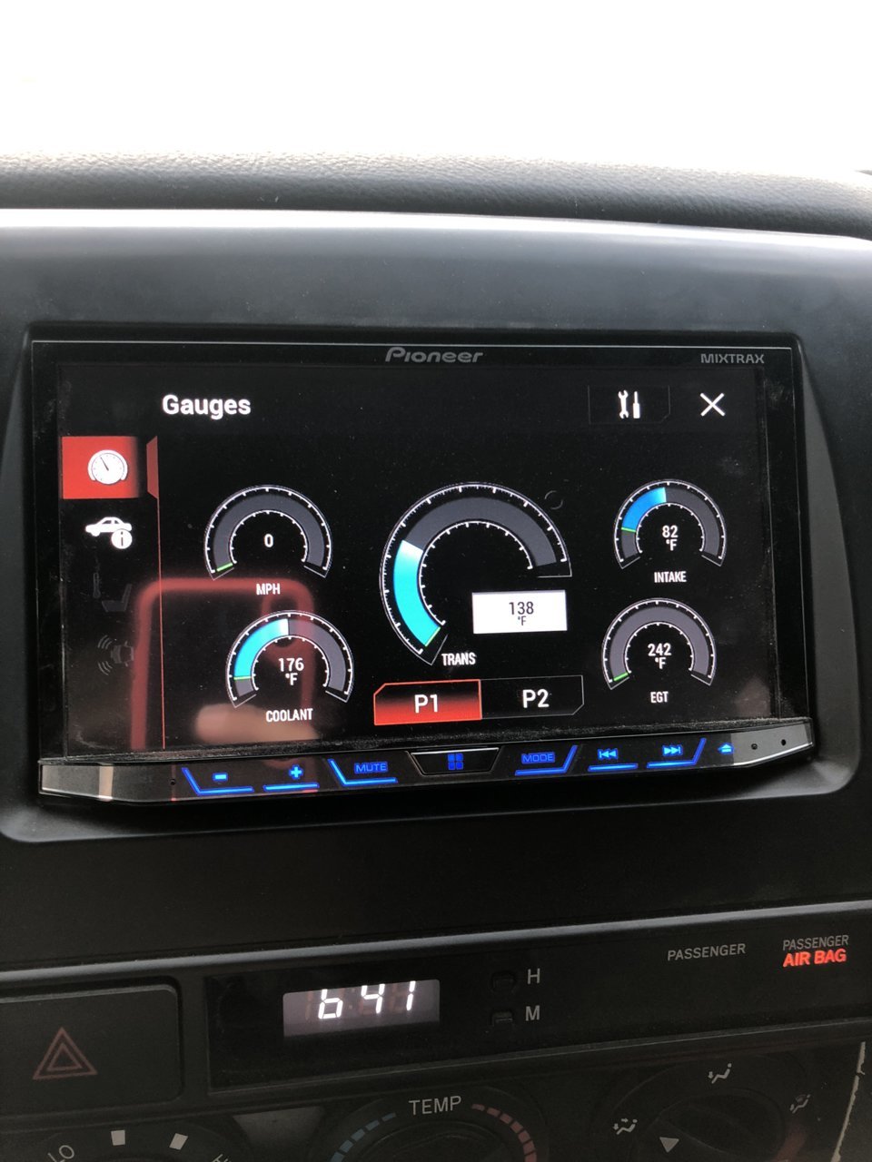

    I used an Maestro databus module, which is made to work with radios that have the iDatalink port.
    http://maestro.idatalink.com/
    Skootter14[QUOTED] and SUMOTNK like this.

    Looks like a Gen2.5 TRD Sport, but really an '08 TRD OffRoad
    TRD Supercharged / OTT Tuned
    @loginfailed
    I, too, am interested in how you did the gauge display on the headunit.
    Sorry...i see the answer above

    It's bad ass! I wish I was rich so I could afford this! You can even view and clear obd codes with it too.

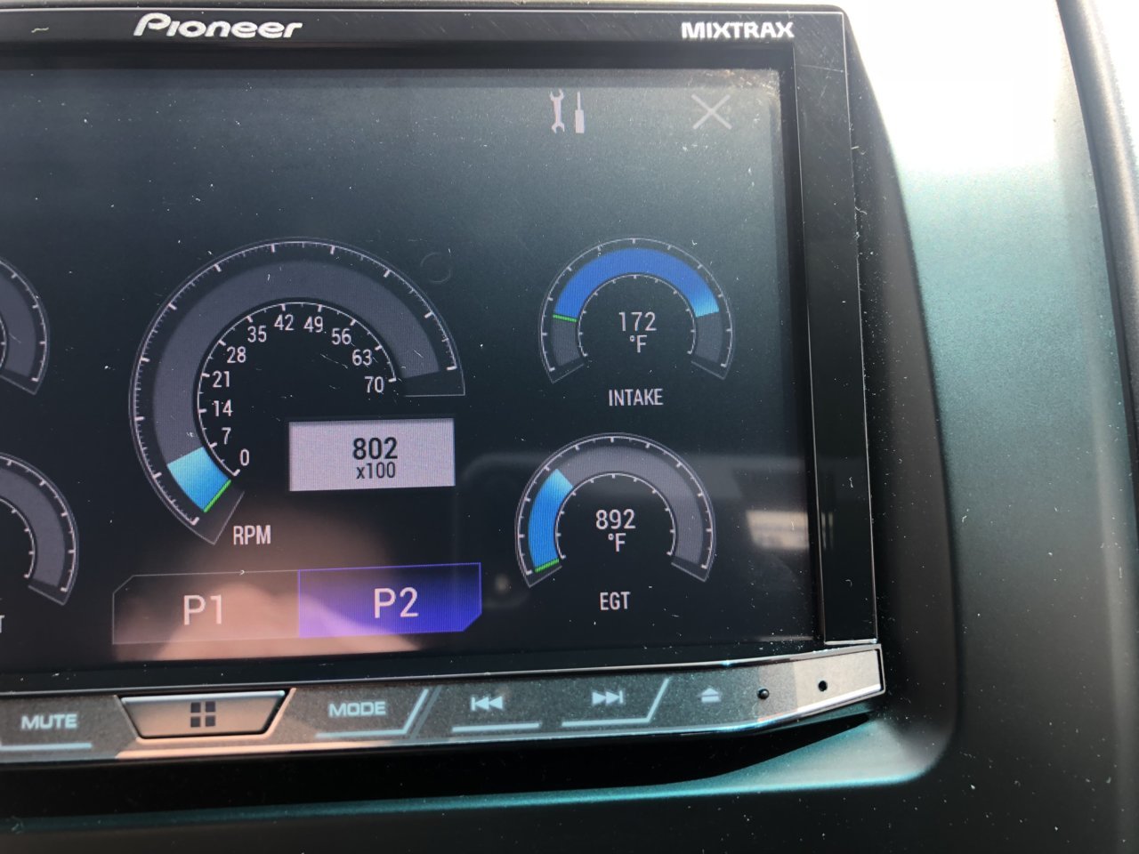

    Why is your intake so dam hot?

    Because Houston and I was idling for about 30 minutes. That temp is sampled from the MAF and it’s super hot in the engine bay.

    Gotcha. Iv'e never idled that long. My intake temp usually matches outside temp ~+-5

    Could that gauge display on the pioneer head unit be displayed on a Samsung tablet?

    The Maestro is designed to work with aftermarket radios that have an “iDatalink” interface.
    If you want something to display on a phone, you would need something like PLX Kiwi or Carista.

    Is plx, kiwi,... a connection of some kind? Or type of screen?

    Can you still play sirius/regular radio while using the gauge display?
